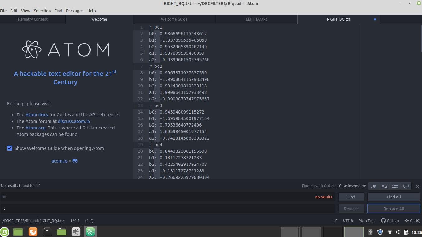

Does this mean that you have to type them in 1-by-1 by hand?
My latest EQ has 12 biquads...
PS. 4GB!
Hi...
It's pretty easy to "convert" them in ATOM
Jesper.

This error means that one of the Biquads is unstable, meaning that it might start oscillating or give some other uncontrolled output. I'll take a look at your coefficients, the check might be too picky. Are generated by REW?
This is exactly what I was going to suggest. Any decent editor has some kind of multi-cursor that makes this kind of thing quick and easy.
Are these normal peaking filters? You could then also specify them with frequency, gain and Q and let CamillaDSP calculate the Biquads coefficients.

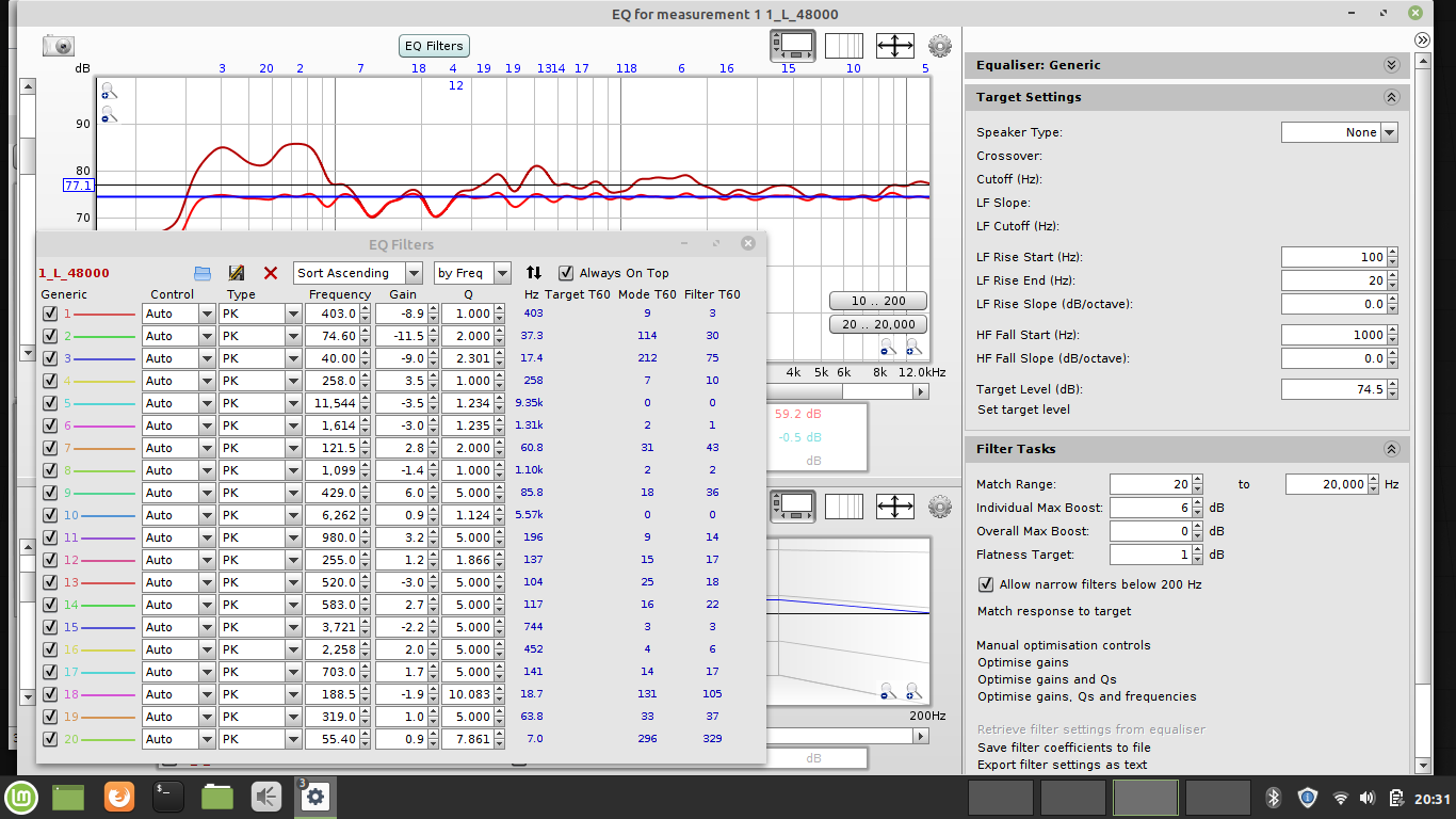

They are generated in REW.
Left & Right mid speakers - recorded at 48000
Then IR window is removed and 1/6 octave smooting added.
After that i created Generec EQ with a flat target.
This generates my BiQuad's for the Pre filtering.
Then i save the filter as .txt at 44100 for a start (i'am pretty sure i can save in all samplerates here for future use :))

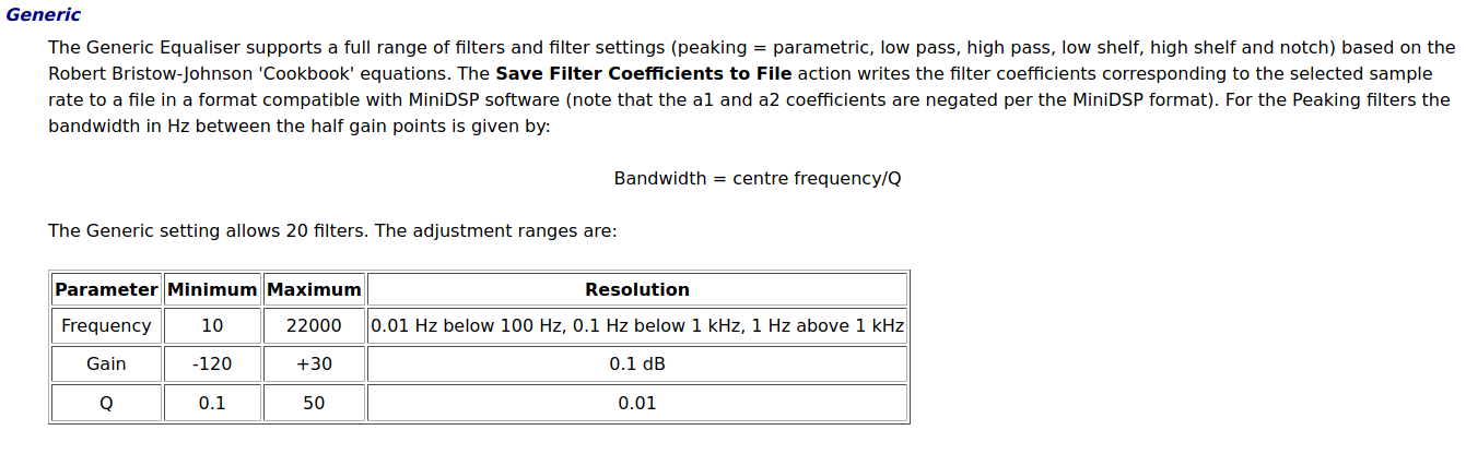

Just remembered something! MiniDSP has the sign of the a-coefficients inverted from most other definitions. Try flipping the sign of a1 and a2!

I generated with the Generic EQ, witch also flips for minidsp i see.

Filters are running fine, when rewersing/flipping the negated a1 & a2

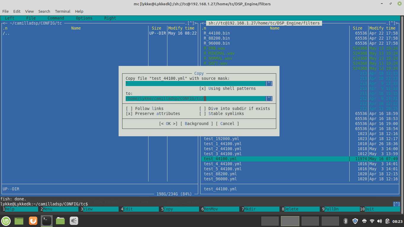

Btw.: Henrik, you are hardcore coder so you proberly allready now... but i use midnight commander to transfer files to and from my PI's
Nope, didn't know mc supports sftp! That can be quite useful, thanks!
