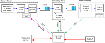

Eventhrough i dont use it (yet?) i missed the understanding of where the resampler was in the chain.

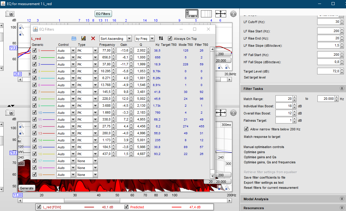

I have created some BiQuad (PK) Pre-correction.
For a start i used the REW generated one's. And took a remeasure at 44100; they do a great job and it's working as expected. I have to save the REW generated one's at all the samplerates 44100 ... 192000, and manually convert them and copy/paste into .yml at all samplerates etc... Doable but time consuming.
If i export the REW BiQuads they are no longer samplerate dependant so i assume that camilladsp will calculate the BiQuads given at the .yml files samplerate ??? This would make my life so much easier.
Is this correct ?

Yes if you use "Peaking" filters with freq, q, and gain then CamillaDSP will calculate the biquad coefficients for the current samplerate. I would say that you should only use the "Free" type if you need an unusual filter that CamillaDSP can't calculate the cofficients for.Nice chart.

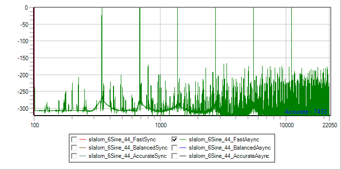

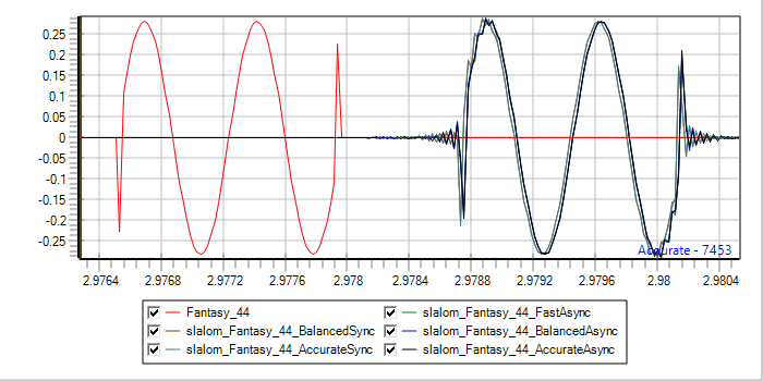

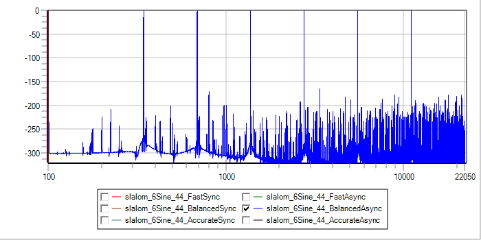

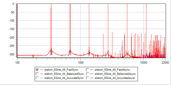

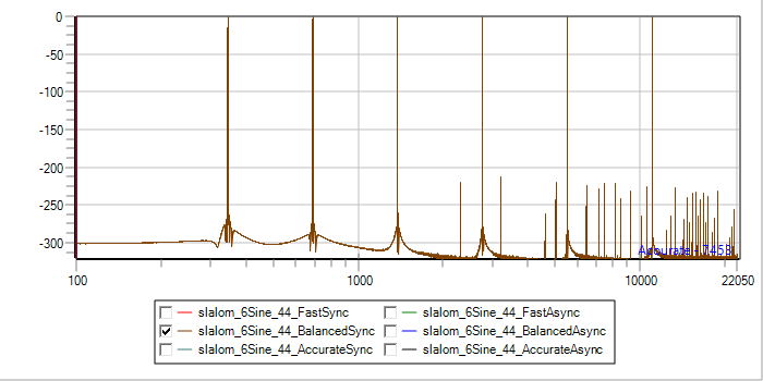

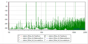

Some benchmarking ...
I set up a pipeline with a "rollercoaster type" SRC parcours from 44.1kHz to 44.1kHz. This pipe is completely useless in terms of audio listening, but not so useless to cumulatively collect possible garbage emerging from it's 6 different stages of SCR:
File Input by Camilladsp | SRC 44.1->192 | 192->48 | 48->176.4 | 176.4->96 | 96->88.2 | 88.2->44.1 | File output by Camilladsp
So a total of eight instances of camilladsp, six of them configured as SRC's. The pipe was run in all different quality presets such as FastSync, FastAsync, BalancedSync, BalancedAsync, AccurateSync and AccurateAsync.
The input signal was a Float64-Bit file, containing six sinewaves, equispaced by one octave along with frequencies such as to produce minimal artefacts while windowing the result @44.1kHz (to avoid swamping the results of the SRC into the artefacts of the windowing itself) The outcoming files were windowed with a Kaiser240 window.
FastSync - All artefacts are <165dB:
FastAsync: - All artefacts are <165dB

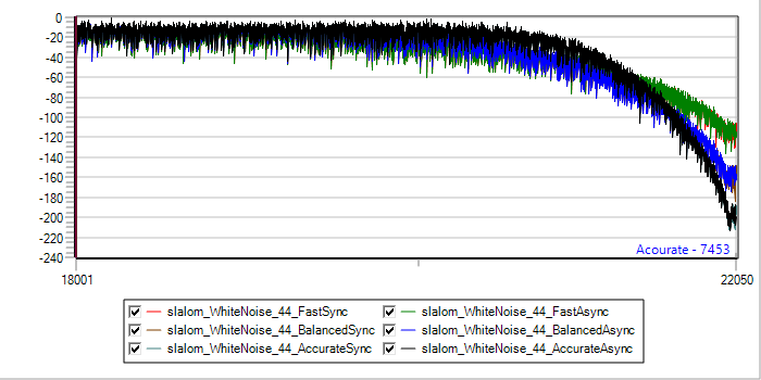

BalancedSync: - All artefacts are <210dB. In terms of artefacts level and artefacts density this one may become my favourite for static SRC's:
BalancedAsync: - All artefacts are <165dB

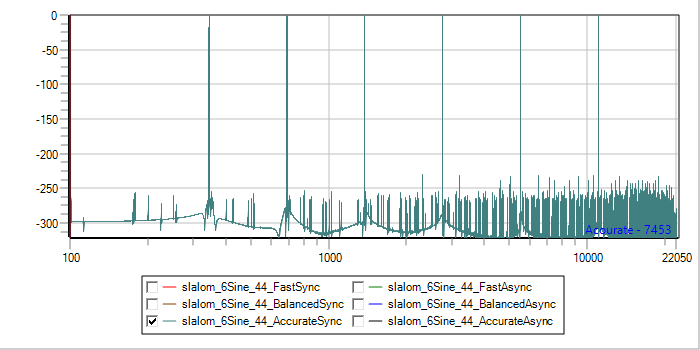

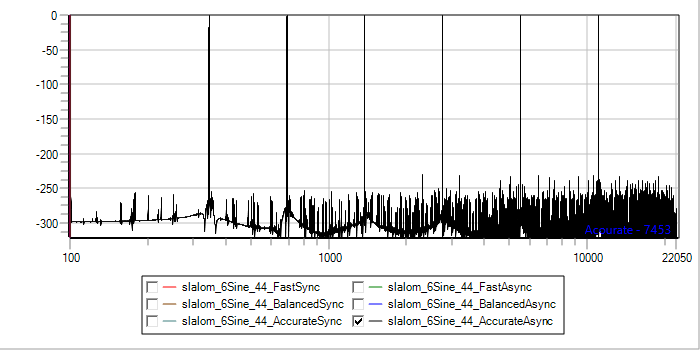

AccurateSync: - All artefacts are <230dB
AccurateAsync: - All artefacts are <230dB
Another difference between Fast, Balanced and Accurate is also the behavior of theirs filters. All filters provide decent attenuations at 22050Hz, thus well avoiding violation of the sampling (Nyquist-Shannon) theorem. Best performer is Accurate, then Balanced, then Fast, "as intended by the inventor" 🙂. The input file contained Float64bit white noise, this time:
Then -what happens visually to my synthesized "torture impulse"? Despite the demanding, cascaded transformations it remains more or less well shaped - better than I had expected:

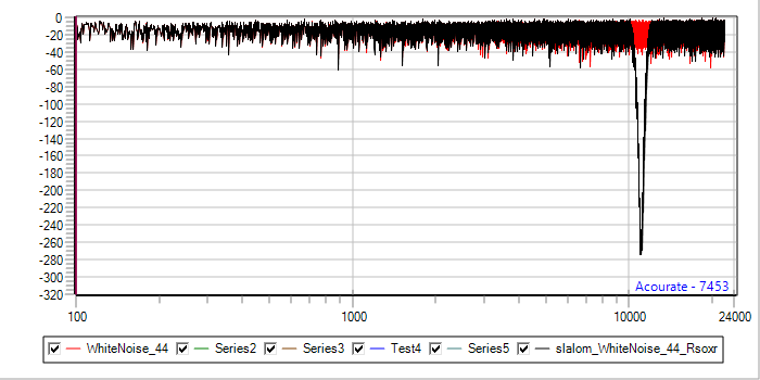

And last, not least - I wanted to benchmark against the soxr library. Forget it / no use. Resample-soxr had to vomit riding this roller-coaster. Maybe it's a bug in it's stomach (e.g. within the soxr library) provoking this kind of annoyance:

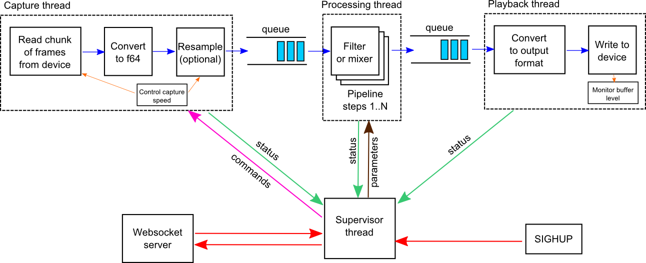

Goodmorning here 🙂 (at least where i am)
I am trying with some success and failure to get his flow running.
My .yml (flow)file goes like this :
Camilla is calculating BiQuads (working as expected)
Fir's applied
Gaincontrol applied
Is it possibel to run two instances of camilladsp insted of using BiQuads and fir's in the same one?
If this is possible i could much easier control what i am trying to do.
The BiQuads are used as "prefilter", but using "real" fir's chained would be easier for me.
I think you could chain multiple instances together by running them through a chain of alsa loopback devices. I'm not entirely clear on how this would make things easier though, could you elaborate?
I've been daydreaming about a web user interface for camillaDSP- I haven't had time to start writing anything yet though but it's good to understand different use-cases to see how they are (or aren't) catered for in a user interface.
Chris

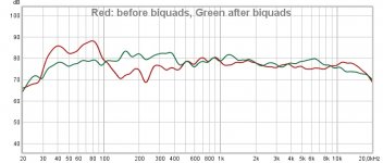

hochopeper, let me try to explain what my issues are.
If you look at the attached file from my previous post you can see that making camilladsp use BiQuads as Pre-filter is kindoff a bit complicated.
If i could chain two instances instead i could use normal fir's as Pre-filter instead of BiQuads!
But when i think about it i see that it could also be complicated duo to timing etc. The camilladsp i'am running is using the camilladsp rate-adjust for this.
But if both if possible camilla's could use this maybee it would work without problems?
So while i am at it i have some other quistions,
When using fir's i sometimes have difficulties using .wav's (L & R seperated); using the same filters as .bin (L & R seperated) seems to run better?
Problem here is that the only program i have which generate .bin fir's are rePhase, but i would also like to try the DRC-FIR & DRC-Designer, which i think only can generate .wav's. -But maybe i can convert them? i don't know yet.

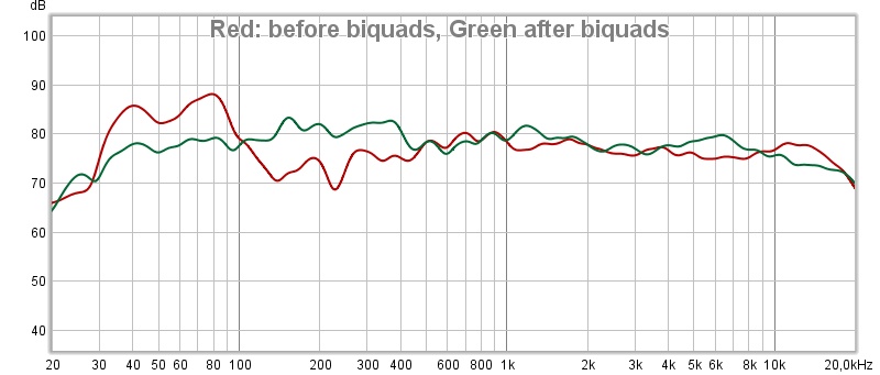

The attached picture is my measurements at the sweetspot before and after BiQuads are added to camilladsp (Pre-filter)
With the BiQuad corrected measurements my plan is to generate the fir's. Reason for this is that the fir's are less heavy and easier for it to correct, when it's pre-filtered, ok?
Jesper.
