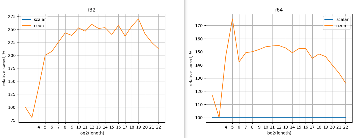

Here is the effect of enabling neon in RustFFT for the M1:

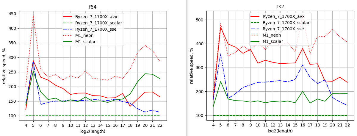

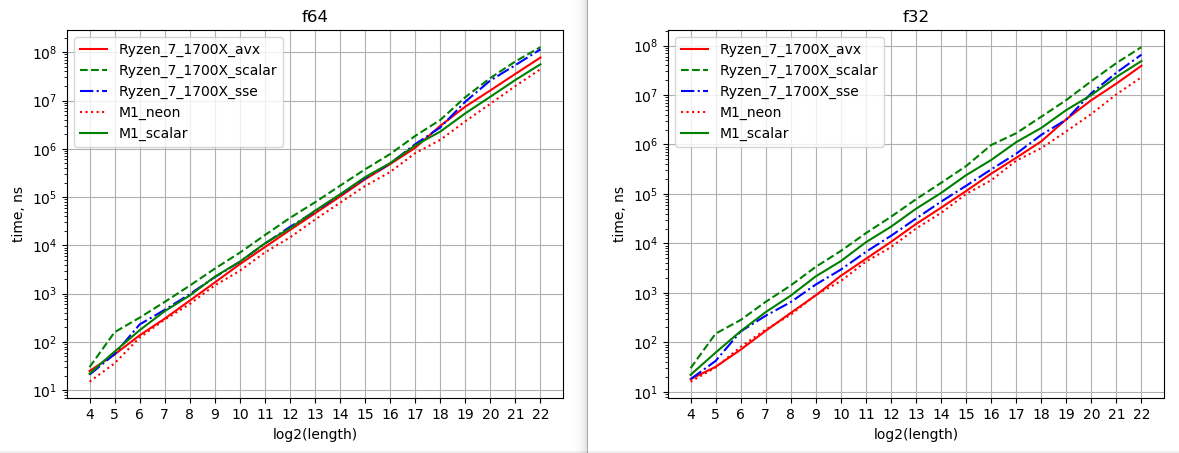

The M1 compared to my first generation Ryzen CPU.
First the time in nanoseconds (lower is better):
Then the speed relative to the scalar algorithm on the Ryzen (higher is better):
I don't have a newer amd or intel cpu to test on, but the latest ones should be maybe 50% faster than my old Ryzen. That would mean that one of those and the M1 (with neon) are pretty even in speed.
