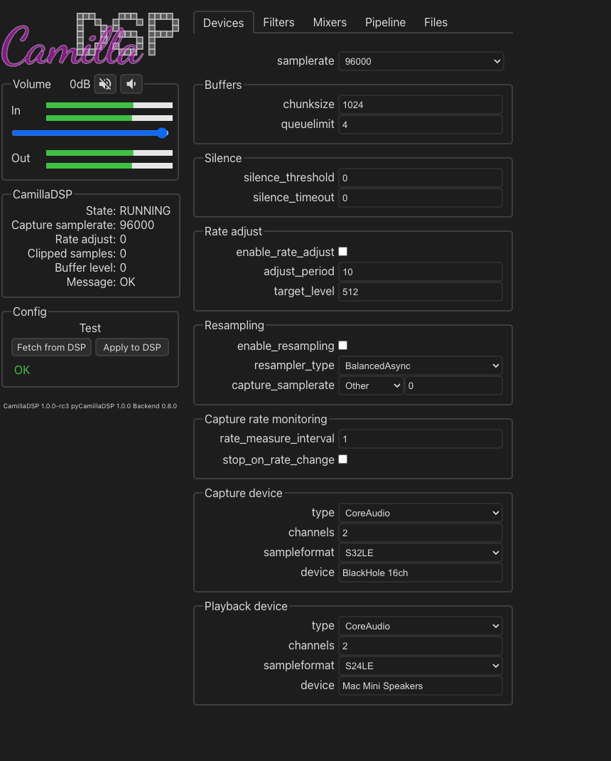

Trying to get camilla gui working on mac mini m1..
I am able to start camilla via command line..when i try to start gui getting following error
from camilladsp import CamillaConnection
ModuleNotFoundError: No module named 'camilladsp'

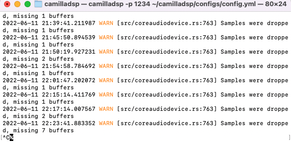

You have a small mismatch between the capture and playback sample clocks. Since they are independent they will never be exactly the same. Try enabling resampling and rate adjust.
I'm working on adding a pitch control to Blackhole. Once that is done you won't need the resampling any more. Just need more free time..

I enabled rate adjust. Changed target level to 4096.You have a small mismatch between the capture and playback sample clocks. Since they are independent they will never be exactly the same. Try enabling resampling and rate adjust.
Chunksize to 4096 with queue limit 8..
So far no errors for 24 hours +
constantly running audio through pipeline
