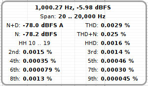

Hi all...
To see if it was working, i created some sine's with "no", "low" and "high" distortion to see what would happen.
Script is working for sure 🙂
Something to play with is allway's nice to have!
Will listning to some tune's eventually.
NO or less dist. as @HenrikEnquist had in the script default.
LOW dist.
HIGH dist.
Jesper.
def nonlinear(data):
result = data + 0.01 * data**2 - 0.01 * data**3
return result
LOW dist.
HIGH dist.
result = data + 0.2 * data**2 - 0.2 * data**3
return result
Jesper.
