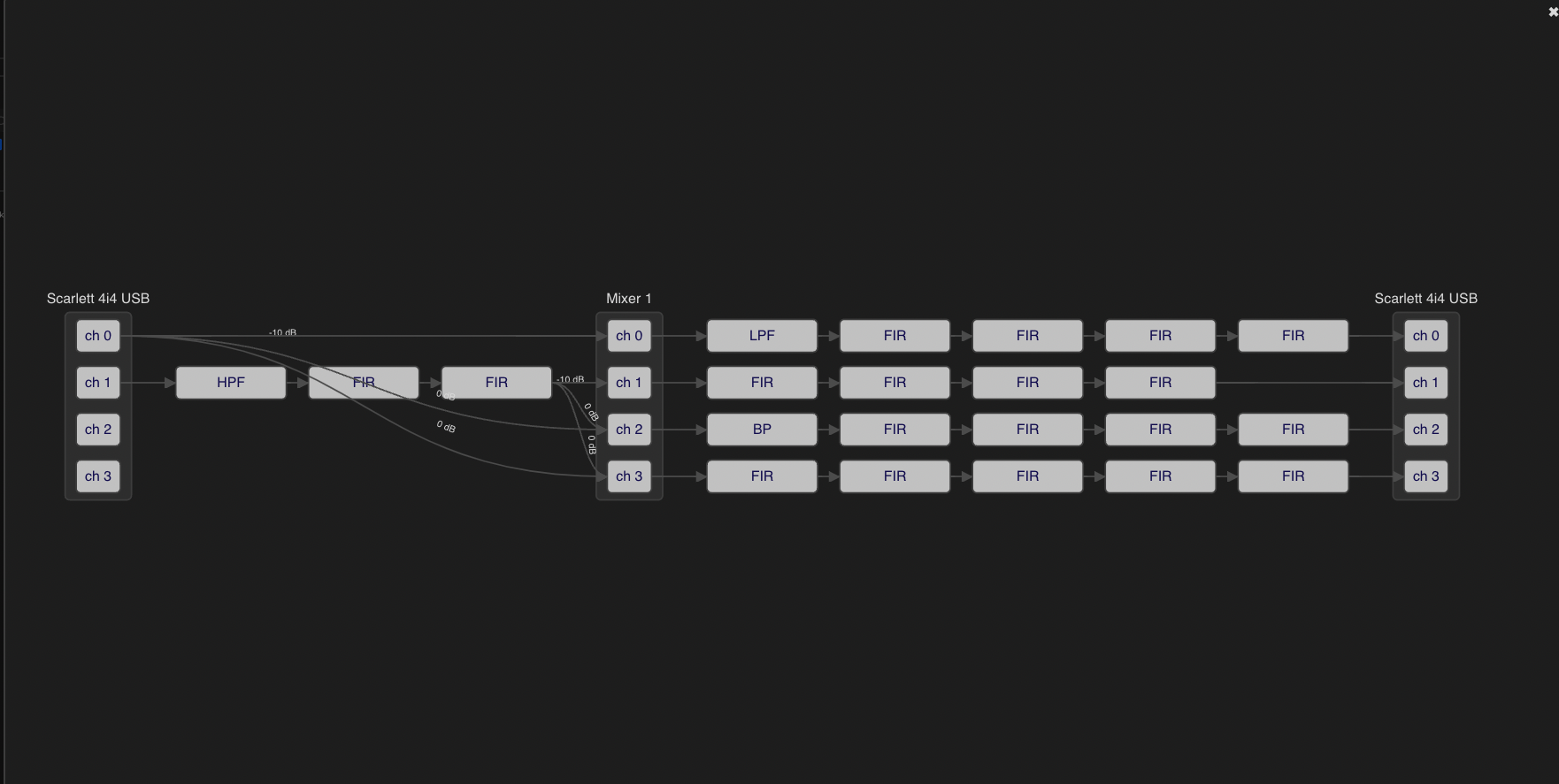

Testing with scarlet 4i4..added couple of fir in chain. Still stable.
Input and output both on same interface.But i still have re-clocking enabled.Should keep re-clocking on?

It would be weird if the inputs and outputs of the interface are not synced. Try without rate adjust and resampling!Testing with scarlet 4i4..added couple of fir in chain. Still stable.

A FIR can be one tap so the picture really don't say much - but, you will have a hard time exhausting a M1 for sure ;-)
Just trying to do stress test on mac mini m1 8gb..still only using 9% cpu
I'm a little puzzled why you would serialize FIR filters. There is no need to cascade them, you just design one FIR filter to do the same as N FIR filters in series.
Oh it’s just a test..I wanted to overload to see how much cpu would be used ..I'm a little puzzled why you would serialize FIR filters. There is no need to cascade them, you just design one FIR filter to do the same as N FIR filters in series.
I need to process 16 or more channels for real use but don’t have the interface yet
Out of interest what constitutes a tap?FIR load is "measured" in number of taps.
"Tap – A FIR “tap” is simply a coefficient/delay pair. The number of FIR taps, (often designated as “N”) is an indication of 1) the amount of memory required to implement the filter, 2) the number of calculations required, and 3) the amount of “filtering” the filter can do; in effect, more taps means more stopband attenuation, less ripple, narrower filters, etc."

I tried 16k taps..m1 processor still at 8-9%.
