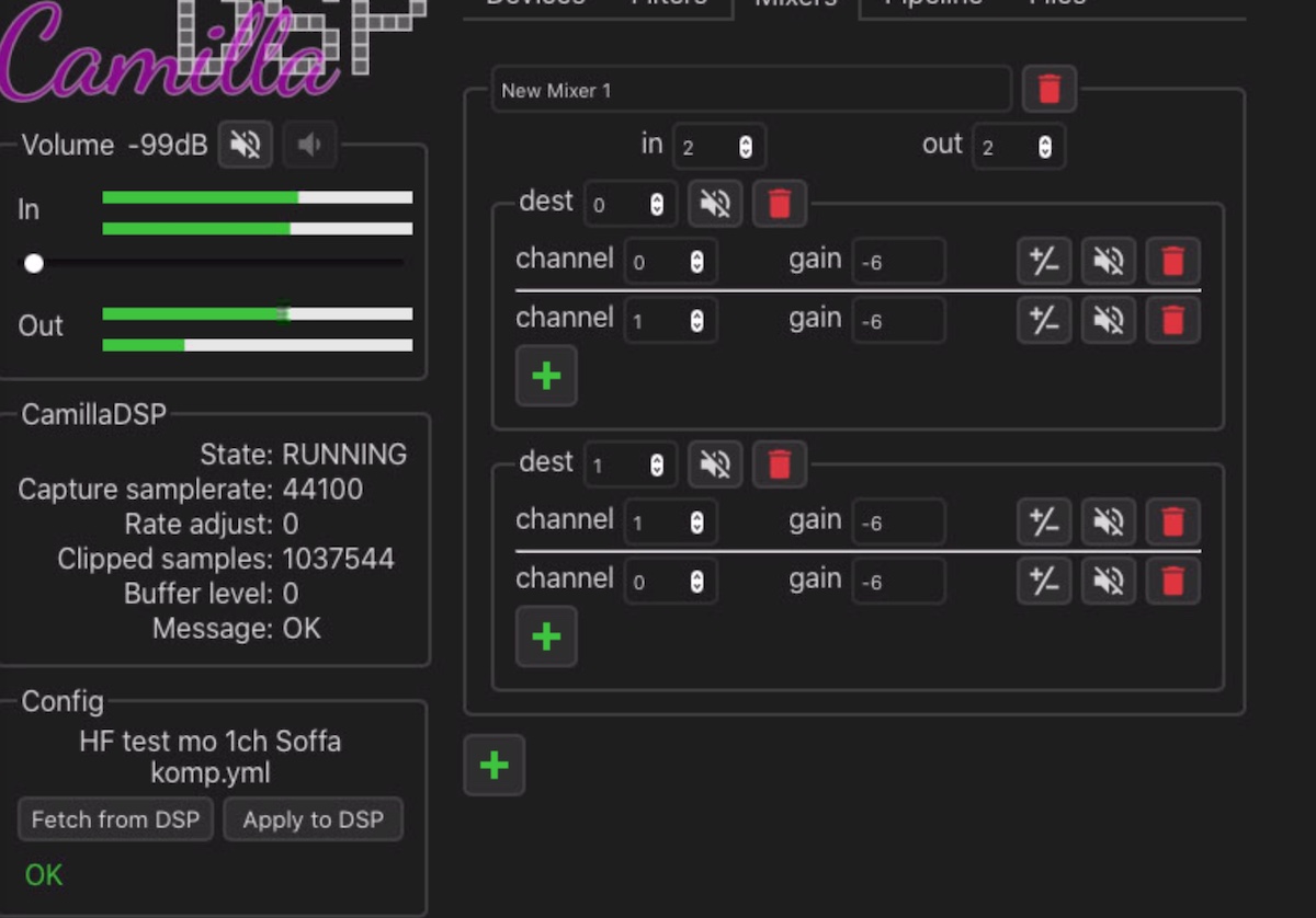

That looks correct, should work. Did you also add it to the pipeline?Another one.... Mono...
Isn't my mixer the way to turn 2ch stereo into 2 channels where both are mono and based on the stereo input channels?
I see the output level meters jump differently indicating that they are not the same?
The level meters take the values from the playback thread, just before the samples are send to the output device. They should definitely be identical, there may be a bug here.Yes, and muting destinations work from the Mixer page.
Is it really mono? Where is the info for the output level meters taken?
Could you show the pipeline tab of the gui?
Does it behave differently if you flip the order of the sources for channel 1 (it's first 1, then 0 now, try to put them the other way).
Got the files and looked through the config. The confusion is that the mixer is placed at the beginning of the pipeline. That makes the two channels identical to begin with, but then the pipeline contains quite different filters for the two channels. For example the -6dB Gain filter is only applied to channel 1.
Just move the mixer to the end!
It's not that the channels are not levelled - its that the differences between them vary, like between stereo channels... as mono, they should have a constant level relation - they don't here - thats whats so strange. I still wonder where in the pipeline the out level meters measure?
This is for development of a speaker of which I only have one individual for now. So ch1 is tweeter and ch0 is bass - 2-way speaker. I dont want L in tweeter and R for bass.... hence the differences in filters.... but I had hoped for mono into the pipe-line by mixing incoming channels x-wise...
Mixer placing in PL... how to think about that? Rules?
The level meters measure input level just after the capture device, before the data gets sent to the pipeline, and output level after the pipeline just before the data gets sent to the output device.
If you start with mono as two identical channels, and then apply very different filters to the two channels, then I would expect the levels to behave exactly as you describe. Depending on the input, they will have stronger and weaker passages at different times.
Try on simple test. Just remove all filters and keep just the mixer in the pipeline. Now the output levels for the two channels should be identical.
Where in the pipeline to place the mixer, well that depends on what you want to accomplish.
