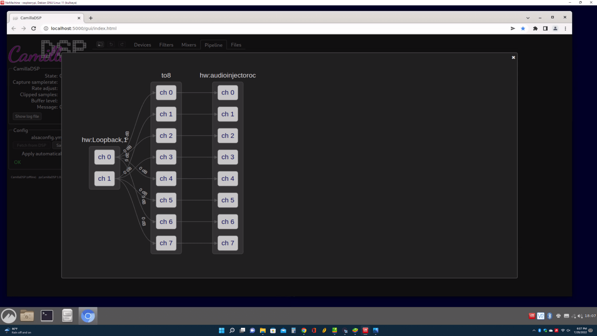

- The symbol on a filter to show it's characteristics is also present at the end of the pipeline. But here deviates the function, and instead a topology is shown.
I would think it would be very interesting to see the complete signal handling from the pipeline as a level/freq, like for a biquad.
But also the topology 🙂 two buttons required?

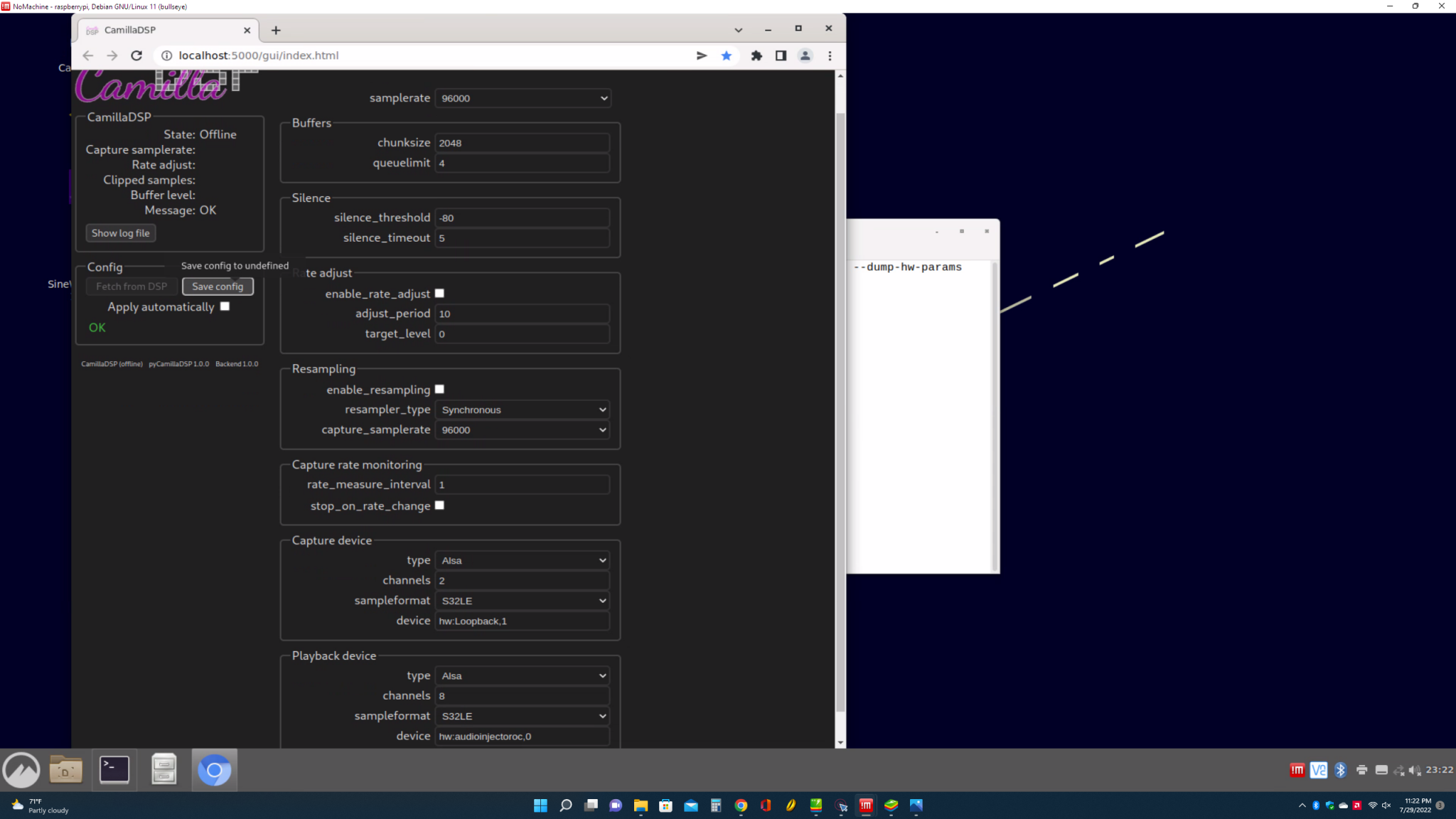

No sound now, DSP offline. Save config has undefined.
aplay -v -D /dev/zero device=audioinjectoroc says device busy
I have to stop camilladsp service to get attributes.

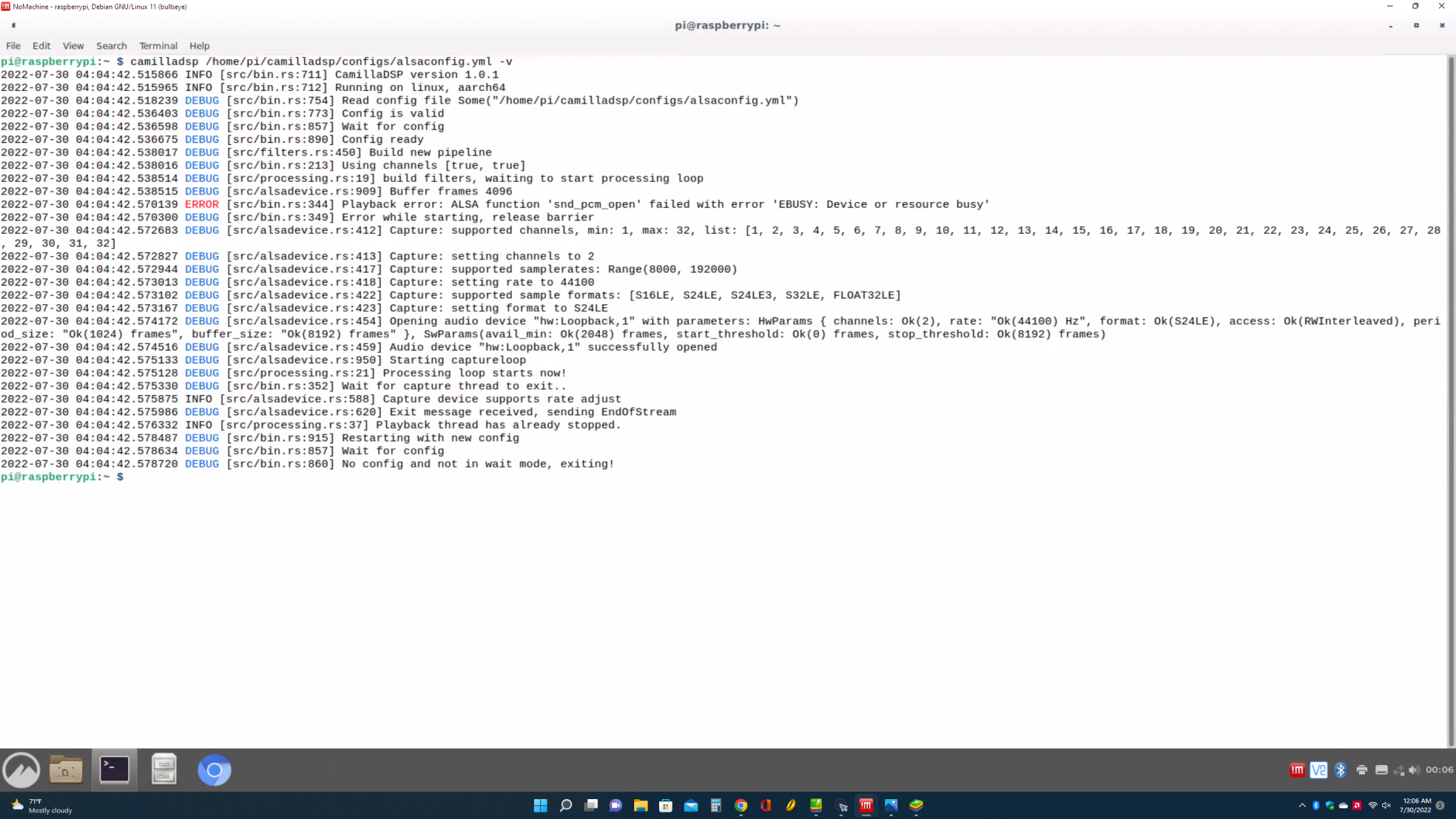

when I run camillaDSP from terminal it goes through without errors and then sits as paused processing.
Playing audio doesn't change verbose log.
I don't think it was working before because of the config files, which we fixed. So now it's trying to initialize and
sudo systemctl camilladsp says
04:04:42.570139 ERROR [src/bin.rs:344] Playback error: ALSA function 'snd_pcm_open' failed with error 'EBUSY: Device or resource busy'
Gui says offline and if I try to modify config file in GUI it doesn't save.
