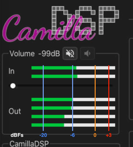

To aid the understanding of ones system gain structure, some numerical values to go along the VU meters would be tasty 🙂
Or a scale perhaps... as of now, its known what is going on between zero and clipping. Even where clipping is on that scale is uncertain...
Measurement tools need; scale, unit, precision and accuracy.

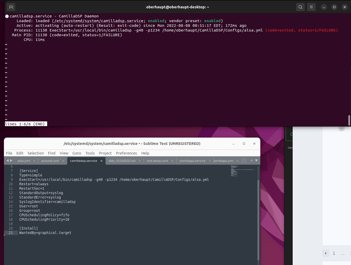

right now, can you tell me what is wrong with camilladsp.service? I followed Henrik and yours and triple checked. If I stop the service and cut and paste the command line from smailladsp.service into the terminal it fires right up, but it won't run automatically as a service.

This is actually quite similar to how it looks now 🙂 Look at the screenshot here: https://www.diyaudio.com/community/...m-correction-etc.349818/page-170#post-7087214
Right now the scale starts at -50dB, and it's linear in dB. I would like to change that to get a larger range. Sometimes it's useful to see if there is some very low level noise, so would like to expand the scale range up to 100 dB or so. I'm thinking something similar to your sketch, where it gets finer towards the right. Gridlines at 0, -3, -6, -12, -24, -48 and -96? I'll try that to see how it looks. But this is maybe something that should wait until the next version. Have to stop somewhere if it's ever going to get ready 🙂

Does the command work also if you tmrun it in a terminal as root?
My first guess would be that root doesn't have read permission to the config file. Check the permissions of the full path /home/oberhaupt/CamillaDSP/Configs/also.yml
You can see the permissions with "ls -l". Check every folder on the way, starting in /home

It was a damn " - " mdsimon pointed it out. Typing too fast, I guess I had ~/camilladsp -g40 -p1234 .... instead of ~/camilladsp -g-40 -p1234.....
