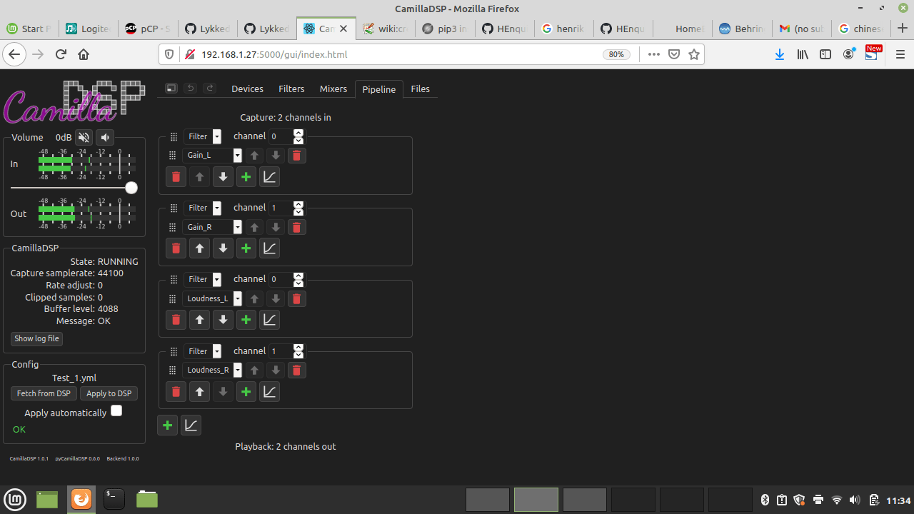

Hello...
I'am trying to update my repo. https://github.com/Lykkedk some, and i have installed the newest CamillaGUI
I also updated CamillaDSP to the newest :giggle: ... Well i didn't update the "Howto" yet...
It seem's to be working, but haven't tried it here on my test-rig with real FIR filters etc... only the "native" gain, loudness etc... stuff.
Should i be updating the PyCamillaDSP to the newest also ? And the pyCamillaDSP_plot ?
I use thoose now ::
py3.8-pycamilladsp-0.6.0.tcz
py3.8-pycamilladsp-plot-0.6.1.tcz

- The symbol on a filter to show it's characteristics is also present at the end of the pipeline. But here deviates the function, and instead a topology is shown.
I would think it would be very interesting to see the complete signal handling from the pipeline as a level/freq, like for a biquad.
But also the topology :) two buttons required?
The first one is fixed, I found a better icon for the pipeline diagram.
The second one is something I want to add, but it will take some work to get there. The challenge is that the pipeline is so free. Any input signal can be routed to contribute to any output, and it can even take several paths to get there. The best plan I have come up with is a plot where you select the input and output channels, and the plot then shows the frequency response for the path between these two.
Yes you should update both pycamilladsp to v1.0.0 and pycamilladsp-plot to v1.0.1!
