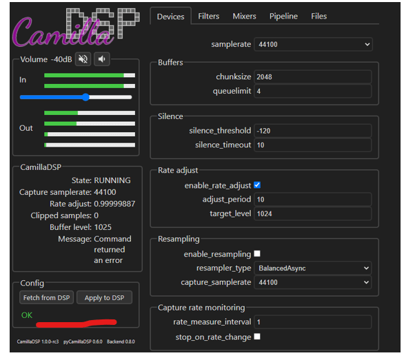

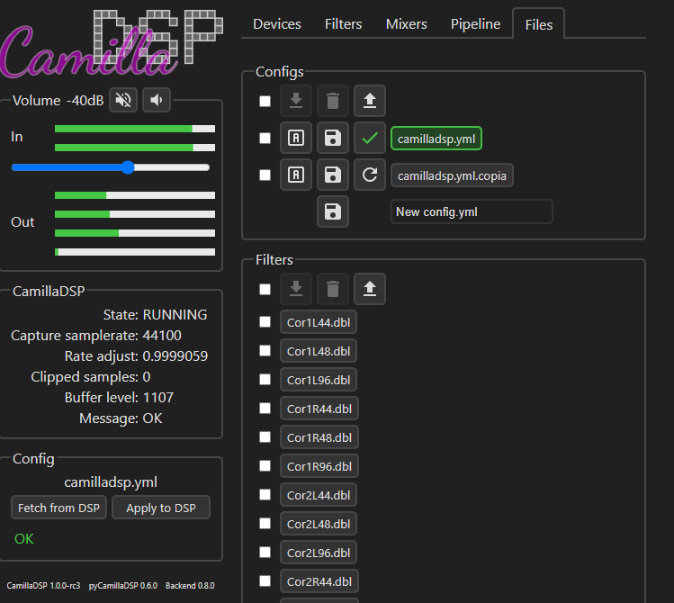

I wanted to tell you if this is a BUG, or if it is the expected behavior.
When I start CamillaDSP for the first time, the configuration file is not loaded in the GUI, if I try to apply or modify any changes in the interface, it returns the error message.
To fix it I don't have to follow these steps.
Go to FILE and press the LOAD icon.
Then press Fetch from DSP, and finally Apply to DSP.
From that moment on, the GUI is correctly applying the changes that I am making.

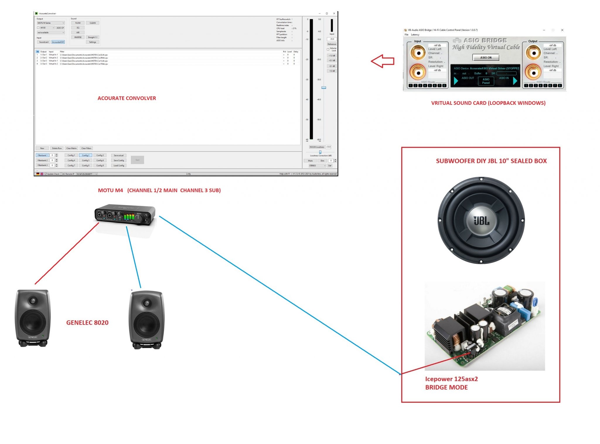

It is evident that I should go to a 2.2 system, but my humble system (setup attached) does not give much more!
Uli's recommendation (Acourate), is if I want to avoid clipping.
The only solution is to apply a factor of 0.5 = -6 dB gain to ALL filters (left_main, right_main, left_sub and right_sub). Thus you loose 1 bit (out of 24 bits today). Finally you can adjust the playback level by the amplifier in analog domain.
But as you can see, it would apply to all channels, not just the SUB channel.

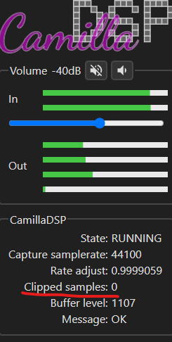

Totally agree TNT, it is evident that the most important and audible is an unpleasant clipping. I will be aware of the MOTU DISPLAY.
I don't know if the value of CamillaDSP Clipped sample is a value taken at the input or the final output before delivering to the MOTU M4.

c) This is the number of clipped samples as seen in the GUI. A few, up to a couple per second or so during loud passages, is usually inaudible.

You should not have to load the config from file, it should be enough to load from DSP. But you are running the GUI meant for 0.6.3 on 1.0.0-rc3 which isn't really tested, might be the reason it's a bit quirky. (Actually if that's the only quirk you get it's working far better than I had expected!)
Have you set the "active_config" and "default_config" properties of the backend correctly?
https://github.com/HEnquist/camillagui-backend#configuration
Thank you Henrik!
I have now applied these changes and it seems to work better.
But when I refresh the web browser, I have to hit Fetch from dsp again before Apply to DSP, otherwise it returns the error "Message:
Command returned an error"
By the way, what version of GUI should I install for 1.0.0-rc3?
