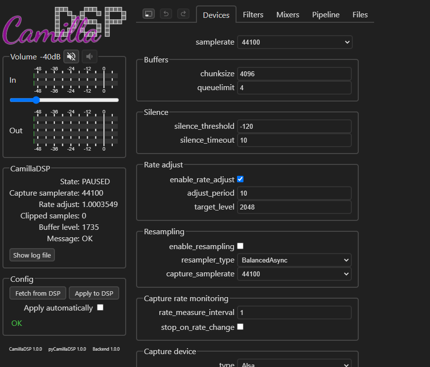

Thank you very much Henrik for these improvements! what I still can't get is when I start the active YML appears loaded in the GUI.
It goes like this:
And it should look like this right?
Every time I refresh the browser, the configuration file is lost.

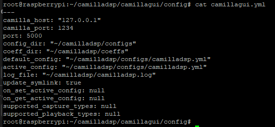

@isabido Did you ever update your camillagui.yml so that default_config and active_config point to the configuration you want?
When you lasted posted you had:
default_config: "~/camilladsp/default_config.yml"
active_config: "~/camilladsp/active_config.yml"

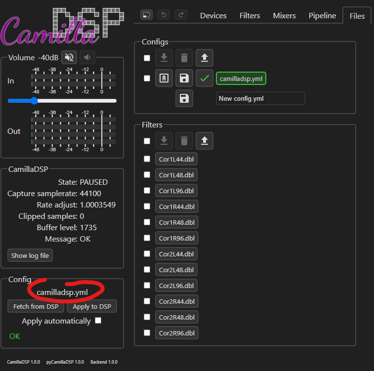

But based on your GUI screenshots you seem to be using a file called camilladsp.yml.
Michael

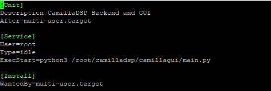

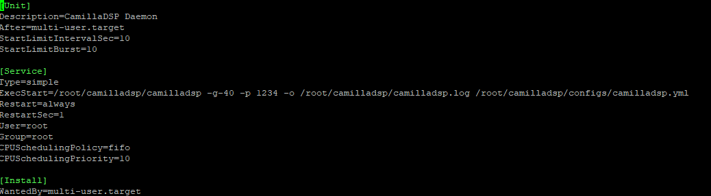

And so my CamillaDSP service starts
And so my CamillaGUI service starts

When I open the GUI all of the information in the GUI (Devices, Filters, Mixers, Pipeline) reflects camilladsp.yml which is what I have my active_config, default_config as well as my camilladsp.service set to. This configuration is applied automatically with nothing required to load it to the GUI or CamillaDSP.
However it does not show the name of the configuration in the lower left of the GUI.

For me CamillaDSP and the GUI always load a configuration file called camilladsp.yml. I can make changes in the GUI to this configuration and apply those changes to CamillaDSP but they will not become permanent (as in always loaded at start up) unless I save that configuration to overwrite camilladsp.yml.
This way I can leave my camilladsp.service and my camillagui.yml pointing to camilladsp.yml and I never need to change it. There may be a better way to do this but it works well for me.

There is some confusion about the gui config.
Let's take a look at these three lines:
default_config: this is the file that will be loaded into the gui when it starts.
active_config: this is the currently chosen active config. This should be a symlink to the file, not the file itself!
update_symlink: whether the gui should update the symlink or not when pressing that A in the files tab.
Try something like this:
If you instead want to save changes to the active config file, you have to press the save button at the active file in the files tab.
Code:
default_config: "~/camilladsp/my_great_config.yml"
update_symlink: true
- Save the config file you normally want to use as ~/camilladsp/my_great_config.yml
- Make a symlink at ~/camilladsp/active_config.yml that points to ~/camilladsp/my_great_config.yml
- Launch camilladsp with ~/camilladsp/active_config.yml as config file
