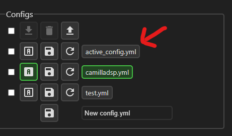

@HenrikEnquist, it would be nice if the active_config.yml wasn't visible from the files section, right?

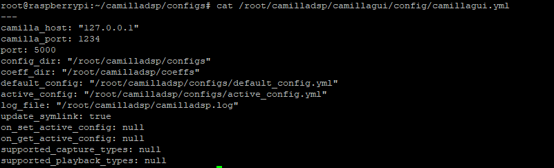

If you leave camillagui.yml as-is it will do exactly that.
I always wondered why default_config and active_config did not point to ~/camilladsp/configs in camillagui.yml but that explains it.
There is also no need to create default_config or symlink it to active_config. Just select a configuration that you have stored in ~/camilladsp/configs as active in the GUI and it will use that going forward.

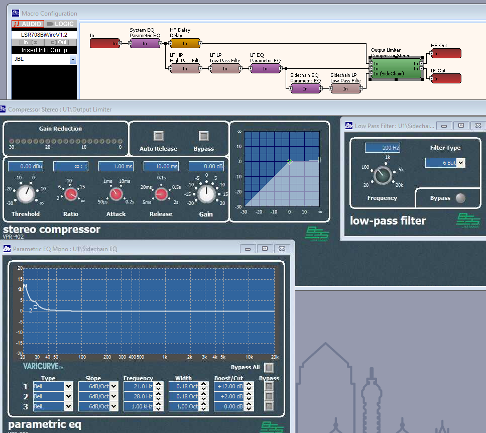

What is the side chain input of the limiter used for? An estimation of woofer excursion or something like that?@HenrikEnquist, would the CamillaDSP be able to deal with this sort of limiter?:
Yes, I thank that's exactly what it is. I'm trying to replicated JBL's DSP for their 708i speakers.What is the side chain input of the limiter used for? An estimation of woofer excursion or something like that?
https://www.avsforum.com/threads/jb...ofers-jan-2015.1724906/page-139#post-57945990
-Jim
Ok, and what does the compressor do with the three inputs? Compress the HP and LP signals based on the side chain signal?
Yes, exactly.
-Jim
Ok then yes camilladsp will be able to do it. The compressor will be included in the next version, v1.1.0. Or you can already use it if you build yourself from the "compressor" branch.

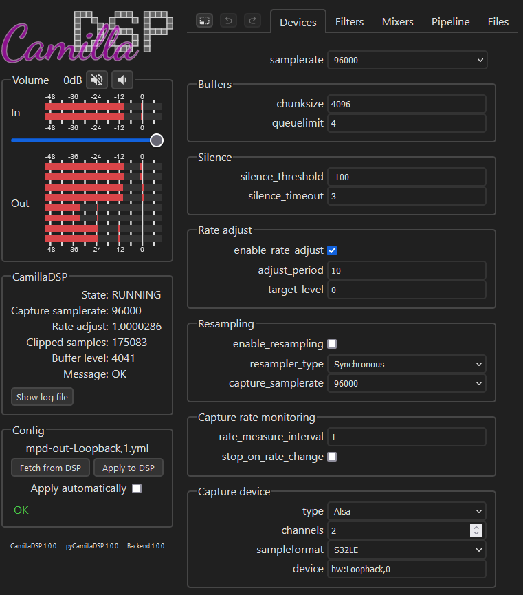

Greetings HenrikEnquist! I installed MPD 0.22.4 on debian 11 64bit (Linux Camilladsp 5.10.0-14-amd64 #1 SMP Debian 5.10.113-1 (2022-04-29) x86_64 GNU/Linux) and it works very well. I have Intel dual-core Intel® Atom D525MW 1.80GHz, Main Memory 2GB, Xonar D1 sound card. Next, I installed the fresh release 1.0.0 CamillaDSP and configured.
Everything works great!
Thank you for providing a great program!

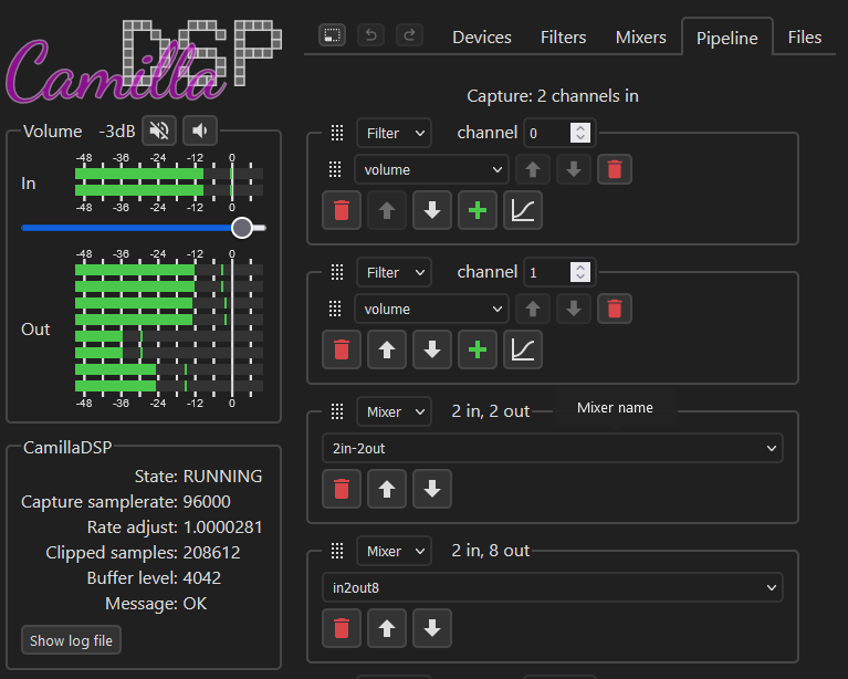

But a problem emerged. When audio is output from MPD (output 0dB) via "" device "hw:Loopback,1" "" the CamillaDSP input signal is overloaded to about 2.0 dB (this can be seen from the reddened Volume and Out and log, for example, one of many (2022 -05-15 18:52:25.647046 WARN [src/conversions.rs:65] Clipping detected, 12 samples clipped, peak +1.96 dB (125.4%)). Having carried out the experiments, it turns out that the 0 dB hw:Loopback,0 digital input is more sensitive than the digital output by about 2 dB, and an overload occurs at the input hw:Loopback,1 Camilladsp.
Playing white noise generated in Adobe Audition at 0dB, 16bit, 96000Hz
If at the same time I make the volume -3 dB in the CamillaDSP, there is no overload.
I don't understand where the problem could be?

And yet, if you play sinusoidal signals of different frequencies, then there is no overload or sometimes it shows overload at 0 dB of signal. For example 40Hz, 0dB :
2022-05-15 19:47:25.122842 WARN [src/conversions.rs:65] Clipping detected, 5 samples clipped, peak +0.00 dB (100.0%)
Thanks for the feedback!
The clipping you see is actually completely normal, but quite counter intuitive! When you apply filtering, the peak amplitude of the signal can go up, even if all your filters have only zero or negative gain. It's mentioned here in the faq: https://github.com/HEnquist/camilladsp/blob/master/FAQ.md#filtering
A short version is that filtering with only negative or zero gain filters will decrease the average power in the signal. But the filtering also shuffles the various frequency components of the signal around, which makes them sum up in a new way. This tends to produce some new peaks up to a few dB above the original signal.
