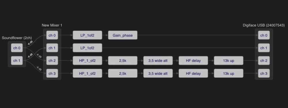

Gave it a try, thank you. My speaker (pair) currently has 14 channels (I use a 16 ch DAC). There are 8 x LF drivers (4 on each speaker).

I suspect that's its pushing available system resources. The next version of the speaker will have 24 x LF drivers spanning a stereo pair, so resource demand will only get greater!

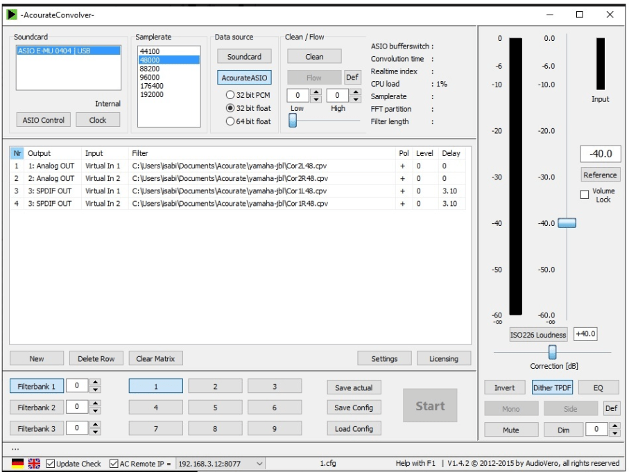

Hello guys, I currently use Uli's AcourateConvolver on windows, I'm testing this fabulous software on a raspi 3b. I need to do this mapping and I can't get it.
My system is a 2.1, generated with acourate, the XO and DRC filters are included in the same convolution.
Hope someone can guide me. Thanks in advance.

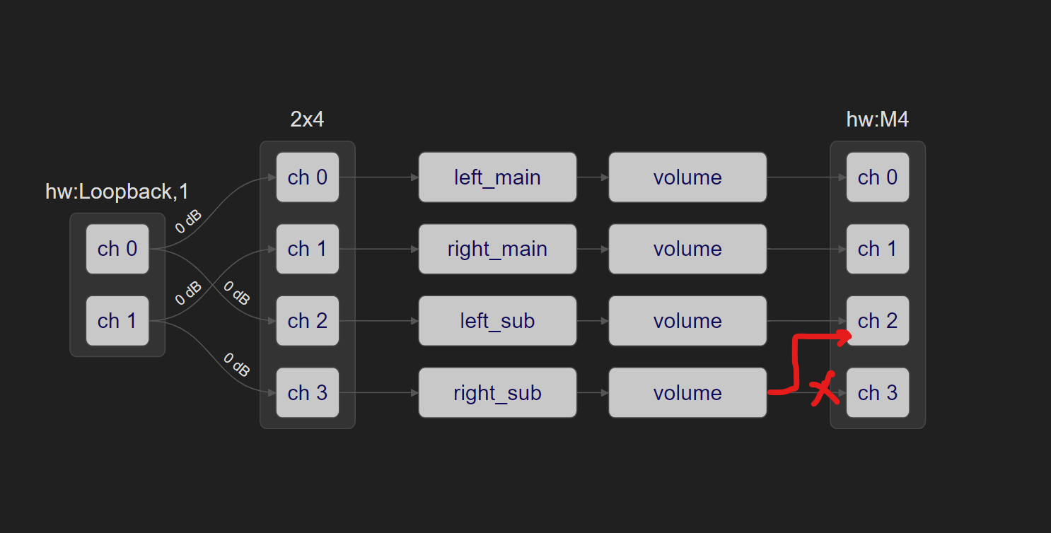

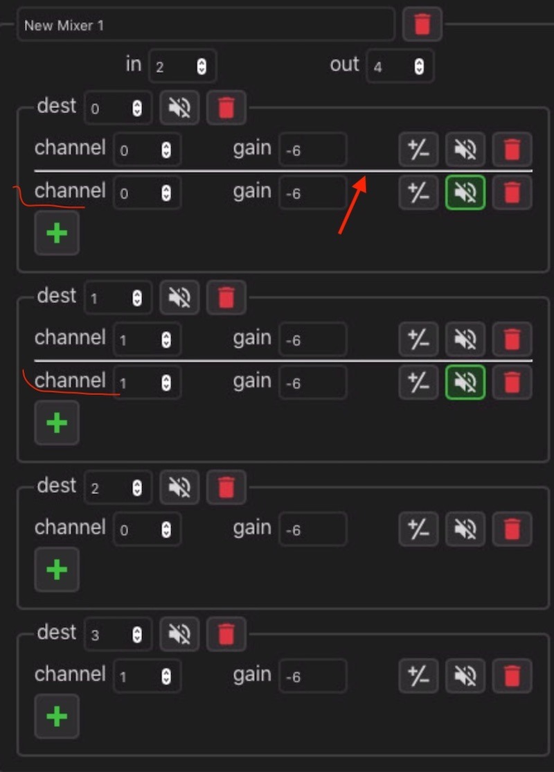

Why are the 2 upper destinations split in to two parts?
My intention was to do a basic 2 ch -> 4 ch split (2way active, stereo) USB in, 2 sp/pdif cables out.
I have a RME with 4 split outputs - maybe I shall only use dest 0 and dest 1 and assign ch 0-3 to these 2?
Pipe look ok...

I wish the concept of "Dest" under Mixer was used in the Pipeline display... it would sort out things a bit 🙂 (for me)
To make these quite complicated structures comprehensible, one need to use one set of well defined concepts throughout the whole system.
Hi TNT, thanks for your help, in my case this option is not valid I need to send the two input/capture channels L and R convolve, and then send the output of both to the same channel 3.
I attach an image of how it is configured in AcourateConvolver. I need to make this same connection.
