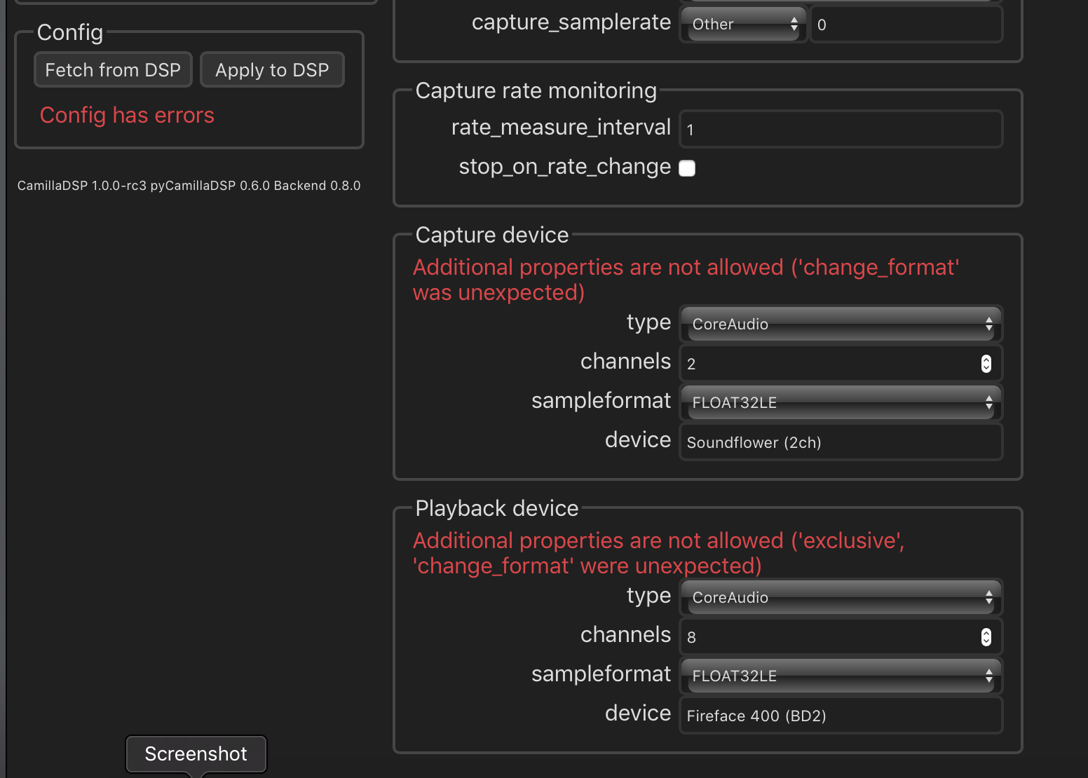

By the way, I get an error message after upgrading to CamillaDSP 1.0.0-rc3 from 0.6.3, but everything is still working as expected. The same
config file shows no error in 0.63.
On the other Hand, being a total noob with Terminal stuff, I had a lot of fun learning the basics of installing and maintaining those files.I can fully understand that. We just have to hope for something comparable easy for the user 🙂
My old macbook and the ancient firewire 400 card can live a second life as an active crossover and music client. It took me awhile to understand all that stuff, but now it works beautifully. Together with Squeezelite and Soundflower, it is such an elegant and slender solution and, if successfully installed, very easy to maintain. Thank you Henrik.
Sorry, that was stupid, I got an error message after trying in 0.6.3 too. Now I simply deleted those lines in the config file and all is ok. No idea how they got there...By the way, I get an error message after upgrading to CamillaDSP 1.0.0-rc3 from 0.6.3, but everything is still working as expected. The same
edit time ran out, so.... well those lines seem to be produced by camilladsp 1.0.0-rc3. saving the GUI to the config files puts them there. older versions don't do that.Sorry, that was stupid, I got an error message after trying in 0.6.3 too. Now I simply deleted those lines in the config file and all is ok. No idea how they got there...
Those two lines are new in camilladsp 1.0. Once that is released I'll update the GUI too.edit time ran out, so.... well those lines seem to be produced by camilladsp 1.0.0-rc3. saving the GUI to the config files puts them there. older versions don't do that.
