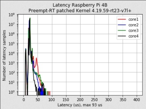

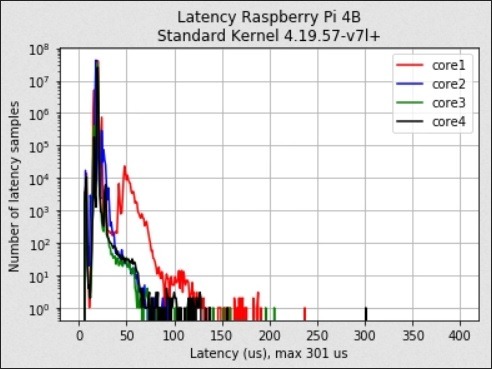

Here are some older RaspPi4 latency numbers between the standard and PREEMPT_RT kernels.How low can the latency become with recent linux distribution on a RPI 3 or 4 and a USB multichannel soundcard?
Say Camilla DSP 24db LR xovers and IIR filters and stable throughput.
Anyone who have tried to minimize latency and measured it?
There has also been specific CamillaDSP RaspPi performance numbers posted here.
Pi Tests
Specific configuration latency numbers are dependent on the specific drivers being used.
#Raspberry Pi 4B: Real-Time System using Preempt-RT (kernel 4.19.y)

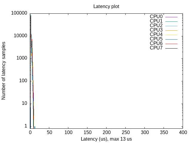

Here is 2 channel 192kHz content streamed over the web, sent to CamillaDSP, split into 8 output channels running 8 x 64-bit 256K tap FIRS on an old i7-3770K (@ 2012), resampled to 176.4kHz and set over USB to the DAC on the following kernel.
Linux 5.16.0-0.bpo.3-rt-amd64 #1 SMP PREEMPT_RT Debian 5.16.11-1~bpo11+1 (2022-03-02) x86_64 GNU/Linux
Multiple copies of multi-tab FireFox and multi-tab xcfe4 terminals are running in the background along over XRDP remote desktop.
Total system load is @ 5% CPU. I could never get this low of a latency on Windows with the same hardware.

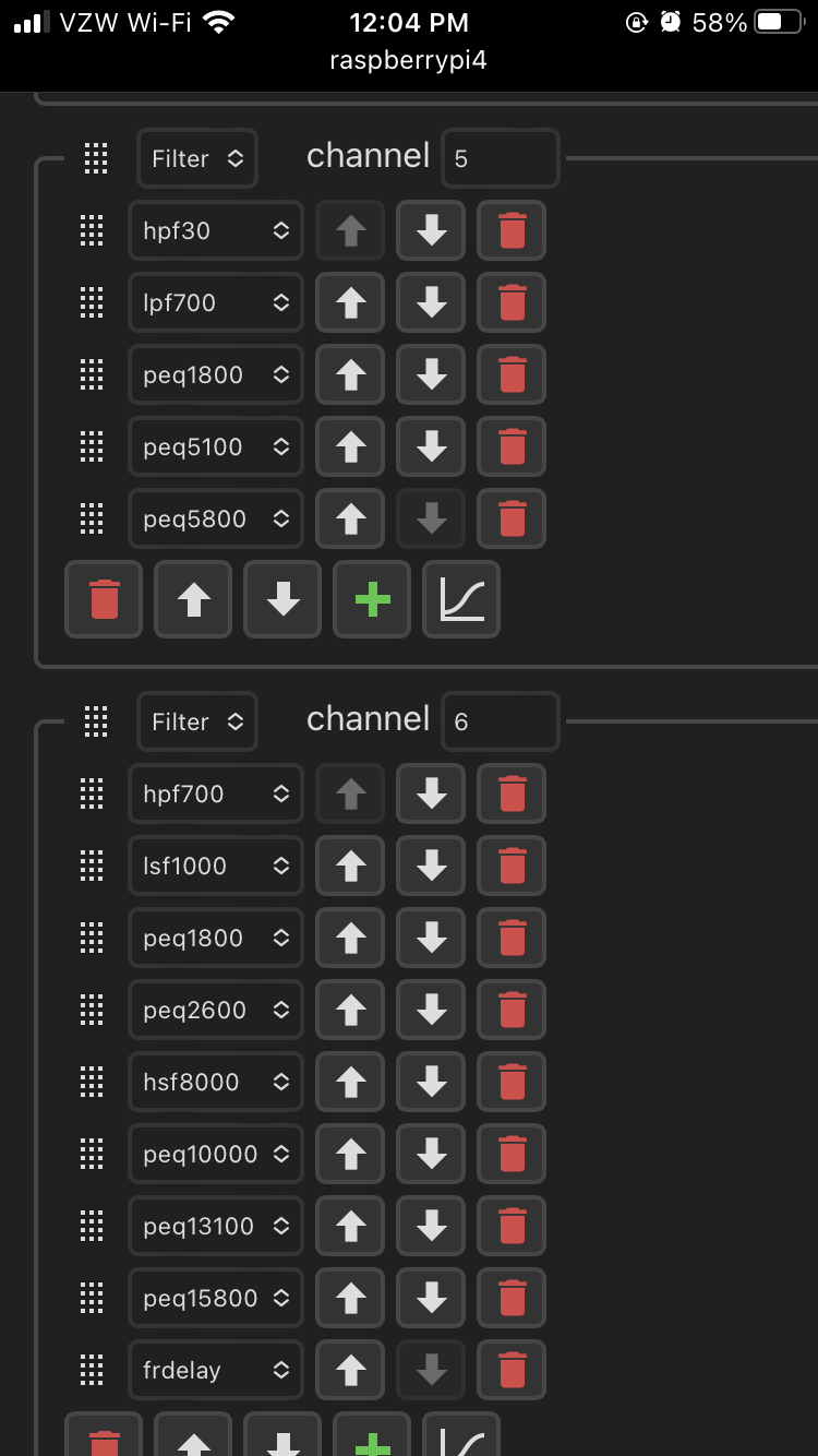

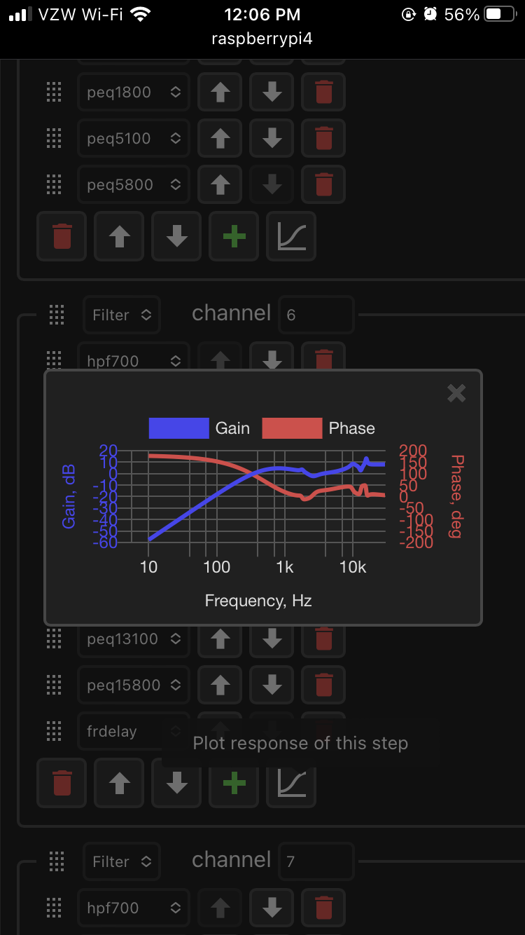

3) Pipeline will show combined filter response for each output by clicking plot button (same icon seen in Filter tab to plot individual filter response).

I agree about point 2.
Point 3 - thanks! I just noticed you are right but you have to combine all the filters into one step. I had a separate step for each filter plus one for the gain, per channel. Other than that I can now see the graph, which is the best approach?
As you note I use multiple filters in each step. Although I should mention that I also make gain and polarity adjustments in the Mixer and that is not reflected by the Pipeline plot. IMO CamillaDSP plotting is a nice quick visualization to see if the filters are working as expected but I always like to make a measurement of the DAC output with an ADC to truly confirm.
Michael
