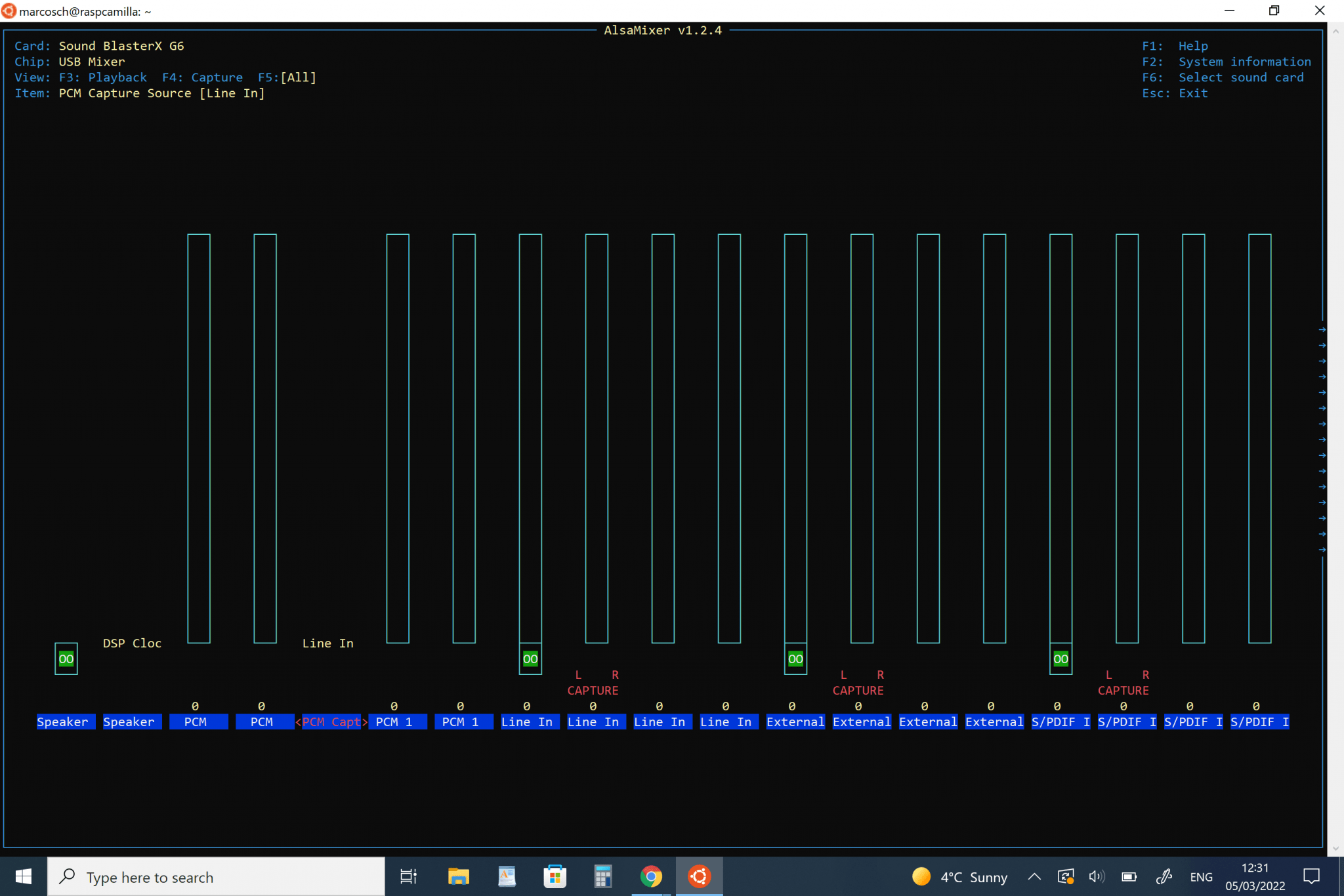

i can confirm now. In normal mode it is not possible to change any setting in alsamixer. i see alsamixer like this:
when i try the instruction you suggested it doesnt do anything, stays in line in:

The other thing to try is to enter the text value for the desired item, not its index. This might be necessary because the control is of type ENUMERATED and not of type INTEGER. So for example try this:
This worked on my system to set the value of an enumerated soundcard property:
In the output above, I was able to set the value from Disabled to Enabled. The "values" field at the end gives the index, not the text, of the current setting in the enumerated item list. Also I did not need to use sudo to do this.
Bash:
sudo amixer -c G6 cset numid=20 'S/PDIF In'

marcosch@raspcamilla:~$ sudo amixer -c G6 cset numid=20 'S/PDIF In'The other thing to try is to enter the text value for the desired item, not its index. This might be necessary because the control is of type ENUMERATED and not of type INTEGER. So for example try this:
Bash:sudo amixer -c G6 cset numid=20 'S/PDIF In'
Bash:charlie@CI327:~$ amixer -c 1 cset numid=3 'Disabled' numid=3,iface=MIXER,name='Loopback Mixing' ; type=ENUMERATED,access=rw------,values=1,items=2 ; Item #0 'Disabled' ; Item #1 'Enabled' : values=0 charlie@CI327:~$ amixer -c 1 cset numid=3 'Enabled' numid=3,iface=MIXER,name='Loopback Mixing' ; type=ENUMERATED,access=rw------,values=1,items=2 ; Item #0 'Disabled' ; Item #1 'Enabled' : values=1
[sudo] password for marcosch:
numid=20,iface=MIXER,name='PCM Capture Source'
; type=ENUMERATED,access=rw------,values=1,items=4
; Item #0 'Line In'
; Item #1 'External Mic'
; Item #2 'S/PDIF In'
; Item #3 'What U Hear'
: values=0
