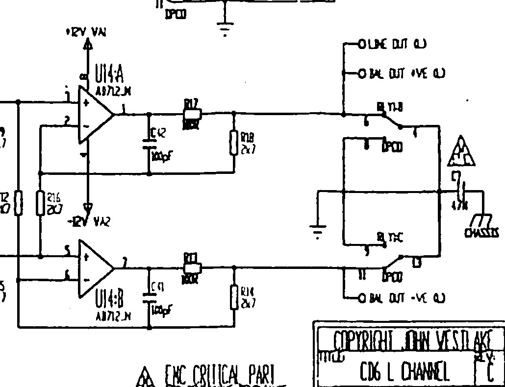

Ok, I lifted the 100r at pin1 of the AD712 on the left channel so that both opamp 100r's are isolated from both 712's. The trace from the scope is the same as with the 100r's connected. a flat line and then squashed up.

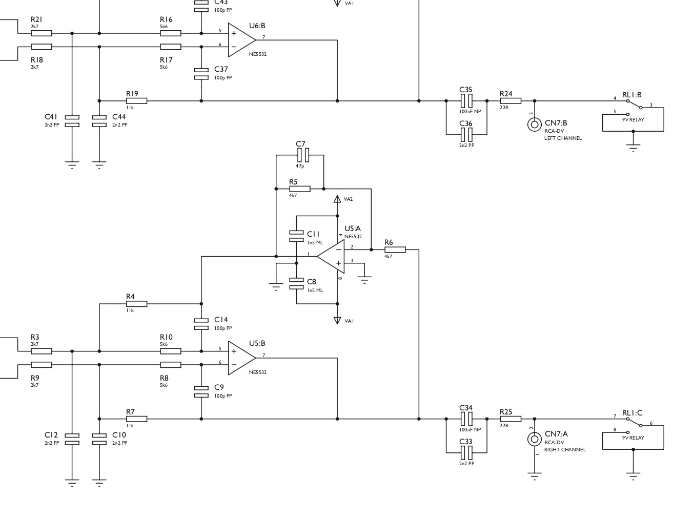

The voltage at pin 6 of the 5534 is 2.5v and pin 7 is 5v. On pins 6 & 7 I checked on google images what noise or ripple would like and the trace I got does not to me look like there is any ripple or noise, it was more a flat line again. I was using the 10hz to 10khz sweep.

Is there a higher res schematic? Do you have any Puffin? -a hard copy?
Mooly, Looks almost identical to the 640c, The signal is connected to the relays in the way you describe, still connects though.
Puffin,
Are you getting the same fault out of the digital outs?
This will assist the process of elimination...
All that sounds OK.
I need to think some more on this as nothing at all about this fault makes any sense.
The muting relay does not pass audio when not muted. When playing the relay closes linking relay pins 6 and 8 in your diagram. Pin 7 on the relay which is the audio out line now floats.Mooly, Looks almost identical to the 640c, The signal is connected to the relays in the way you describe, still connects though.
On Puffin's player isolating the 100R's removes the relays from any suspicion. The only 'fault' they could cause when in circuit is not physically operating correctly and the contacts staying partly shorted and so shunting the audio to ground. The 100R test removes any doubts.

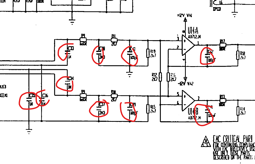

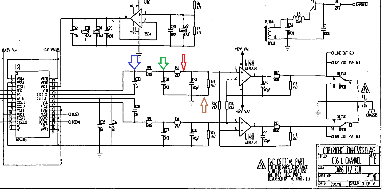

Did you also try this at the two points I circled in post #53. Those points are straight from the D/A convertor.
Also as you are getting more used to the scope now 🙂 do you have any idea at what sort of frequency the bass starts to become normal amplitude? The level should be constant at any frequency.
If you are not sure then if you play the sweep CD on a good player and decent speakers you will begin to hear the bass from around say 30Hz upwards. Compare the CD6 to the good player and note the time display on the player where the CD6 bass seems equal to the good player.
We can then get a good idea then of the frequency by seeing how far into the track you need to go for the bass to be normal.
"Did you also try this at the two points I circled in post #53. Those points are straight from the D/A convertor.

I still feel like I am playing with the scope rather than using it properly. I forgot to say that to scope the points you circled in post 53 I think would mean disconnecting everything attached to that board to get to the underneath as I am not sure it can be done from the top of the board?
I will attempt to judge the bass frequency using the CD6 and another player using the sweep tones.

You might be able to get at those points by measuring on the resistors or cap at the top of the board. The resistors on the diagram (blurry) look like 620 ohm. measure on those if you can find them.
The ten blue caps:
Are going to be these:
If all else fails start measuring at pins 3 and 5 of the opamp and work back towards the left on the diagram by identifying the resistors and caps.
The ten blue caps:

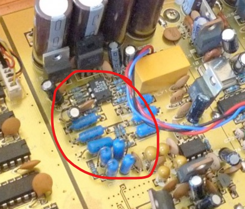

I have probed and scoped the area around the 10 blue resistors. Some of the leads excite the scope giving the same flat line/squashed presentation, others give no read out. I assume that all the resistors are linked in some way and I can't really measure individual ones with accuracy. Tomorrow I will listen to the CD6 and and another player to attempt to determine where the bass comes in.
The blue parts are the caps. If you follow the copper print on the board from the IC pins 3 and 5 and follow the circuit diagram at the same time you will spot the resistors those pins go to and so on. You should be able to identify the parts doing that.
