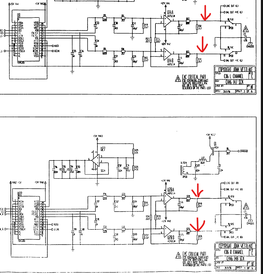

With the power OFF, each of these points should read directly to ground (a dead short). This means left and right RCA outputs should read short at the socket with power off.
I am afraid I am struggling a bit with this now. I have located two 2K7s and with the power off they appear to be a dead short with the signal pin of the RCAs...however either resistor to either RCA gives a continuity beep. If the machine is off is what you said here not relevant?
"Direct continuity (0.00 ohms, a short circuit) will be because of the shorting action of the muting relay. That is how it works, shunting all the output pins to ground when power is off."
That all sounds correct. Only one end of the resistor should give a continuity beep to the centre pin of the RCA. That same end should also beep to the outer ground part of the RCA as well with the power off. That is because the relay contacts are closed and placing a short circuit across the socket to give a perfect mute.

When I tidied up the wiring I said that on the L channel the wire to the + solder point on the PCB was blue and the red in the - position which I corrected.
Give it another listen before you do any more testing. If it still sounds wrong just swap the wiring to one speaker and listen again. If the feed from the PCB was reversed the phase would be wrong.
To use a quote from the 80s or 90s....Bass....How Low Can You Go?! Well the bass is back! There is a small issue with some intermittent noise on the L channel (sounds like white noise) which comes and goes and may be a result of original or later poor soldering as pressing the L grd tab seemed to stop it. I will check the tightness of the RCAs to the Grd tabs.
IMO the confused wriring on one channel looks to have been done in the factory and perhaps the reason it was only £20. It could also be the reason I didn't use it and shelved it. It must have been over 20 years ago I bought it and as we get older........etc etc
I will get the RCA outs sorted properly and then re-solder the XLRs and see if they follow the ususal pinout layout.

It sounds like you had a phase inversion. If you were to swap the wires over now to one speaker it should 'recreate' the fault you had if that was the case. Also with phase inversion vocals loose the ability to form a good image between the speakers and will seem to come from 'both sides' rather than a central image.
Get the ground right on the XLR's and then wire both outputs the same. As long as both channels are wired the same then phase is preserved.
If both are wired 'the same' but both happen to be reversed then phase is still preserved but 'absolute phase' is not. Absolute phase is often considered not very important and you are unlikely to hear any difference. It just means both speaker cones move in instead of out and vice versa.
