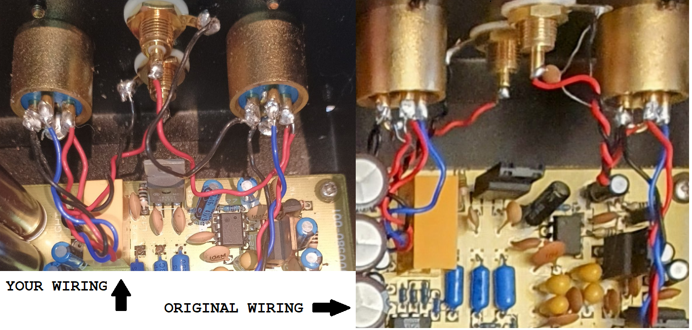

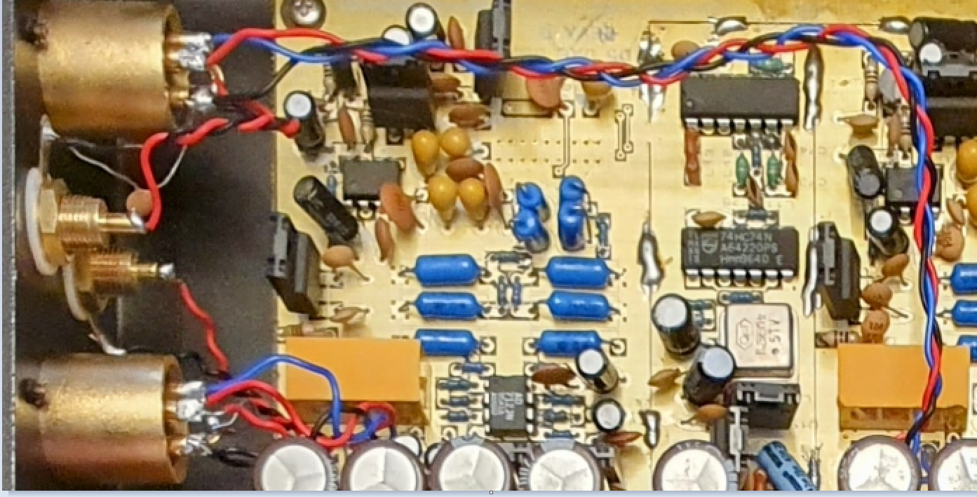

This afternoon I cleaned up the mess on the XLRs and corrected the incorrect R channel wiring on the the board. Is it agreed that the correct orientation of the sockets are Pin1 Grd, Pin 2 Pos and pin 3 Neg? I also Apologise for having originaly suggested that the machine had not been tampered with.....😳
If it's true that an image is worth more than a thousand words, I would try with the following one where perhaps to use related colors further reduces the risk of errors. IMO
If you carefully look at the pics above you notice that the blue wires are incorrectly welded on the central pin where the red ones should instead go.
I have not re-wired the XLRs I removed the wires as Mooly asked to Scope certain points. I have asked for confirmation of the correct pins for each wire.
I never said you did it.I have not re-wired the XLRs
The pics caption is obviously short for reasons of opportunities or instead of "your wiring" I would have had to write: "The wiring of your current connectors that has been wrongly welded not by you?". 🙄

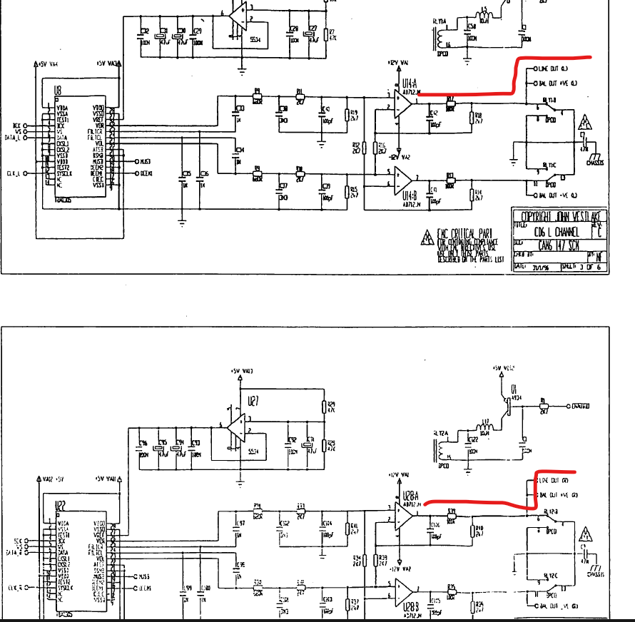

Yes, I have wired the RCAsWhy not just wire the RCA outputs up for now.
(If you did wire the RCA's (or they were wired) and used a wrong feed from the board you could end up with subjectively 'no bass' as the outputs would be out of phase)
OK. Just make sure the centre feed to each is from the same opamp output on each board.
Look at the circuit. The upper opamp of the pair should be the signal feed to the RCA. If one channel used the feed from the lower opamp it would be out of phase.
So it is the feed from pin 1 (through that 100R series resistor) that is the correct one to use for both channels and not the feed from pin 7.
