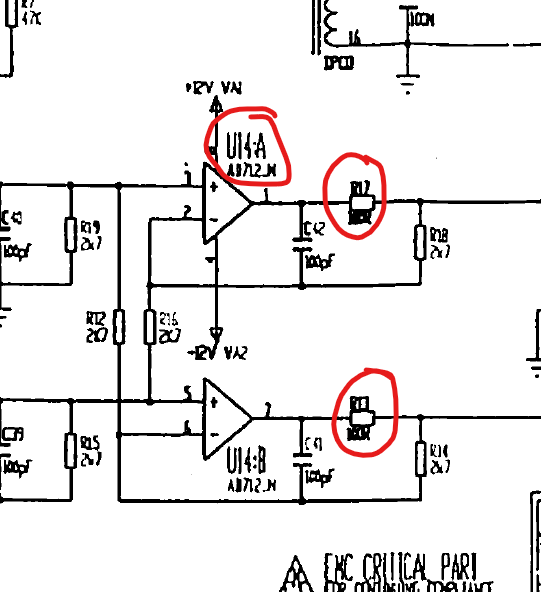

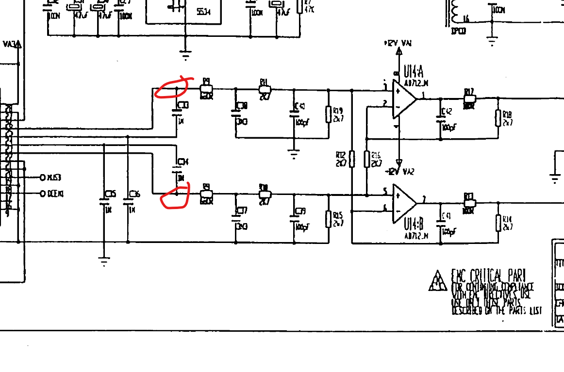

What I saw in the screen shot in post 35 was a 5534 opamp which I assumed was the opamp to test and if no joy to test at the points indicated by the arrows. The board has 2 AD712 dual opamps which I will of course test as suggested.That means your player differs from the diagram then.
If you look at the location reference number on the diagram it also says U14A and U14B meaning U14 is the component reference number on the board and the A and B refer to the two opamps in the one package.
The diagram shows a total of four actual devices for both channels. One dual and one single per channel.
If yours are all NE5534's then you must be seeing six IC's in total. Does that look right?
Manufacturers do sometimes have different versions of equipment so that could be a possibility.
🙂 Post 35
It is the AD712 to test first at its outputs. If that shows a problem then see what is at those two arrowed locations. The 5534 is the DC reference generator, nothing to check here with the scope at this point.
the analogue filtering and buffer are the two opamps at the right. The opamp at the top just generates a clean reference voltage.
Yes.Are there other areas that I should be checking e.g Caps or other components?

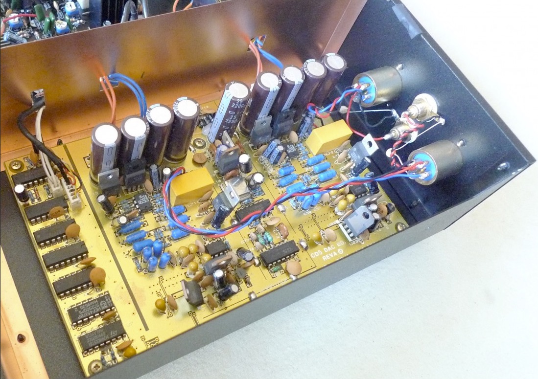

There are two relays on the output pcb on the CD6, yellowish in color on the images i'm looking at. Is this what you have?

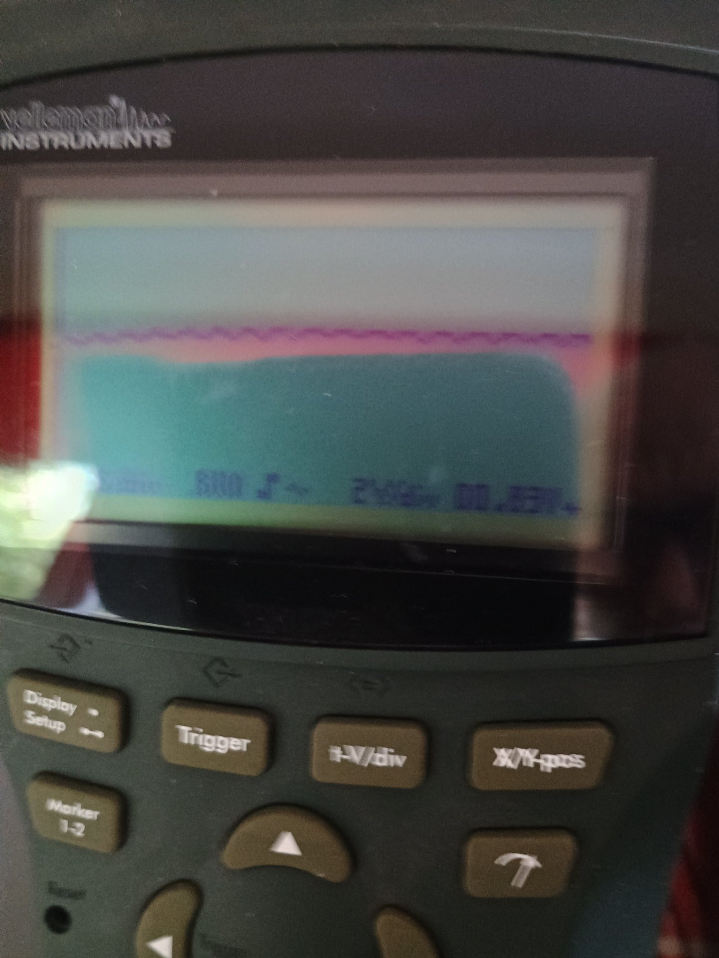

I got a chance to scope the AD 712s. Both readings at Pins 1 & 7 were the same and I attach pics of the readings at start and finish. At the start of the 10hz to 10khz sweep was a simply a flat line which changed very little until approx 20s in. In relation to the said relays. I thought by their shape that they were caps, but clearly not. They get quite warm when the player has not been on very long. I assumed they were caps as there is no tell tale click from them on turn on.
I think an unusual design decision to have a virtual earth/ muting arrangement convoluted matters to unreliability.
Ultimately the relay shorts the RCA socket output to mute so I think in one sense its fairly conventional.... and I see Puffin has posted.... and if the signals are the same in amplitude (and this is important, if they are the same) then I would think the relay has to be opening OK.
The opamp should drive the 100 ohm series feed resistor OK even if the output is grounded because the signal levels are low. If the signal is the same at each end of the 100 ohm then there is no current flow into the muting relay.
The fault though doesn't make sense in affecting just the bass.
If there is doubt then the 100ohm can be lifted (isolate one end) and the levels checked again on the opamp outputs.
That result confirms the lack of bass. No output at low frequency. That is bizarre to me. And both channels are the same... odd.At the start of the 10hz to 10khz sweep was a simply a flat line which changed very little until approx 20s in.
Given that @Earths has mentioned the relay as a known fault perhaps you could just isolate one of the 100 ohm resistors and then measure directly on the opamp pin that resistor comes from. That would eliminate the relay. If you are neat soldering and don't want to remove the board and so on then perhaps just snip the resistor to check and then resolder it back when done.
I lifted the 100ohm resistor at Pin 1 of the R channel 712. The scope showed no output and on pin 7 it showed the same straight line and squashed signal as already posted. I heard the relays clicking today, now it could be that it is because I now know they are relays although I first heard them on power down. When I powered on again I was not sure that I could hear the R channel one but that is where the 100r was lifted.
Its all very very bizarre is this fault. It really is 🙂
With the 100 ohm lifted at pin 1 and no signal at pin 1 we can say the relay is not affecting things... but lets cover all possible bases so we don't need to backtrack. Because of the cross connection of R16 in that stage to the other opamp lets also now isolate the second 100R. So both 100R's are lifted.
If there is still the lack of bass shown on the scope at pins 1 and 7 we have to look at these points now. I'm going to ask someone else on here as well whether any of this makes sense. It sure is an interesting issue:

If you are working on the left channel (and it doesn't matter which channel you pick as both channels are the same) then according to the circuit the opamp is U14. The 100R's are a bit blurry on the diagram to read both the numbers but it is these. You then measure on pins 1 and 2 as before and if that is no good then move to the points I circled above.
Isolating these two resistors together 100% isolates them from the mute circuit and the sockets.
More thoughts after discussing it with others.
Do a quick check with your meter of the DC voltage on pin 6 of the NE5534 opamp. It should be 2.5 volts DC. Also check the 5 volt rail on pin 7
If both those are OK then set your scope to AC coupling and make sure there is no noise or ripple on 6 and pin 7 of the IC.
