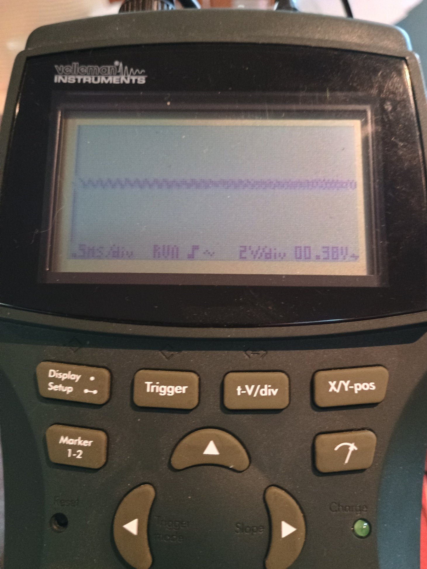

Well I burnt the test tones and assumed that I could put them on YT as before. I am having a real fight to get it to do the same. I will keep trying!
That doesn't look right at all.
If you play the tones they should sound very pure. The scope image seems almost like noise. You should see similar to what you saw with the sweep (pure sinewave) except now the frequency is constant. Try just playing them and make sure they sound OK. You can use the sweep tone as well as a reference.

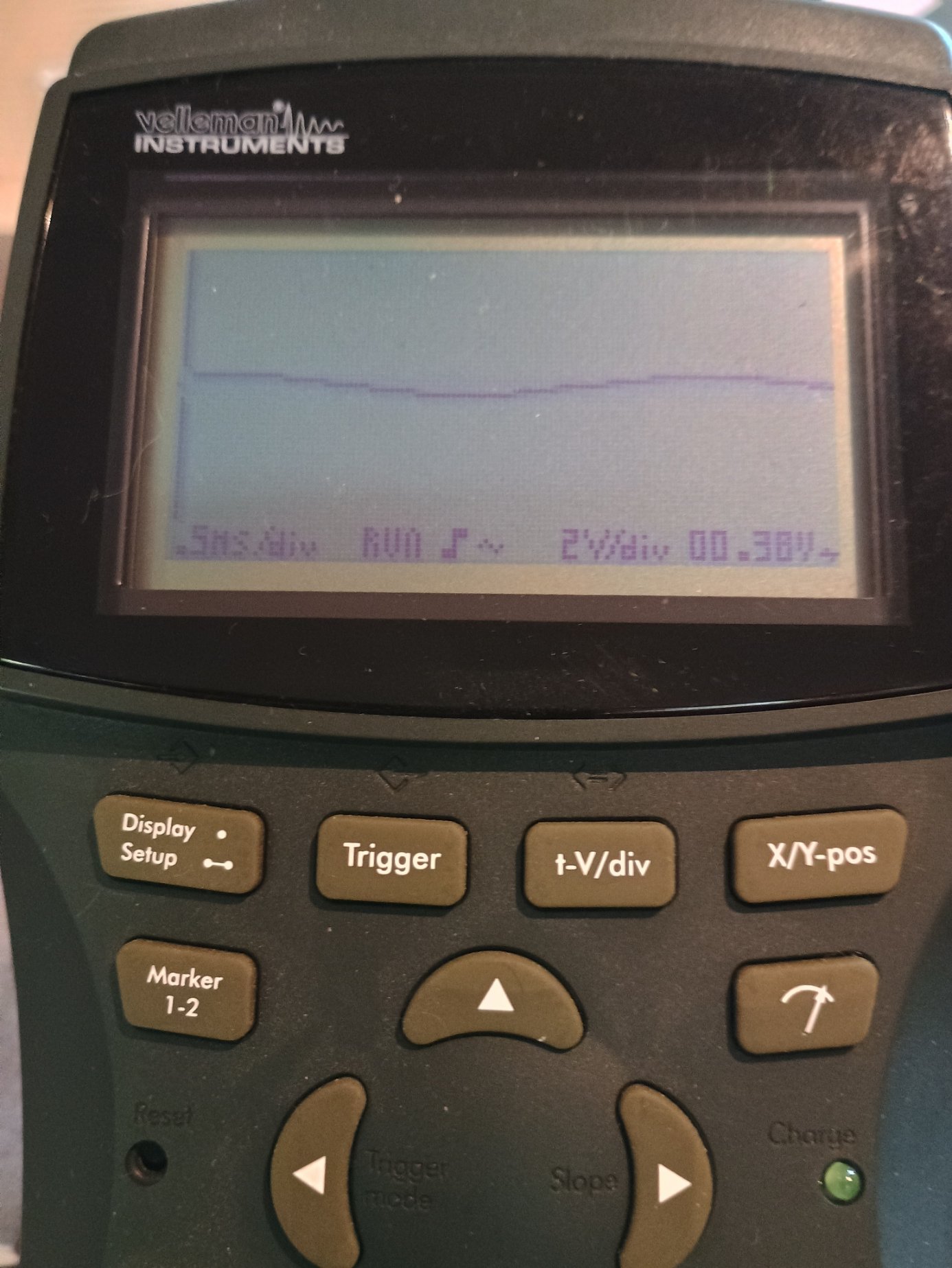

I have played the 10Hz t0 10 Khz sweep through another CD player and I get the lowest and the highest tones. As I have OB speakers I have 2 subwoofers as well. When the sweep is played through the CD6 the subs are not energising and there is no deep bass. I haev taken some pics of the scope using the sweep at 10s, 20s and 25s as I thought it easier to use pics.
Interesting. So the CD6 appears not to really be lacking in bass. That is very strange actually. The pictures you show look correct and you say it seems to sound correct as well when played on another CD player. So the test CD is OK and your system seems OK.

The generic CD spec is a flat response from right down to around 2Hz up to 20kHz. Your three pictures show that the amplitude on those is constant at the different frequencies and the CD6 should be identical.

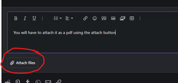

You will have to attach it as a pdf using the attach button. This will open a window where you can browse your PC for the file 🙂
OK 🙂 Web browsers will open pdf's but of course that file path is just one on your own PC.

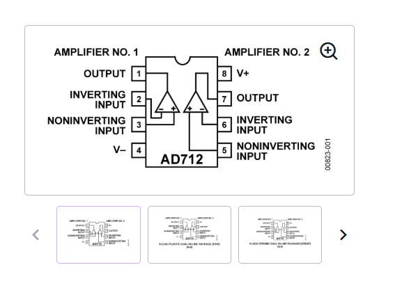

Right then, this is really bizarre. The audio stages are DC coupled, no coupling caps. What you need to do is use the scope to try and look at this audio signal internally in the player. This is the left channel from the manual. The right channel is identical. The DAC is at the left and the analogue filtering and buffer are the two opamps at the right. The opamp at the top just generates a clean reference voltage. The pin numbers show the opamps at the right are in fact a single package with two opamps inside.
You can try playing the test tone and probing the opamp pins. Pins 1 and 7 are both outputs and should look the same on the scope. The amplitude of the tones should be identical at all frequencies.
If that shows a problem then look this time on pins 3 and 5. That should show the audio but there may be high frequency noise making the trace look a bit 'furry'. That's normal.

The one with audio is the dual opamp. Look at the diagram above that I posted. That was from the manual. It shows the opamp as an AD712 which looks like this. This is the one to measure on:
There are two opamp's in the package. Pin and pin 7 are outputs.
