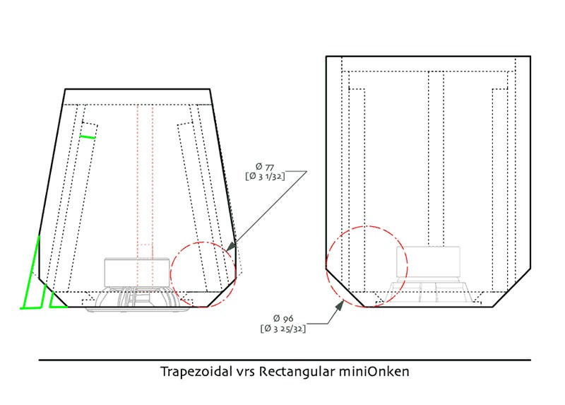

Excuse me but perhaps I was unclear in what I wrote. I have no doubt that internally, the usage of trapezoidal sections and angled surfaces is sonically desirable (even if I don't fully understand the radius issue in your comparison). My spouse was not frowning at the trapezoidal cross-section, just at the external, narrow slanted edges that the very vents are on.
However (pardon the naiveté of the question) does the external shape of the cabinet affect the sound at all?
And, if not, how about altering the external shape of the trapezoidal version like in the green changes below? I guess a change in the geometry of the last inch of the "tunnel" will mean it's length needs adjusting at the back end, to stay the same.
Yeah, I know, all of this "just" for looks. Dave, does this make sonic sense at all?
Actually the inside of the trapezoid box is not that much of an improvement as the rectangular.
It is the outside. The outside of the box makes a substantial difference in a loudspeaker’s diffraction signature.
At HF we have edge diffraction if the edges are sharp (relative to the frequency). At low frequencies we have baffle step, the change from 2π radiation to 4π radiation. The shape of the box has a decided e=affect on the shape of the ripple.
&W has done some of the most extensive work on cabinet shape and ended up with this:

Dave, you opened my eyes to a whole new topic (by pointing to the external shape of the cabinet). Would this not mean that all the objects in the appartment participate in the same diffraction game? Or is this reserved for those that are close to the emmission source (=driver)?
Also interesting is the table you linked. Of course, I understand that the depicted curves are not exact dot-for-dot frequency-responses of real cabinets that would have those particular shapes, but still.

And again, a belated epiphany: sound is a form of radiation. Therefore, its intensity decreases with the square of the distance. It would make sense that any influence of a shape also is subject to that proportion. Which means that rounding (angling, chamfering, etc) has an effect mainly when it concerns surfaces close to the radiation source (drivers, passive membranes, ports and so on). Did I get it?
Yes. The closer the objectthe sooner the effect. If it is close enuff to be within the ear/brain’s tie window, it gets folded into what we percieve as the direct sound and “blurs” it.

Hw about this shape:
It pushes edge issues way away in time, the baffle slowly falls away further decreasing things, and the wide stance, pushed aprpropriately close to the wall has an effective transition from 2P to 4P such that the wall takes over and effective radiation remains 2π.
