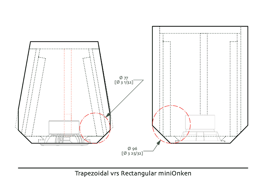

Therefore - a question: I take it that the angled front edges are an aesthetical factor only and they could in theory be flat as well. By that I mean the surfaces with the five vents being flush with the front surface (probably with a corresponding shortening of the hidden tunnels, as this would lenghten them by a small fraction.
"Someone" is watching over my shoulder and has her oppinion about the looks. ;-)

I take it that the angled front edges are an aesthetical factor only and they could in theory be flat as well..
The big chamfer is very functional. The Axi-Ken is a rectangular MiniOnken, the trapezoid version takes things even further as far as diffraction signature minimization.
It can be left flat, but some changes need to be made, and the box will become more sonically visible.

Don’t know what you are trying to point out with Lynn’s words, but for a chamfer/roundover to be effective into the lower frequencies, it needs to be fairly large.
The chamfer typically seen on the rectangualr miniOnkens is equivilent to about a 3” radius, the teapezois miniOnken takes things a step further extending the “chamfer to the sides of the cabinet to approximate a teardrop shape in plan. These chamfers get the edges to the point where the fall away at teh bafflre edges is large enuff.
The difference between the rectangular & trapezoidal miniOnkensd is audible with the right material (in a system that does not lose the critical imaging/space information).
dave
dave
