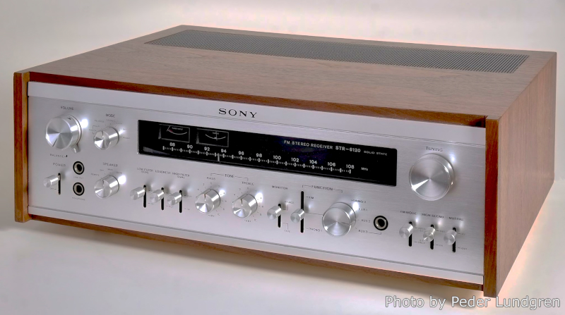

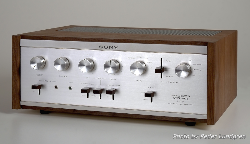

No as I am all revved up let me tell you my secret. Vintage Sony got a big spot in my heart. I love the sound and built quality of these from the mid sixties up to beginning of the seventies. The top dg is the TA-1120, the very first one with no headphone out on the front. Another is the big receiver STR-6120 that I got from USA. there was no wooden sleeves so my carpenter friend helped me with a bunch i Walnut after one original piece.
Wow, they are both wonderful... There is something great about those old receivers (Luxman, Sansui, Sony, Pioneer and the rest). My old Tannoy loudspeakers went to the secondary (studio) system once the Coral horns arrived and I wouldn't mind driving them with one of these wonders! Bleeding-ears-testing-grade equipment and one-ton kilowatt monoblocks are nice in the Munich Audio show, not necesarily if you need to actualy live a life near these sound sources. By the way, as I mentioned before, my enlarged Corals have old RFT german drivers and they are very listenable. No harshness. My friend had the (similar) Jeriho horn with Fostex and his wife buldozered him into selling them under threat of divorce.
