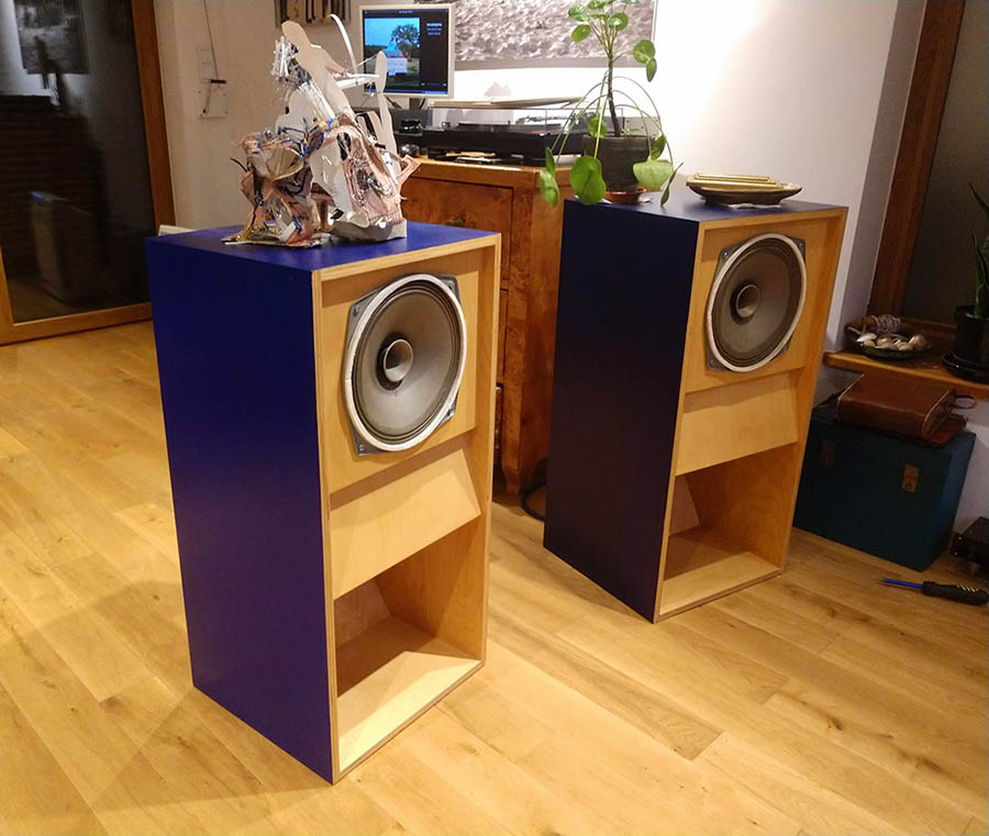

I too have been under the influence of the article in TNT-audio and have since purchased the drivers. Jumped on the occasion for two reasons:
- first, the pair of Axiom 201 I got are in mint condition, almost NOS.
- second, I already own an enclosure based on the very same Coral plans, that has been *already* enlarged and is now housing a pair of vintage RFT drivers.
So now I am stuck with many of the problems that @landrupp is quoting in his posts.

Whoops, I just now realize this is my first ever post to this forum. Greetings to all of you and thank you for all the information I was sifting through for a long time now.
Sorry for the post flooding but I thought there is something I should add. There is a reason why I am so hell-bend on copying Chris Templar's success story and applying the old Coral cabinet design to the Goodmans driver. I have listened extensively to the Coral cabinet fitted with the Beta 10 it was intended for. I also listened a bit to the Coral Beta 8 version, also with the original driver. Driven by an Audionote Quest clone. All I can say is these are stunningly good drivers in cabinets that do them justice. I have no intention to discuss the pluses and minuses of single-driver reproduction: am simply not qualified enough to do so.
Back to my experience:
Since one year I am listening to my pair of modified Coral enclosures, resized for 12-inch by adding size to the bottom. They have their quirks. The driver is from a very much lower price league and is anything but bass-efficient and not exactly linear but hugely efficient - perhaps 98dbm RFT 3402). It has weird resonances from time to time (perhaps due to the lack of dampening) but - boy! is it a pleasant change from my old Tannoys. So much detail and - when paired with a decent 300B - the imaging made me rethink what stereo is. They totally changed my modest system.
So - you see - I sort of want the best I can get in this very enclosure, because I believe in it. This is why I want to experiment with the Goodmans Axiom 201 in them.
Here are my pupies, the left one ornated with my son's impression of a horror-themed Christmas tree:
