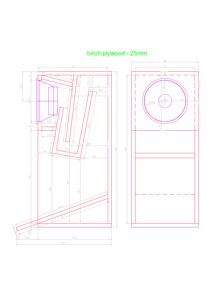

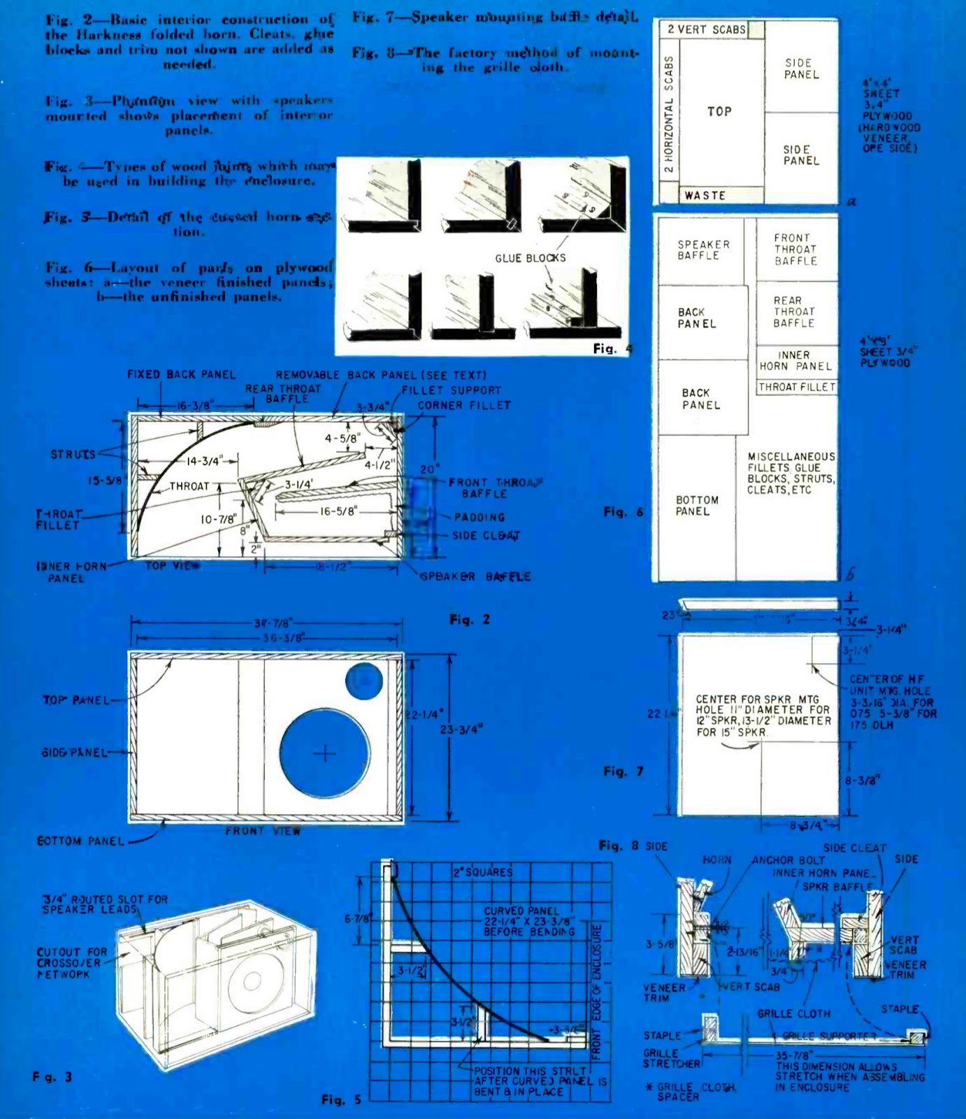

Goodmorning everyone
on Rokikiki's request, I share in the thread a drawing with the dimensions I gave to Chris Templer's TNT project, however it should be noted that these measurements were obtained by redrawing with the CAD "on the" original photo of the Coral project, compensating for the drawing obtained with Templer's statements about his measurements .... so, it is not certain that what I got is exactly what Templer built (and as I said, I wrote to him without ever having any answer from him on the doubts I had .. .).
So take this drawing with the right attention, to those who want I can also send the CAD file privately, so that everyone can make changes or improvements to share here ...
PS: Dimensions are in centimeters, red lines indicate wooden profiles (25mm thick birch plywood) and purple lines indicate Axiom 201 speaker size.

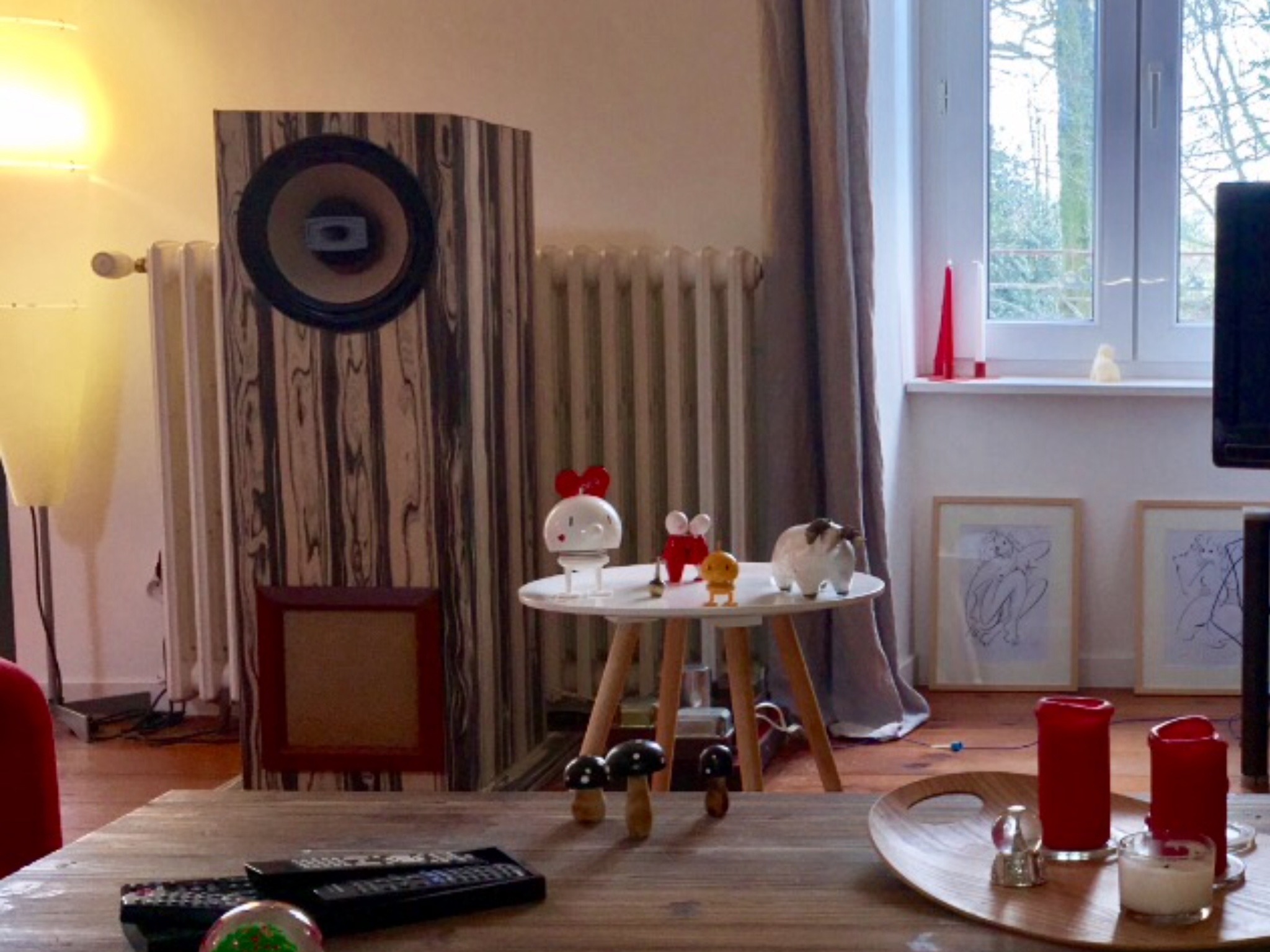

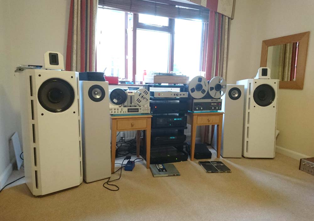

Hi Landrupp
I also have the project of swapping my goodies in Templer’s Iteration of the coral’s.
Did you finally build them?
Regards
Éric

Hello landrupp
These are indeed concentric drivers without the issue if time alignment. Mine are Triaxiom 212c.
Eric

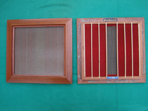

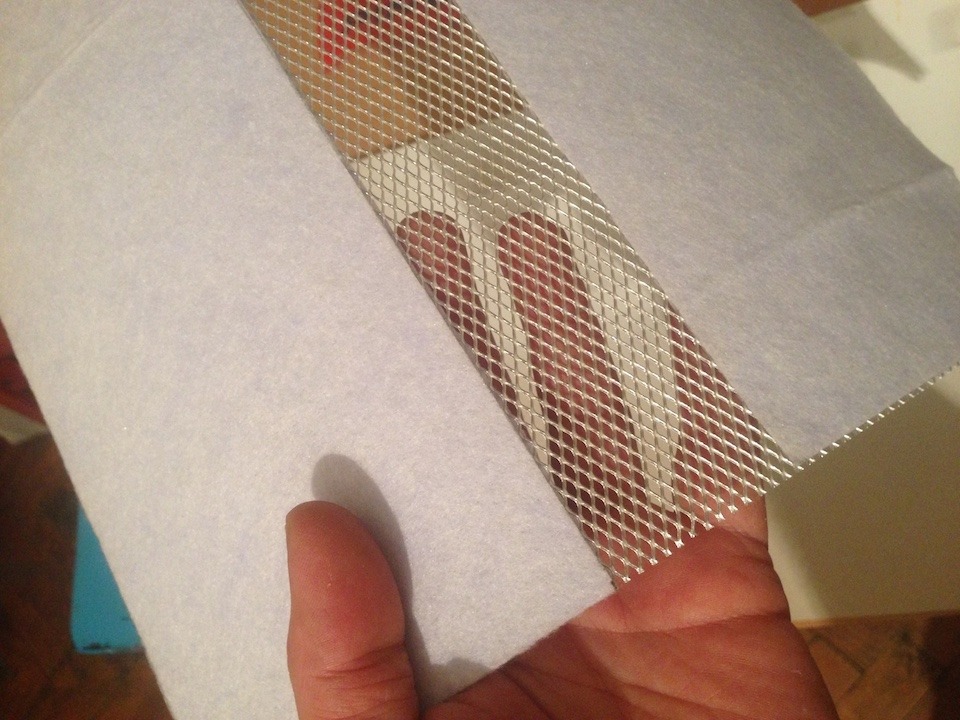

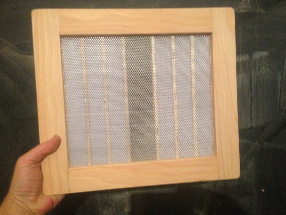

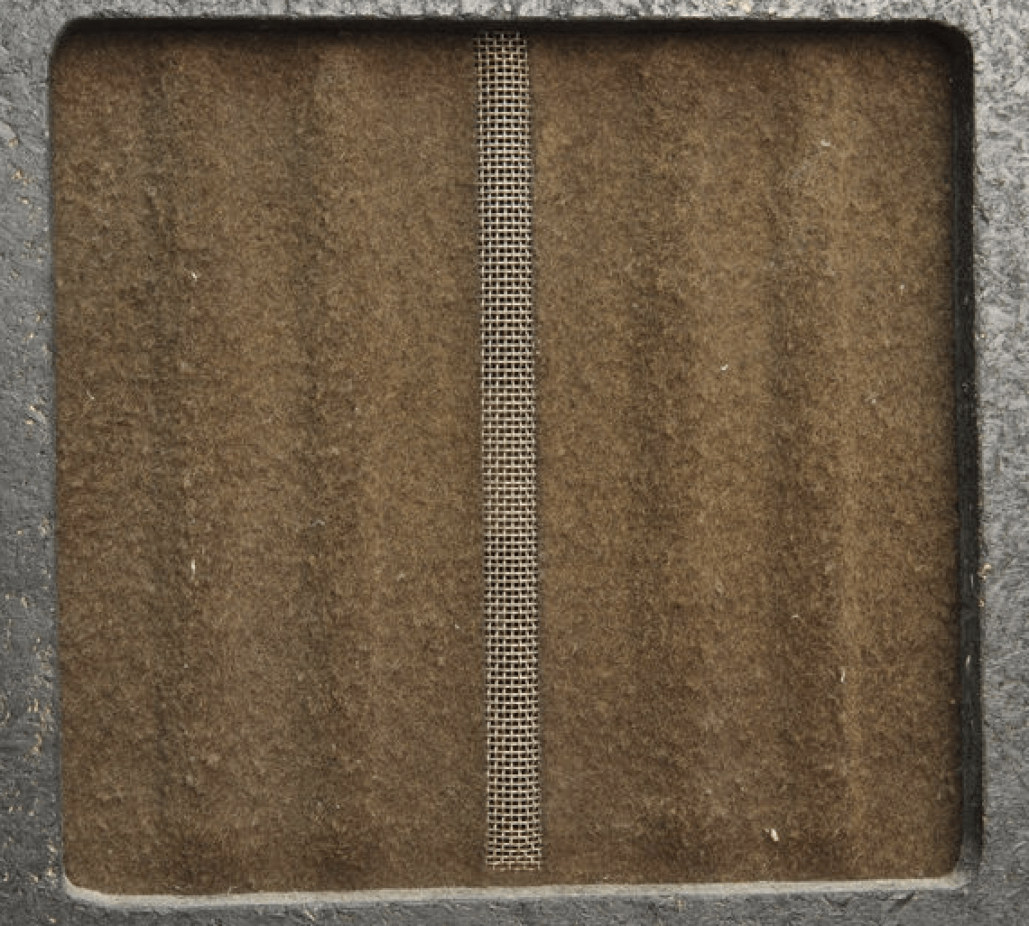

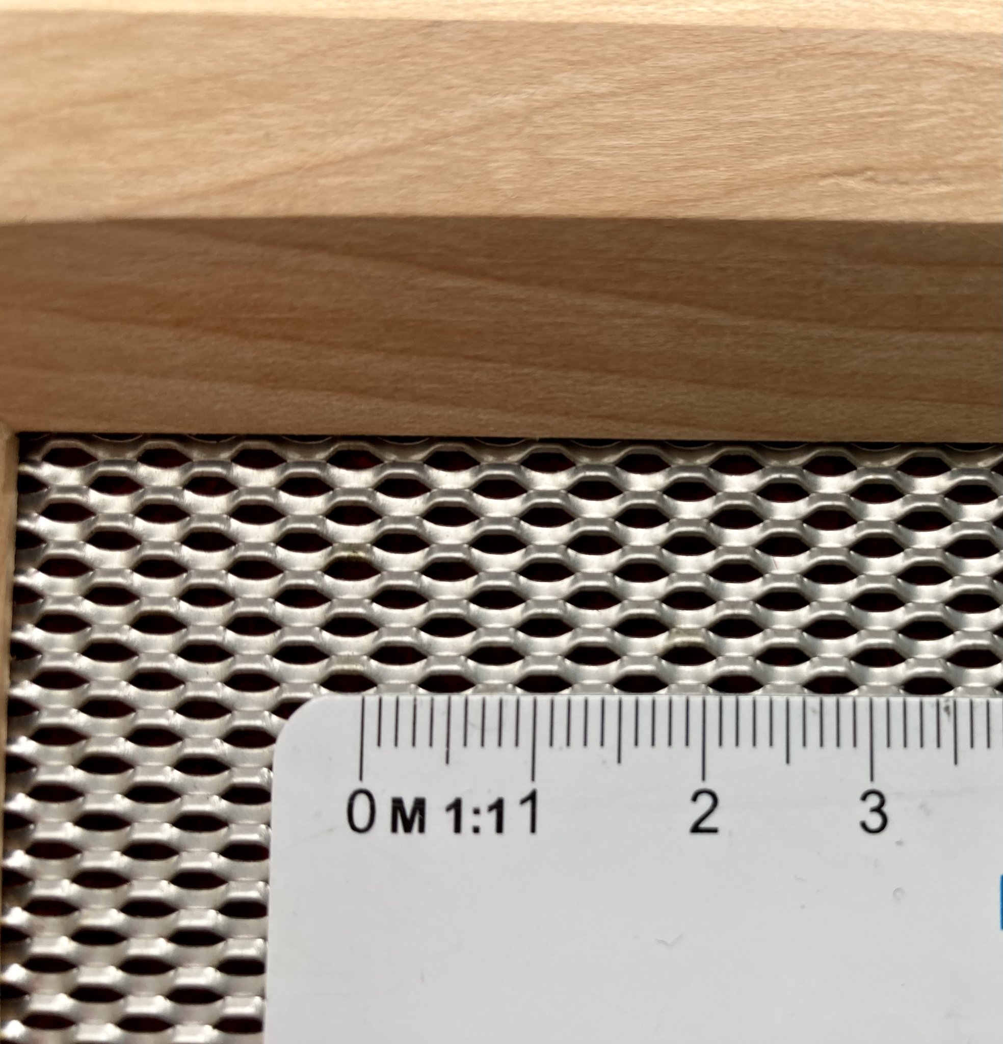

I think that I had this one.
I put the fabric (red) from some material for the kitchen cleaning. 1mm cca. And these braces are about 6mm. I used standard Al mesh that i can find in the stores similar to this. I used clasic neoprene glue to mesh and attach the fabric.
Overall dimensions can be extracted from the hole from original plans.
I will try to find pictures with dimensions of mine diy ARU-s

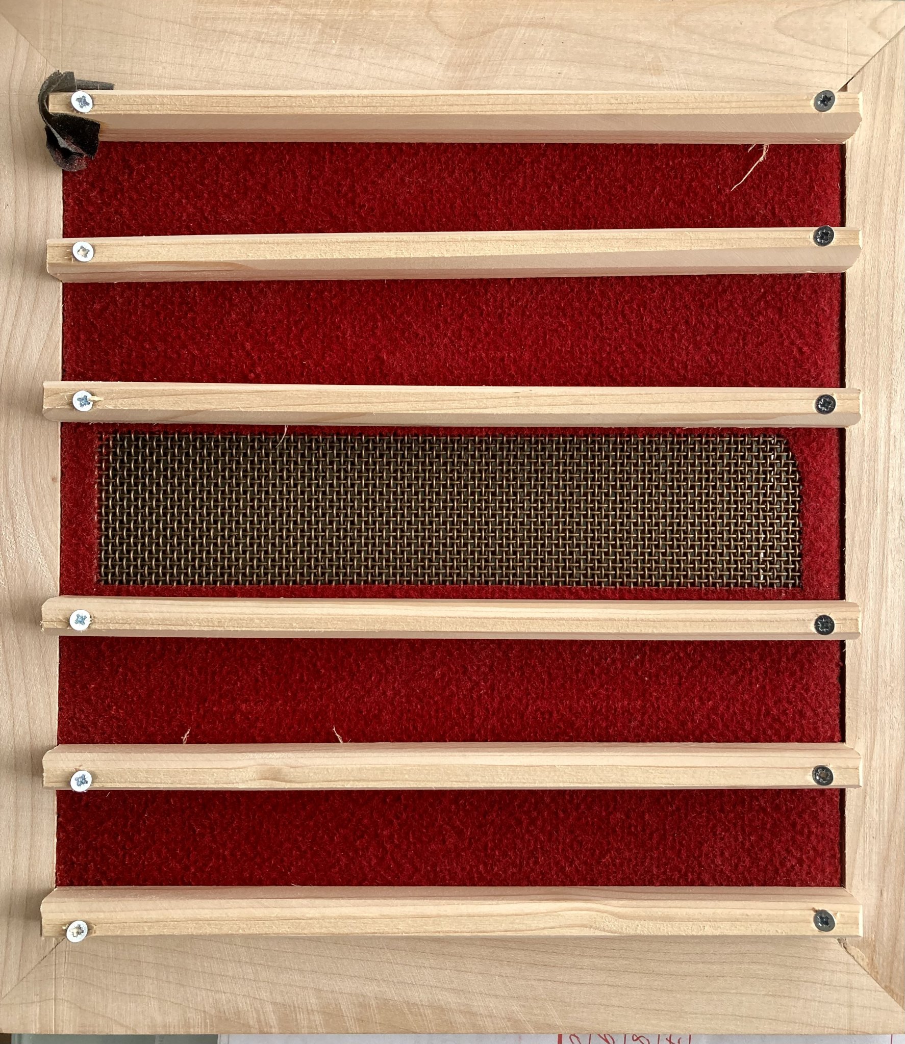

Can You measure the braces and the fabric?

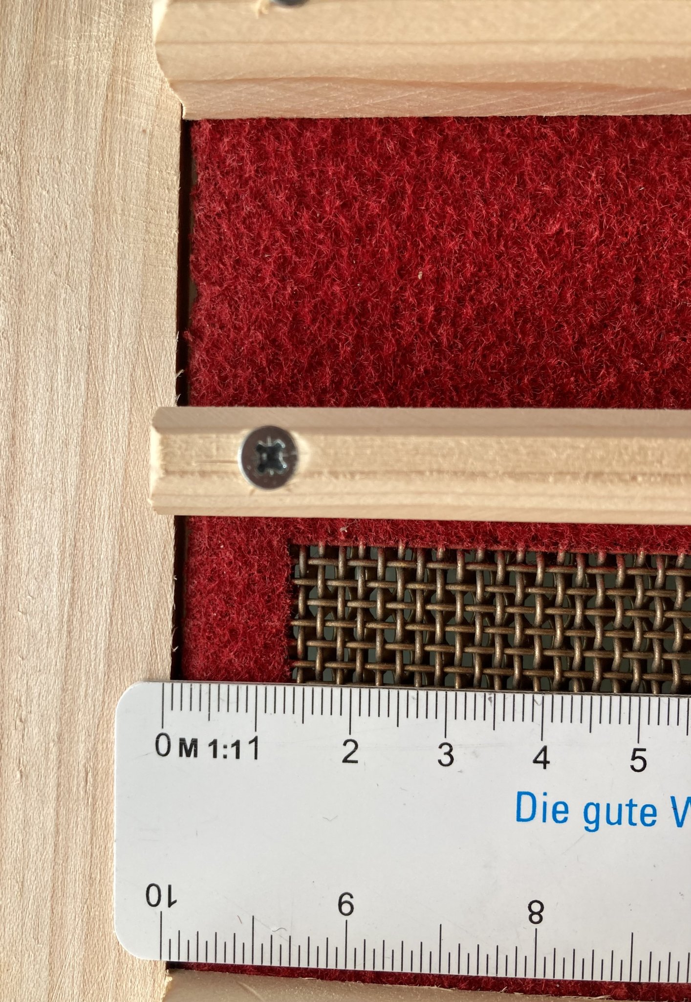

Hi Zoran
The mesh wire is on the backside and on the frontside, there is a kind of ‚sliced and stretched foil‘.
The fabric seems to me a little thinner than 1mm. Probably between 0.5 and 0.25mm.
Eric
Yes the fibric is thinner about 0.5mm as You said.

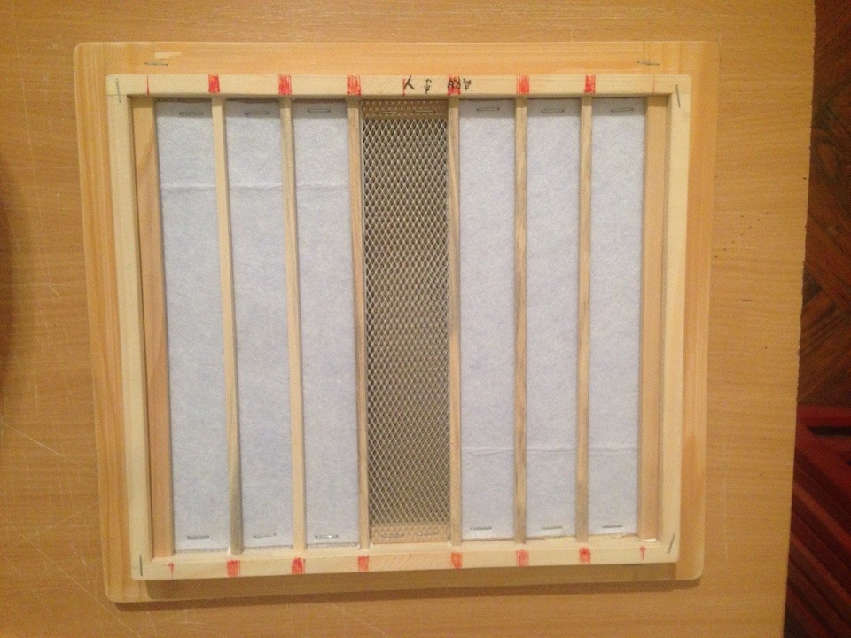

I found some photos of my diy ones...
There are 2 metal mesh inside in mine, the distance between them is 5mm.
As from I can estimate...

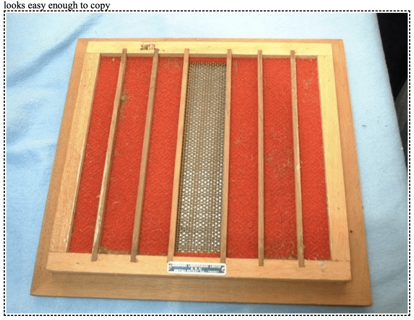

Could You estimate the distance between the outside and inside mesh?
Also another set of braces in the same positions after the inside mesh.
The space in the center cell between the meshes is empty. (As Your photos indicated too.)
But is the rest of the space around the center "mesh hole" empty or filled with something?
And this outside mesh, is the something glued on the surface or is just the "empty" mesh?

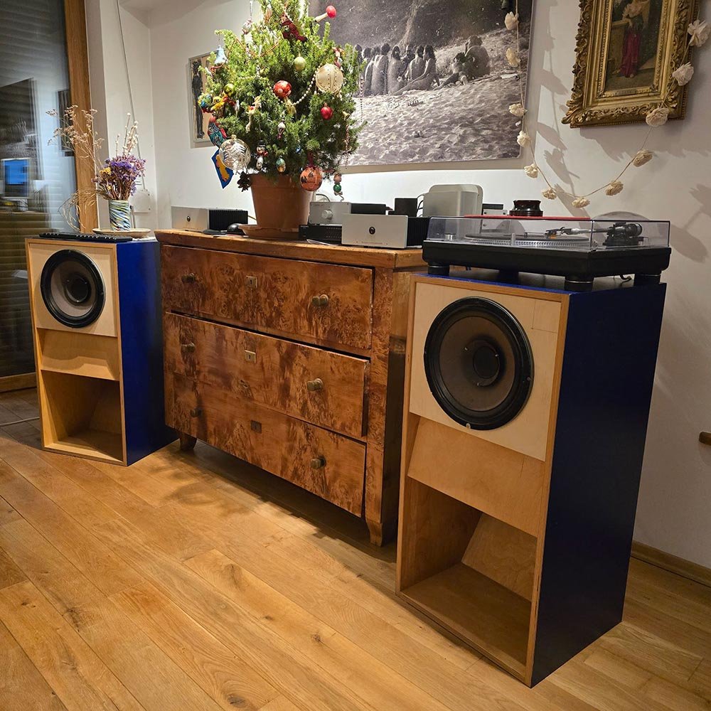

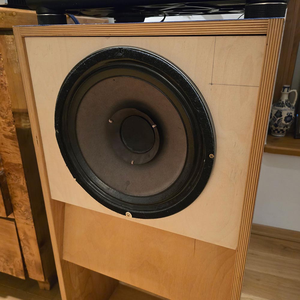

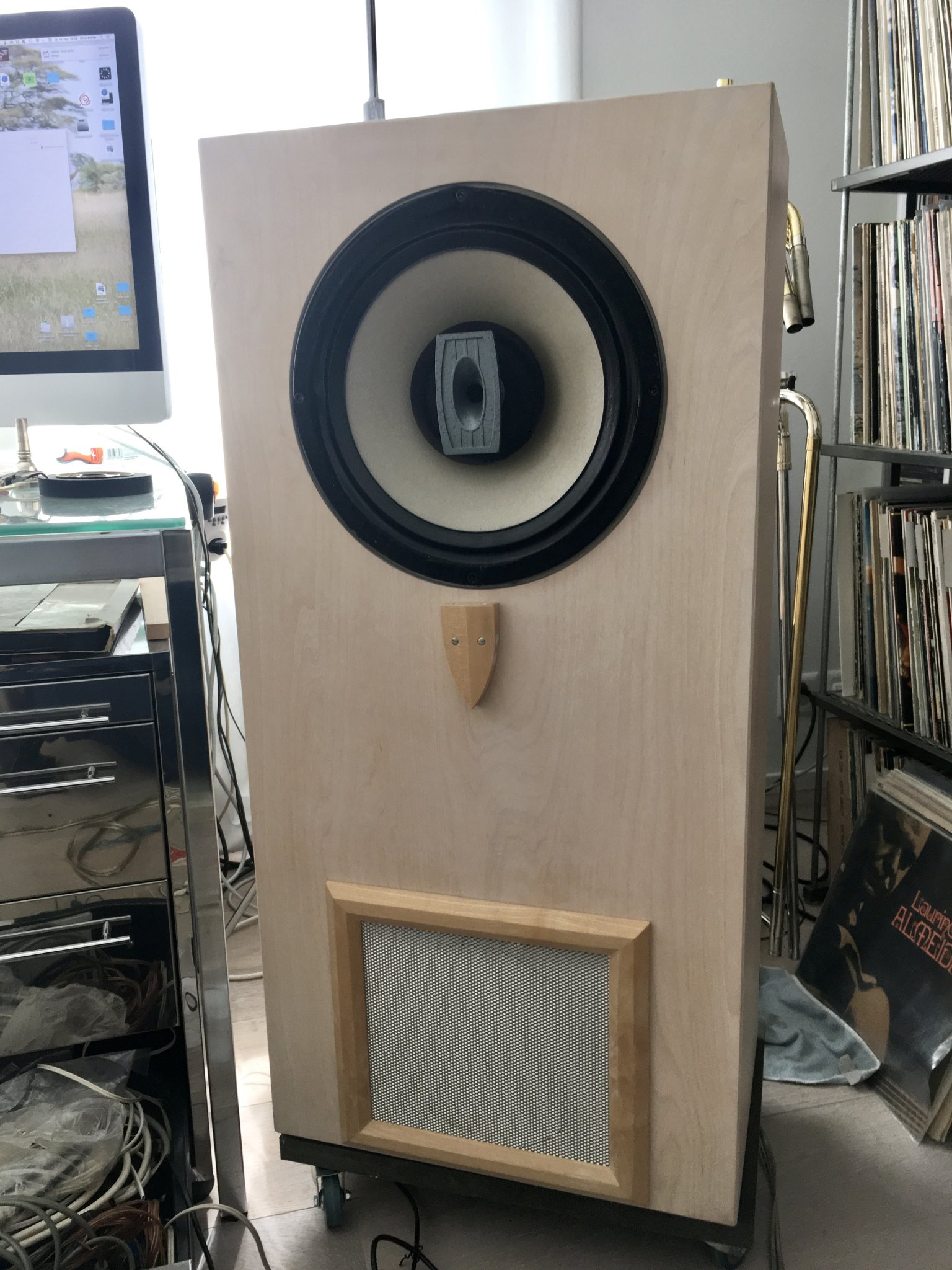

Hello everyone,
It's now five years since Landrupp's first post and also a couple of years since I have gotten a lot of help and insights from you.
Now I can say I am done with this particular project, i.e.
"Using a Goodmans Axiom 201 in an adapted Coral horn enclosure"
By "being done with it" I mean just using the speakers with no intention of further tweaking them.
I like to see stories followed up so I'm posting some info about where all of this brought me:
1. ended up sculpting the back (slanted) wall to accommodate the magnet;
2. doubled the baffle with an additional 18mm layer of plywood;
3. The combined effect of sculpting the back wall of the driver chamber and of a thicker baffle made the unit fit in.
As mentioned earlier in this thread, the cabinets played previously with RTF East German full range drivers.
Now, after the upgrade, these sound amazing, delivering amazing speed, directness, rich bass.
They are of course not flawless, nor are they universal. As expected, they do not do well with large orchestras or super-dynamic stuff. If I would (like my children) listen to Travis Scott, this would not be my choice of delivery. Although, the likes of Andre 3000 or Frank Ocean occasionally sound very present.
There is one oddity: as I have no remote control, when I get close to change the volume (you can see the El Cheapo Chinese ladder passive attenuator) my head is just above the speakers, I hear spectacular bass notes. But this is most likely due to room geometry and some wave bouncing, not to speaker design.
The rest of the foodchain:
MacMini running Tidal -> Denafrips Ares 2 -> Ladder potentiometer -> two Pass ACA bridged -> some Swiss pro cables
A word about the cables: I assumed it would be good to go XLR (balanced) all the way from DAC to ACA but the results are dreadful. My guess: there must be something wrong in the implementation of balanced audio in the chinese passive pre. For now just dropped back to RCA.
Planned upgrade: replace the Chi-Ladder with a Khozmo
There you have it.
It was nostalgic to re-read this thread.
Years have passed - I hope all of you people are healthy and in good spirits and am thinking with gratitude about all the great knowledge I gleaned from you on this thread. See you!
