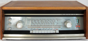

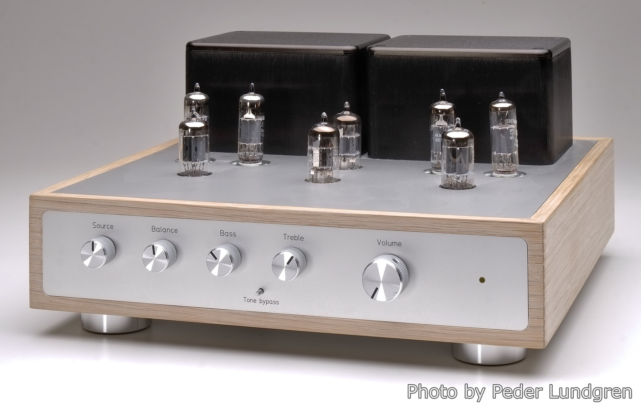

Here is a image of my old/new Telefunken 2550 Opus rebuilt by another friend. This is now sold and playing in another home. The project was named Le Funk for teLEFUNKen.
hi 1669E, i'm in the chance to buy a telefunken opus 2550, can you tell me something about how this sounds with the goodmans axiom and if it's worth investing 400 € to get it? or is it better to look for a newer or different device?
I've always had a love for Telefunken's "steuergerat" ...
PS: lefunk...👍👍👍
€400 for a Telefunken 2550 is a bit high in price I think. If you want to keep it in original that is fine but you have to reserve som money for parts that are bad. The change from an old fine radio, the 2550, to a nice integrated amplifier was another €700 for me but the result was great. Remember it will only give you 2 x 4,5W. There is more options out there an most of the old big radios from Germany got similar nice amps. From 2550 to "Le Funk"

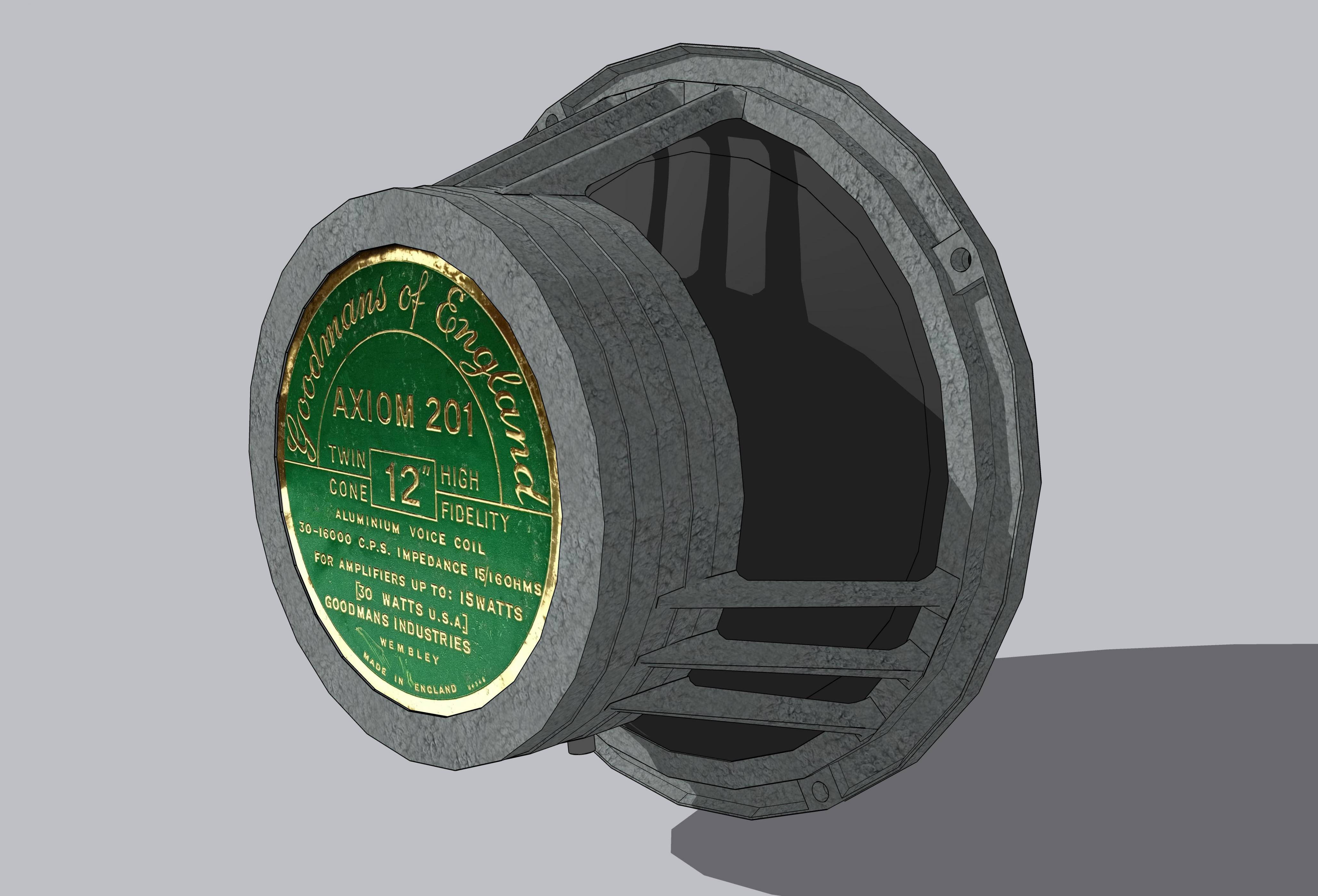

3D model of the Axiom 201 "thin rib" late revision
In the meantime the pandemic rages on and it takes its toll on my psyche, so I spend my night modeling the Axiom 201 in unnecessarily intricate detail.
I meant it as a silly gift for all of you (@landrupp?) that plan on building the enclosures.
Now you can put the 201 in your model, in all its glory.
OK, to sleep now. :)
you can download the model in several formats here:
Goodmans Axiom 201 vintage full range loudspeaker driver | 3D Warehouse
Next: cabinet models based on the info in this thread.

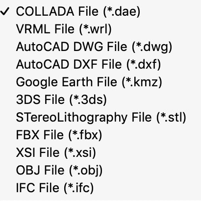

I was wondering if made a 3d modeling using Sketchup you can then export the drawings with the dimensions in 2d in other formats (autocad, basically) ... it is also essential to understand if the modeling makes sense for all axioms or if they are aimed at T&S parameters of each, which changes something in the sense of greater accuracy of the project
greetings and congratulations!
Hi Landrupp.
Regarding sketchup - it's not quite the professional powerhouse for an architect, engineer and so on. But I used it a lot in the last decade. That being said, it is a bit clumsy and the licensing scheme is not the greatest.
As far as exporting is concerned, below is a list of the formats it can output to (limted to 3D, there is also a 2D exporting function as well as an animation export possibility).

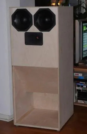

Therefore - a question: I take it that the angled front edges are an aesthetical factor only and they could in theory be flat as well. By that I mean the surfaces with the five vents being flush with the front surface (probably with a corresponding shortening of the hidden tunnels, as this would lenghten them by a small fraction.

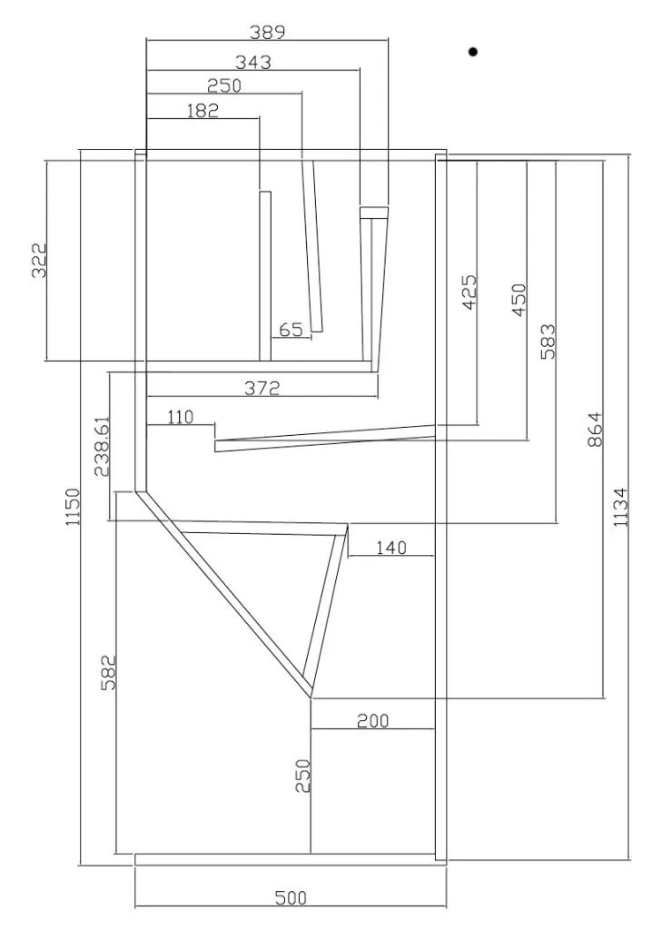

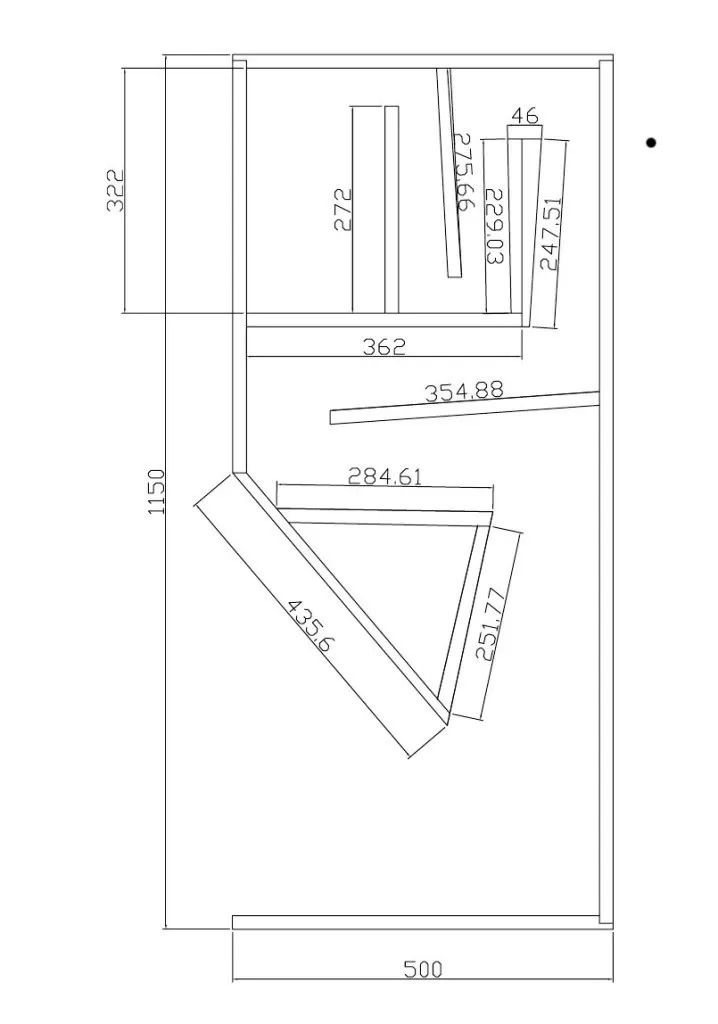

alternative horn enclosure...
On a different note, since we are discussing suitable enclosures for the Axiom 201, I found a thread on a South African DIY forum, with an interesting contribution from Ingvar Ahlberg. I have no way to verify how promising (or not) is this direction. In general the avforum community is a competent and humorous bunch.
I quote the relevant part below.
The whole exchange is available here.
If You decide to go the horn route with those Axioms, please consider this, will be far superior.
Here with 2 8" drivers, same cone area as one 12" so works exactly the same way.
A bit cumbersome to build but, i think, worth every hour. Also larger than the Axiom horn but still tiny.
I originaly designed them for the Faital Pro 8PR200 but they also have been bult with the 12" Beyma Liberty8 (modernised JBL e120)
Beyma 12P80Nd and with two Philips AD9710MC (old Alnico version), that was maybe the best sound for cost I´ve ever heard.
Ingvar
Ingvar's project looks like an interesting option, with two caveats:
1. lack of third party oppinion on an implementation (the Chris Templer variant and the Onken in the photo posted by Dave above have been listened to and described by forum members)
and
2. in mr. Alhberg's project there still seems to be a tight spot for the driver if an Axiom would replace the Beyma's, potentially forcing it all the way to the top of the cabinet (not a sonic problem I assume, just an aesthetic one).

I take it that the angled front edges are an aesthetical factor only and they could in theory be flat as well..
The big chamfer is very functional. The Axi-Ken is a rectangular MiniOnken, the trapezoid version takes things even further as far as diffraction signature minimization.
It can be left flat, but some changes need to be made, and the box will become more sonically visible.
dave
