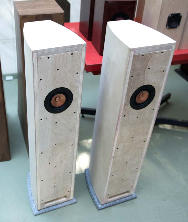

rokikiki, few things one can do with loudspeaker lools: hide them into a wall or as part of furniture. Camouflage is another trick, paint in the same color as the wall behind.
Looks and audio quality are kind of trade-off, but loudspeakers are full of trade-offs so it is just matter of choosing to optimize the looks and be happy with the audio quality.
I think the biggest advantage of DIY audio is to optimize the looks and I want speakers to disappear 🙂
Hi tmuikku, hiding in the walls is a good idea, others have pushed the envelope in this matter. For me it's too late, my walls are like Saddam's bunker (I live in Poland, we are crazy about house solidity here).
Dave, those look great! Wow. Are they designed by you?
I try to imagine them with a single 12 inch driver and they might be just wonderful! I think I also get the principle of pushing the edge as far from the sound source as possible while softening the relief (and curvature) surfaces.
As for translamination: I was just mentioning it as an alternative idea. In fact, photos like this one show you how wasteful this process is. Not only because I have to exist on a teacher sallary but also respect for our planet kind of elminates this solution. One would have to waste sheet after sheet of MDF or plywood to use this solution.
I think I remember an Australian speaker review on six moons where they described a curved surface as being a laminate of jaccaranda wood with a lead insert for sonic neutrality. Perhaps this would be a killer option for such delicately curved walls. I mean the lead sheet insert, not the finish.
PS: here it is: 6moons audio reviews: WHT PR1
Various materials in multiple layers are used to line the internal walls including lead lining, bitumen and a special lamb's wool cloth.
Yes, i designed it (as a stretched polygonal prism) Chria decided that real curved panels would be better and it would give him a chance to play with vacuum bag work.
The concept of the design could easily be modified to hold a 12” helper woofer. The box volume in these for the 2xSDX7 is quite small, something like 35 litres, making the box deeper would quickly increase the volume.
The top slice is the midTL for the midTweeter, the volume below is sealed for these woofers.
The curved panels from these were also used to make a set of Pensi7 with curved sides.
dave
