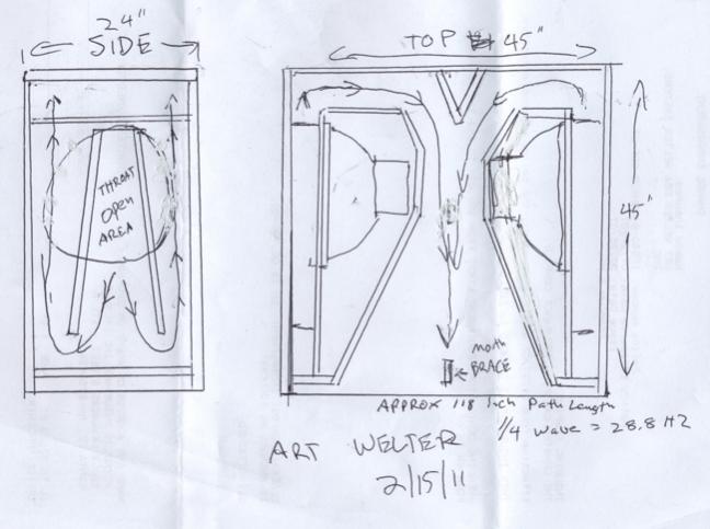

For a TH, the folding scheme of the Apache MK 2, Screamer's Fury, or Jbell's Stadium all are viable, if made long enough to do 30 Hz .Hi

If you could go to a 24 x 45 x 45 inch ( I'd avoid 48 inch unless using wide body semi trucks ) size you could use something like the FLH diagram I just scratched out. The 21SW115 is a rather deep speaker, it would be a squeeze.

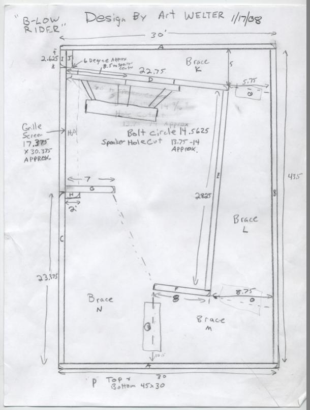

You could also use my B- Low Rider design, it gets down pretty well flat to the Low B (32 Hz) using Peavey low rider 15s, a very good inexpensive speaker. It is a 2 x 15 design, but a 21" looks like it would almost fit.

Ordered a pair of B&C 18SW115-4 from Pro Sound Service yesterday, shipped this morning.
My build will probably be 26.5” by 22.5” x 45” tall cabinets, slightly more volume than the TH-118.

I'm happy that somebody takes up the bifurcated throat coupling that DSL used in their DTS-20. It is way underutilized. I had it in my guess on how one may fold enough horn into the space of the TH-115, but was told that what I had there was just too difficult to build. Probably a valid complaint as I carried the bifurcation around a 90 degree bend, yours looks just fine to me.
As you are now experimenting with Hornresp you may try to couple the driver to the throat through a throat chamber and a coupling duct (e.g.: 6"Dia. 1.5"-20"long) into the horn throat (S1=S2, L12=0.1"). I have on paper produced tapped horns w/ an amazingly wide frequency response, especially in groups of four. This design changes the driver loading quite substantially, the only question is the restriction at high volume levels.

The "bifurcated throat coupling" goes back as far as I can remember, just another folding trick that works well when the extra depth of wood in a "normal" zig zag won't work due to various restraints. The wood can add up to a lot of internal space, the smaller the cabinet, the worse the effect.Hi weltersys,
Thinner wood would help, but 3/4" is the minimum I'd consider with over 3 horsepower input.
I have been using a throat duct in my sims, in fact just figured out the actual volume in front of the BC18SW115 cone, it is a big deep cone, the "flat piston" assumed by Hornresp ignores that area and the cabinet's baffle wall thickness.
With the speaker on a 3/4" baffle, that enclosed volume is around 7.685 liters, .27 cubic feet, before any ducting is employed, the volume of a small ported enclosure!
