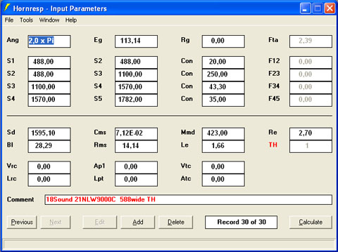

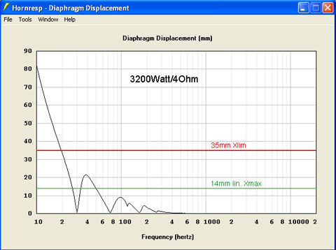

Guys, if you really considering going that low with a TH don't forget to look at 21" size drivers. They often fit in the same TH cabs but have advantages over the 18’s, better physical handling, better Xmax/Xlim, much lower power compression in low freq and higher SPL at low freq…
For instance load your TH cabs (the 400 liter one from the few first posts) with an 18Sound 21NLW9000C and you can feed it at least with double the power over an 18inch. You will gain at least 3dB but in reality more since HornResp doesn't 'see' everything...

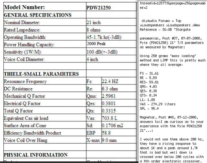

I don't seem to remember cheap being one of the criteria of the iron law. 🙂 How about the Pyle PDW21250 (at least it's affordable):
Buy Pyle PDW21250 21" performance optimized high power subwoofer for $169.95

I know Epa, these are expensive but:
1.) Can handle the same SPL with 2cabs instead of 4cabs (so what is expensive?)
2.) Lower pwr compression
3.) Better physical handeling especially at the lowest octave
4.) Much higher crest factor so damage will be more a case of the amp than the driver!

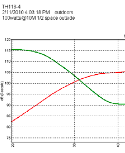

Oliver,Hi epa,
How about B&C 18SW115? Four large TH's should get you there.
Going with the DSL TH-118 (loaded with a B&C 18SW115-4) as a benchmark, it is 101 dB one watt one meter at 30 Hz.
Assuming the driver would stay under Xmax at 4000 watts, that would put the 30 Hz peak output for a single at 127 dB.
Add 12 dB for four, 139 dB at 30 Hz with 16,000 watts.
My meat computer says they will flap at less than half that power at 30Hz (below the driver’s Fs), I think 136 dB might just happen, but would still exceed Xmax.

Hi epa,
Found a thread a while back that listed the T/S, see attached file.
Huge disparities between Magnatar's and the manufacture specs, but as they rate it 45-1.7Khz, and it only has 9 mm Xmax, not a contender for big 30 Hz action.

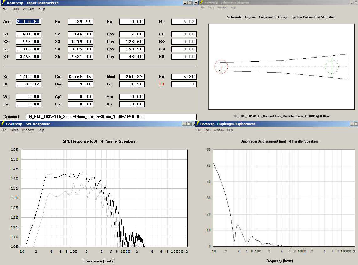

Hi weltersys,
I only did a quick one on the 18SW115, ended up rather large, but the output is very impressive. Have not tried to draw / fold it.
Thanks.
I'll have to look at that more closely.
One thing that concerns me about Hornresp is it shows Tapped Horn LF corner dropping in multiples, while Danley has stated, and shown plots where they do not.

actualy your driver mathematical x-max is 14mm (10% distortion point)
with 2 cabs you reach 135 db @32 hz ,witch is verry nice,but you wil get near 140db with the 4*bms.

Way back in post one my original sim that was transferred over from the Wood1y RCF 15 thread has a s2 compression of 2.28 : 1.
What do you guys think is the highest compression ratio that can be used with a 18" and a 21" driver before the cone rips apart?
Martin, Like Soho says it really depends on the driver. A modern driver (with suitable horn specs) with an Xlim that is at least 2x its Xmax is often build to last (although don't use this as a rule). But you have to use a driver in practice to see how the driver will hold up in a horn. As Epa seems to be worried about the Xmax of the 18Sound 21" I prefer to look at the driver's Xlim and how the cone, spider and basket are build up (and how it handles heat under heavy loading). In my experience good engineered drivers (and that’s why they cost a lot more) will stand the physical pressure from horn loadings when they need to exceed their Xmax… That’s why I’m not worried to load an 18Sound 21” (Xlim 35mm one way) in a TH with a bridged labgruppen FP6000Q (3000W/4Ohm - Bridgedchan).

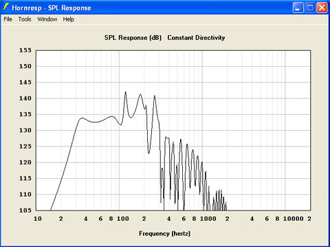

remember xco1 600 ltr cab got to 140 @30 hz with 4.

Oliver,

Aaaand you're still at it - right after the Furysub build! Glad to hear!
There are some models w/the 18SW115 in wood1y's post at the bottom of http://www.diyaudio.com/forums/subwoofers/170749-15-tapped-horn-rcf-7.html page. I believe I used B&C's posted xmax values, so spl should be 'slightly' lower if using the calculated xmax (~2mm less). Keep us updated with your progress!
Hi weltersys,
Yes, looks quite good! 🙂
Way back in post one my original sim that was transferred over from the Wood1y RCF 15 thread...
That still is a very nice design, btw. Kudos.
i was thinkin about that 2 jason.Way back in post one my original sim that was transferred over from the Wood1y RCF 15 thread has a s2 compression of 2.28 : 1.
i tought 2:1 was max for 18",so i figured for 21"it would be even less.
i did some modeling with the pyle driver,its usable and does move air.Hi epa,
Pyle Pro PDW21250 21" High Power Subwoofer | Parts-Express.com
few concerns about that diver are,we dont know all the ts parameters and i dont know how they handle real pa work (allu vc former?).
that said ,from experience i'd go with a pro driver,its worth the extra money,especialy over time.
we don't even know how the x-max is caculated,it might as wel be 9mm peak peak,or 9mm x-damageHuge disparities between Magnatar's and the manufacture specs, but as they rate it 45-1.7Khz, and it only has 9 mm Xmax, not a contender for big 30 Hz action.

with the bms driver you need 4*600 ltr cabs each fed with 900 watts,to get 140 down to 30hz
if you want smaller cabs,you have to set your goals a bit lower.
any thoughts about that trailer idear?
for the bms,just email that site,simple. and then you know what they cost.make sure they sell the v2 version
8 * eminence 3015lf
if i remember correctly , they are 350 ltr cabs fed with 200 watts for x-max
http://www.diyaudio.com/forums/subwoofers/170749-15-tapped-horn-rcf-9.html#post2372410
400 ltr actually not 440.
138 db
138 db
