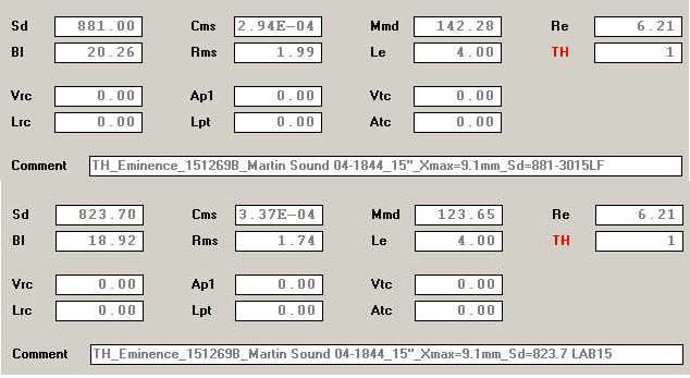

T/S for 151269B Martin Sound 04-1844
This is what I came up with using Hornresp to calculate the missing values. I picked Le=4mH, and tried the Sds from the LAB15 and the 3015LF. There are some other threads out there using the same woofer, and listing a Vas=16.27ft^3 (instead of 11.5).
tnx tb i found that tread and corrected ts in the post above.Hi,

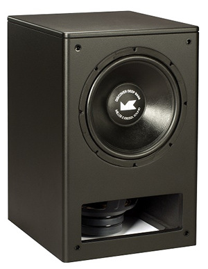

"And my last question, if the two drivers have both a separate (independent) box but the drivers are still aligned in push-pull configuration does it still work as a push-pull system? "
Probably not as well.
The back volume needs too be common, as well as the front cavity.
M&K did a common back volume with the drivers on adjacent sides of the box, it got distortion cancellation, but only in the bottom octave.
http://t3.gstatic.com/images?q=tbn:ANd9GcQDz57blKA2EIJGmX6bXARAH_7PkpjXGa7JRQCd9cKbyW2DtXz8&t=1
