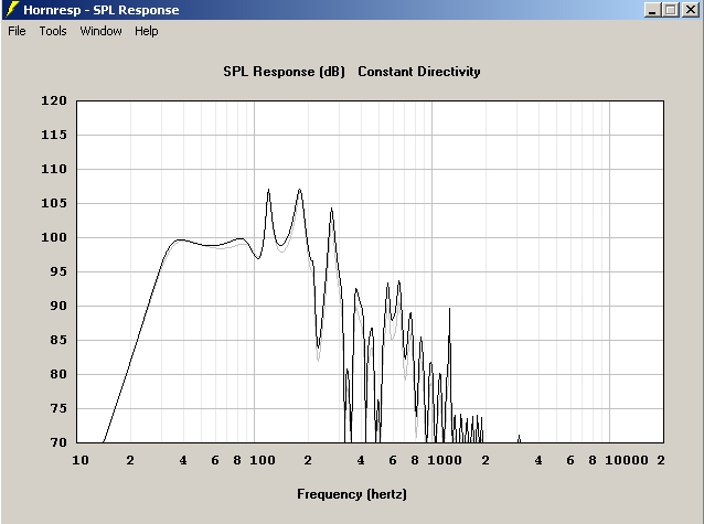

To clarify the point I asked the best way to simulate this in the Hornresp thread. (Post 1500)
http://www.diyaudio.com/forums/subwoofers/119854-hornresp-150.html
General consensus is that the coil resistance should be added to Rg, and the coil inductance added to Le...
This does make a difference.
Screenshot shows sim in post 21 with 4uH 0.72R inductor in grey and 2.5uH 0.38R inductor in black.
Maybe a tweak to the design is in order? Assuming that Crescendo hasn,t committed anything to a build yet! 😱

yes i saw the difference.
the 2.5 mh syms better.
its strange that adding resistence should interfere with the freq responce in that way,but its the general concencus.
dont think we need to tweak the design.
most of us think that responce wil be flatter anyway.
imo the coil is the last thing to worry about if needed at all.
it can always be added later.

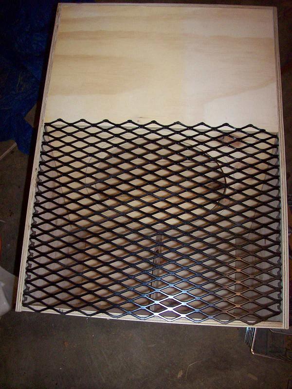

Also, what material is recommended for the grill? Any pictures or part #'s?

i got a piece of 1.8mm(.0709 inch) steel grill ,that's strong enough for some drunk ashole kicking it,and it doesn't resonate easy(provided its mounted securely).

i wouldn't use a alu grill,remember its to brace the side and bottem pannel.
i think in this case 1 kilo extra shouldn't be a problem.
