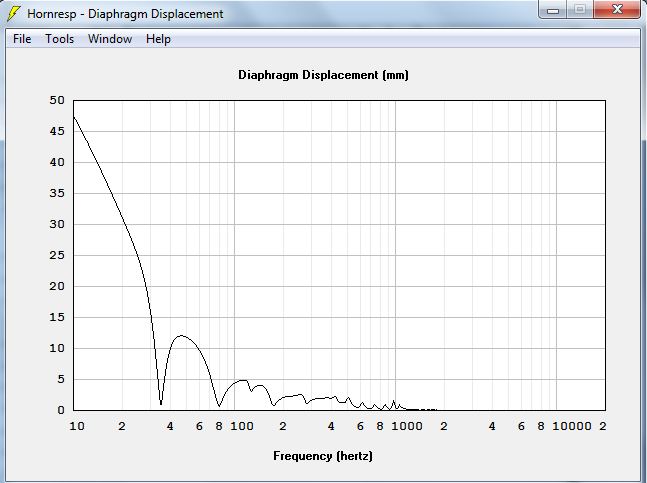

1st rms value =6.62 mmd =247.57.
le value is usually double in the 30>100 hz region =4.2.
if i am correct l2>l3 =208 ,l3>l4=98.
but jason(xco1) wil have to confirm this.

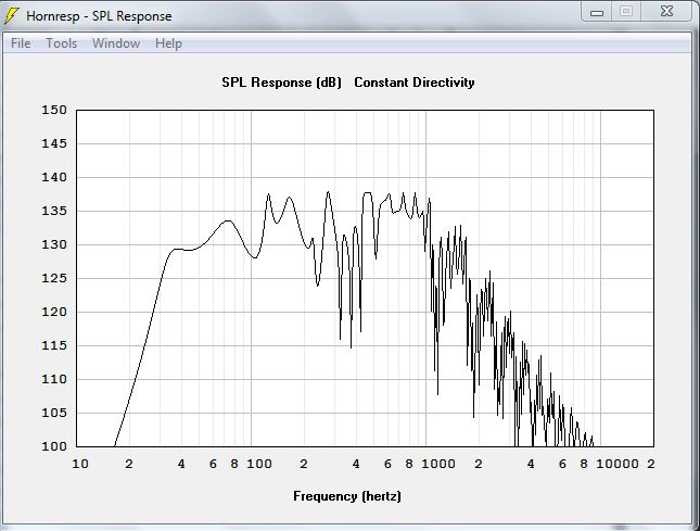

I REENTERED THE DATA AND HERE IS THE SPL RESPONSE CHAT,IS IT OK OR DOES IT NEED TO BE A LITTLE FLATTER?
ALSO WHAT DO YOU THINK THE USABLE FREQUENCY OF THIS BOX WILL BE.

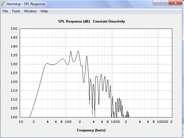

you capslock is on 😉I DOUBLED THE LE AND THIS IS WHAT I GOT
its usable from 32>100 hz maybe higher,but @ 100hz fase and delay are still good,above 100 hz its not so good.
use highpass linkwitch 4th order @25 hz or butterworth 4th order @27 hz

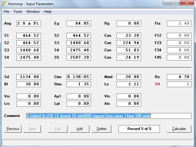

the inner pannel width shrinked to 54cm,101.1 high,40.3 cm change to 36.1 and 440 (s5)change to 39.8.
s4 becomes 37.95
the rest remains exactly the same.

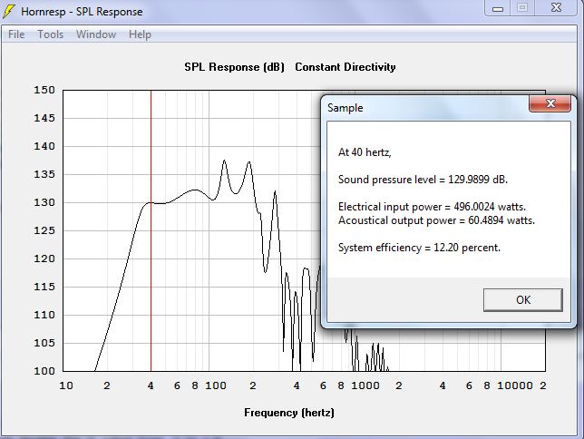

this is what you get.
the gray line is original jason's plan.not much difference as you can see.
hpf should be butterw.28.5 hz or higher 4th or (prefer) 8th order

so basically this mod and the original 15 by woody1 have just about the same spl ,just that this mod extends to about 34or 35 hz
yes ,and much more max outputso basically this mod and the original 15 by woody1 have just about the same spl ,just that this mod extends to about 34or 35 hz
