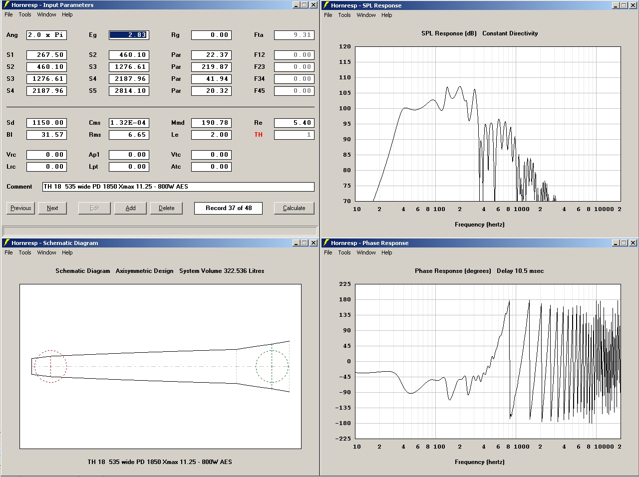

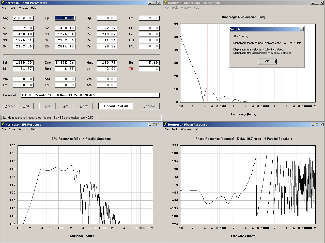

I attach my latest proposal for you.
It is based on the SS15 so I,m fairly confident that it should work OK
The size is very similar to a very famous 18" TH so it should be big enough😱
No apologies for using the Precision Devices PD1850 as this is the driver that I,m interested in using - I have no idea how cost effective they are on your side of the Atlantic!
Still within Xmax at 80V down to 31Hz so a fairly low hi-pass would be OK.
Hornresp info for 1 and 4 cabs also a PDF with more than enough info to make sawdust.🙂

I could be wrong but I don't think the specs listed in the PDF file allow for that sub to be built from one sheet of ply? Not that I'm concerned about that I was just curious
I was careful not to call my design SS but prefixed with TH

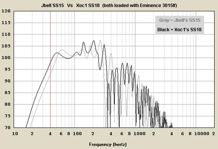

Where DJim refers to it as SS no doubt he is referring to the actual hornpath layout that is similar to jbells SS15. The concept was to take advantage of the SS15 hornpath, that seem to have performance advantages as discussed in the SS Challenge thread, and expand the size. Shamelessly the overall dimensions are similar to the Danley TH115/118.😱 The idea being that this should be big enough to perform well.
As such no compromises have been made to optimise for timber sheet sizes. Instead the dimensions are set for optimal performance. The mouth being almost completely square for instance.🙂
