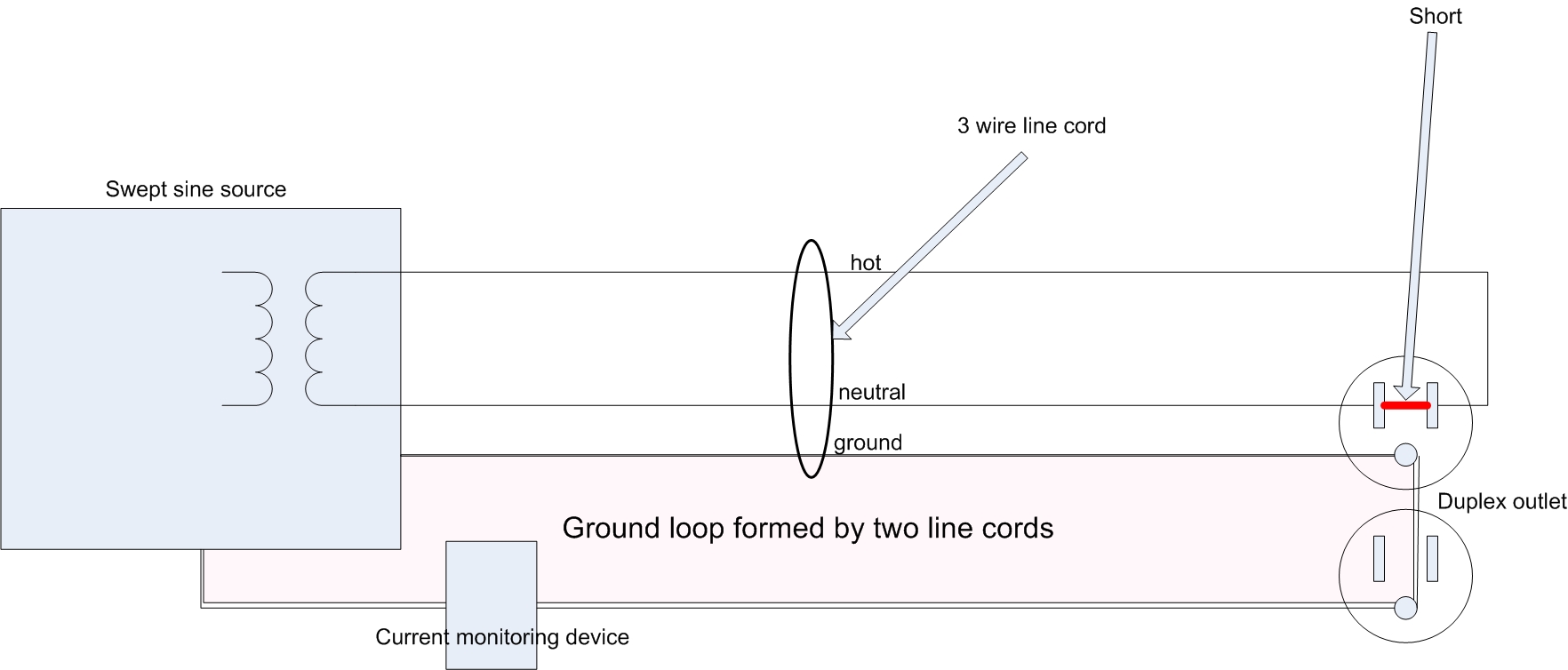

Give me some suggestions on how you'd do that, John, and I'll be happy to give it a fling.
Done.
The pink area is the ground loop which will intercept the line cord flux. Any variation of the external inductance of the line cord will result in a change in the coupling here. Measurement of the ground loop current is measuring the inductive coupling which will impact the reference ground integrity of a single ended audio system, and the currents through a chassis can even upset the internal path integrity of a balanced differential input system.
edit: one could easily break the loop conductivity and substitute a dvm for the current probe, changing it to a high impedance/voltage measurement...but for most systems, the loop is low impedance, and the loop current does fight the flux, consistent with Lenz's law..

What about a ground loop coupling/susceptibility test?
Good lord man! No way was I going to go there without a ton of explanation. This is a can of worms on the wrong bench! 🙂
I assume the end use system design will be code compliant and single ended drives..
🙂 What can I say? Is it possible that that system has mutually exclusive terms in it's definition?
I'd recommend running a swept sine 1 ampere current out to 50 Khz through the line cord
I have nothing available that will generate that unless I build it. SY doesn't either unless he wants to torture an amplifier. Nelson could help there I think.
Given a current source and a 34401
And there's the rub. Given a current source with known characteristics. SY has a 3468A as I recall and I can't remember if it has the sense terminals for resistance measurements. He would have to rely on null only.
To control this, I'd make a test fixture that uses a pair of razor blades for the v probes, and lock them dimensionally such that they are one fixed distance apart, with the current clips outboard of the blades.
I'd run the current into the leads further out. Then you could use the sense contacts at a known distance as you suggested. How many of us can position these contacts to a distance known to the width of a razor blade? Copper bar contacts might be a better plan though, otherwise you'll want to null any contact potential out or keep the temperature constant across the jig. See, now you're the one getting fussy about everything! 🙂
The test is not pass/fail. It is value only.

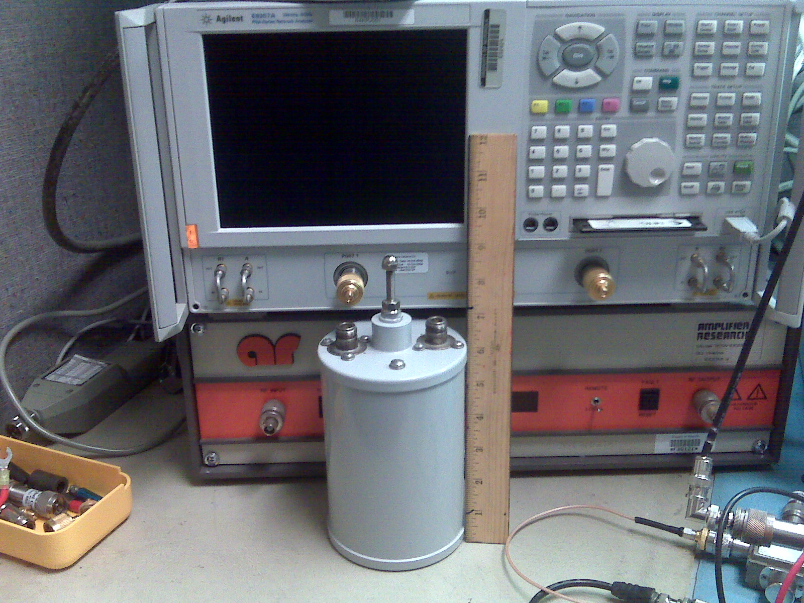

I like the pro RF lab stuff. Look in the GigaHz. Think cavity resonator. I could be wrong on this, but some devices have textbook dimensions. In this case, if anyone can find an engineering textbook describing one, look for a CAVITY RESONATOR...... Should that be a cavity resonator (electromagnetic UHF resonator) - what frequency tuned at, for what reason?
No need to Google, I have a lab full of them. This one covers 850 to 870 MHz. The one for 150 MHz is 3 feet tall. Cavity resonators typically use air for the dielectric medium hence the name cavity. It is possible to substitute a material with a high dielectric constant for the air in order to reduce the physical size. These are usually called dielectric resonators (or some other trade name). In any case a device capable of resonance near the audio band would be huge, semi trailer sized at least. A dielectric resonator using state of the art material for 150 MHz would be about 2 inches long.
If there is any resonance at all in the range of 100 KHz to 8.5 GHz, the network analyzer shown behind the cavity resonator will find it! Is a resonant device in the GHz region of any use to audio when the interconnecting cables are not capable of passing frequencies above sa few tens of MHz on a good day? Maybe....
