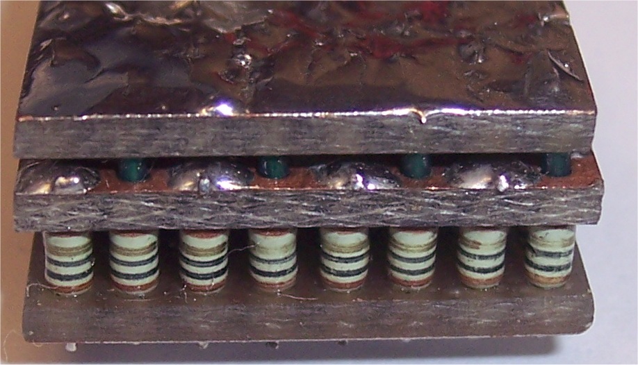

Pics of a CVR.
The theory is this: any current in space creates a magnetic field, right hand rule.
The only way to stop this is zero current. Net zero current. A coax does this, coaxial microwave resistors count on this for net zero internal inductance, but the return current has to go somewhere, and it's that seperation that causes magnetic energy storage.. (note: inductance by definition is the relationship between the current within a system and the total energy stored within the magnetic field.
Another method of zeroing the current is to have the currents flow through each other in a distributed fashion. This is what I do.
In this pic, the current flows in the very top plate (clad perf on 100 mil centers) through one half the resistors. Note half the resistors have a blue insulating sleeve (kynar) keeping it from contacting the center plate. The current goes through half the resistors to the bottom plate. There, the current goes up the other half of the resistors to the middle plate.
Within the distributed structure of the resistor matrix, there is very little stored energy as there is very little magnetic field. If you wished to calculate it, that's easy also. A pair will have about 200 nH per foot inductance. 1/4 inch is 200/(12*4), or 4.16 nH per resistor pair. This resistor has 20 pairs, so the overall inductance will be about 4.16/20, or 208 picohenries.
You will not be able to measure this inductance regardless of the equipment you use.

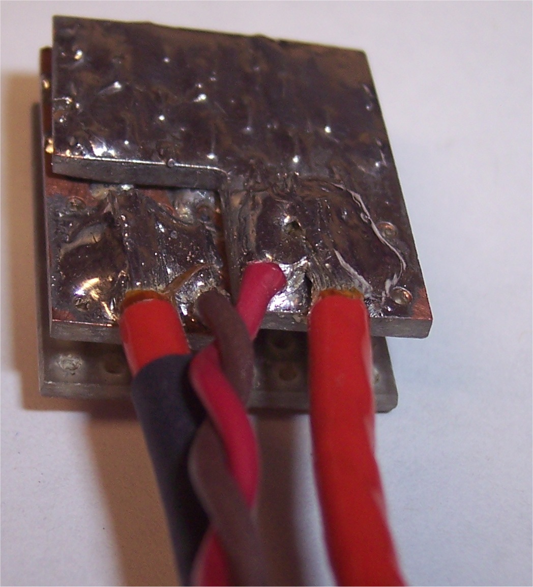

Note in the second pic where I tap for the voltage reading. Also note that this construct has no net external field, so the twisted pair cannot pick up any error from within.

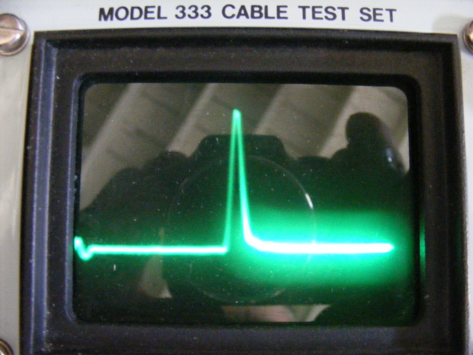

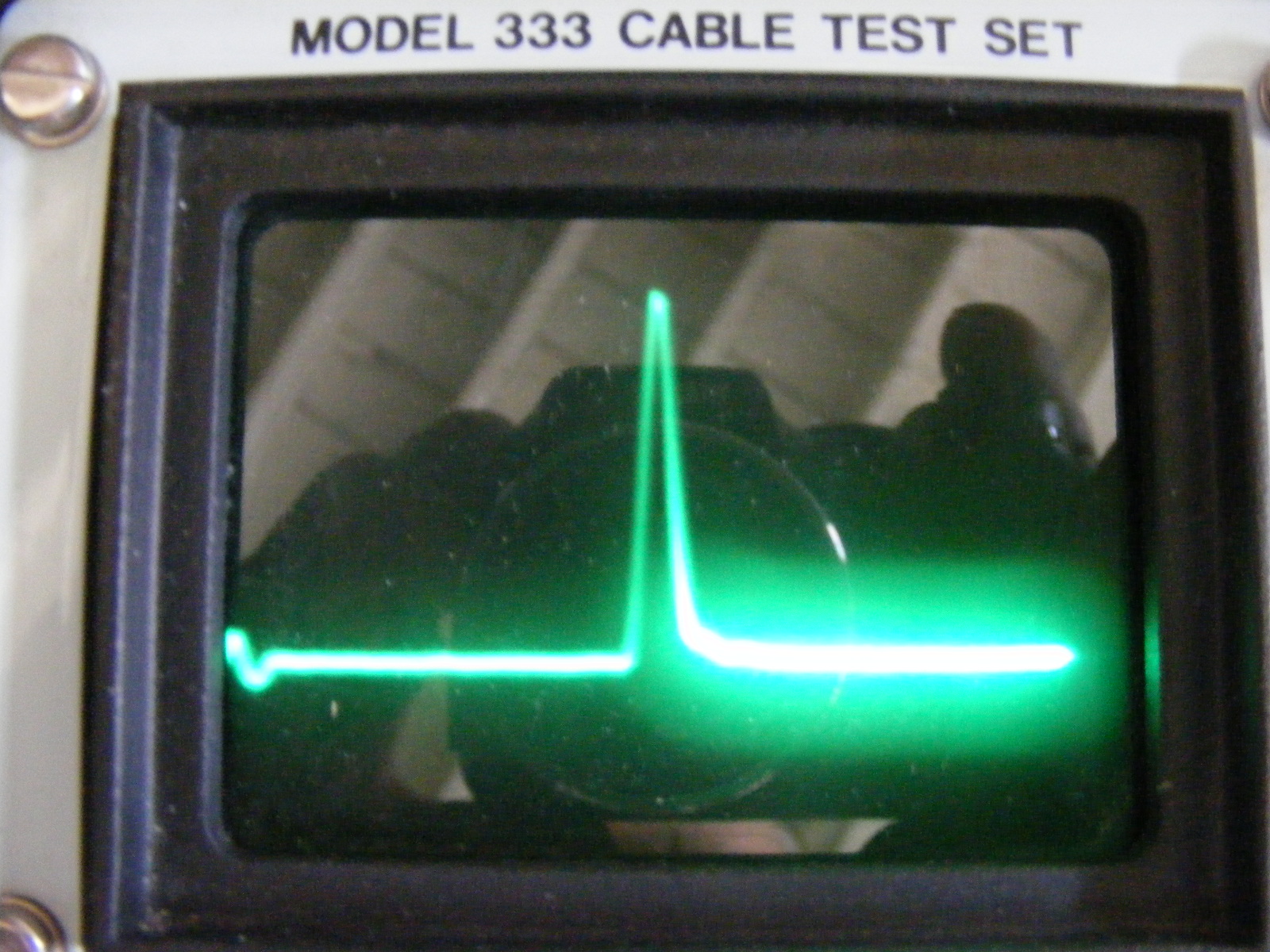

I suspect a more reasonable test would have been to use a Time Domain Reflectometer and seen if the velocity of propagation changed in a conductor.
Just for fun I decided to try my "Macrame" filter and see what it did to the propagation velocity in a cable. I used my TDR and a 75' cable. Attached are pictures of the results (Sorry my TDR is too old to directly provide data)
The brightness to the right is the time marker or reference. It is the same in both tests.
Jan,
The image in the reflection is the most recent picture of me!
