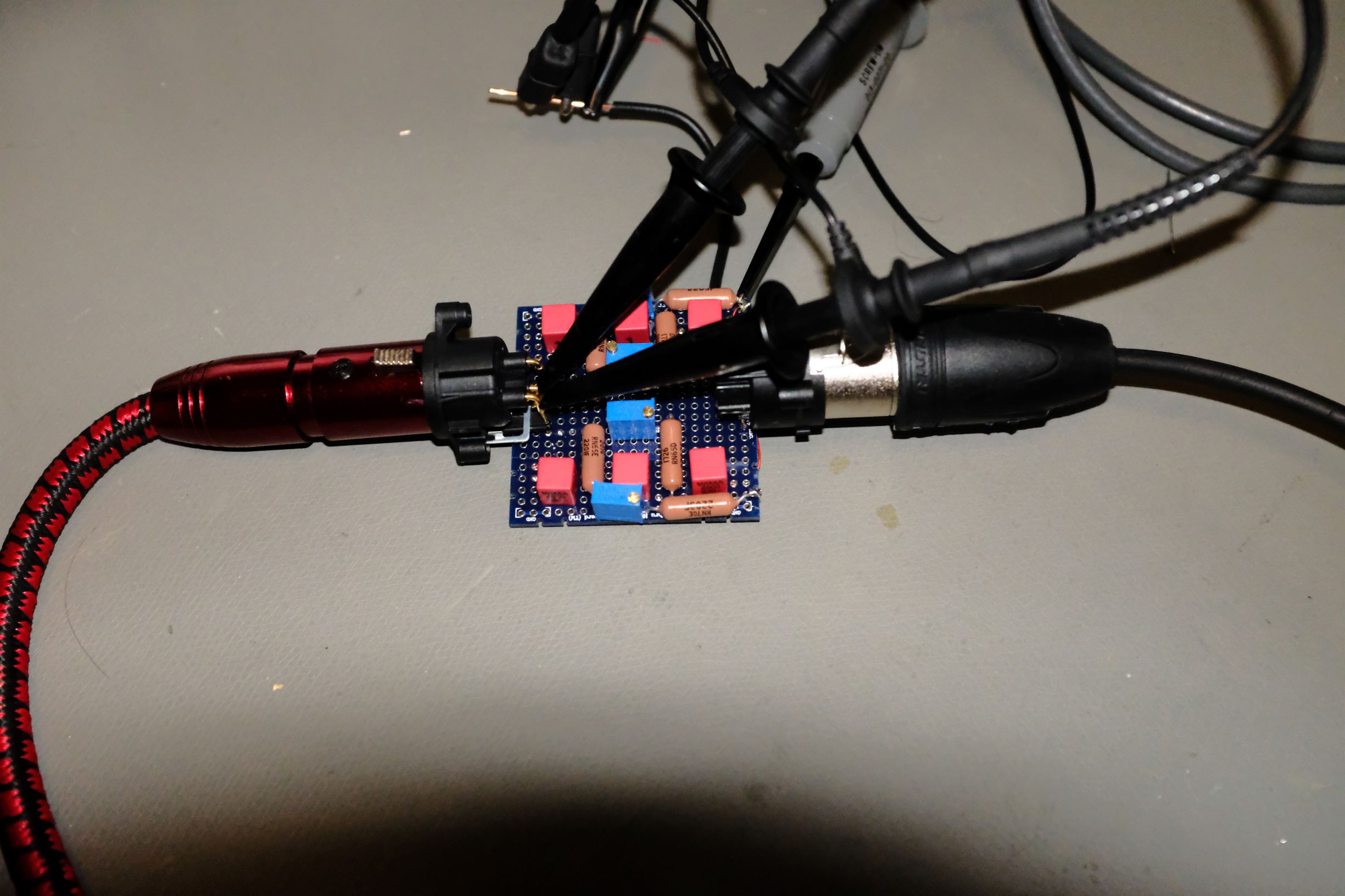

Thank you very much! That was indeed the issue. I have a RME ADI-2 pro FS ,that i thought would take +24dBu = 12 Volt RMS on the Input (I even chose this reference level in the menu), but obviously doesn´t.
With a ten times divider I get 0,1% THD at 6 Volts and 0,9% THD at 13 Volts. Still a little high, but I can go further from here.

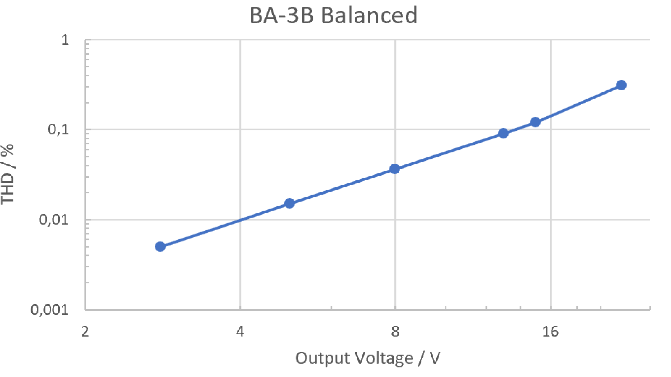

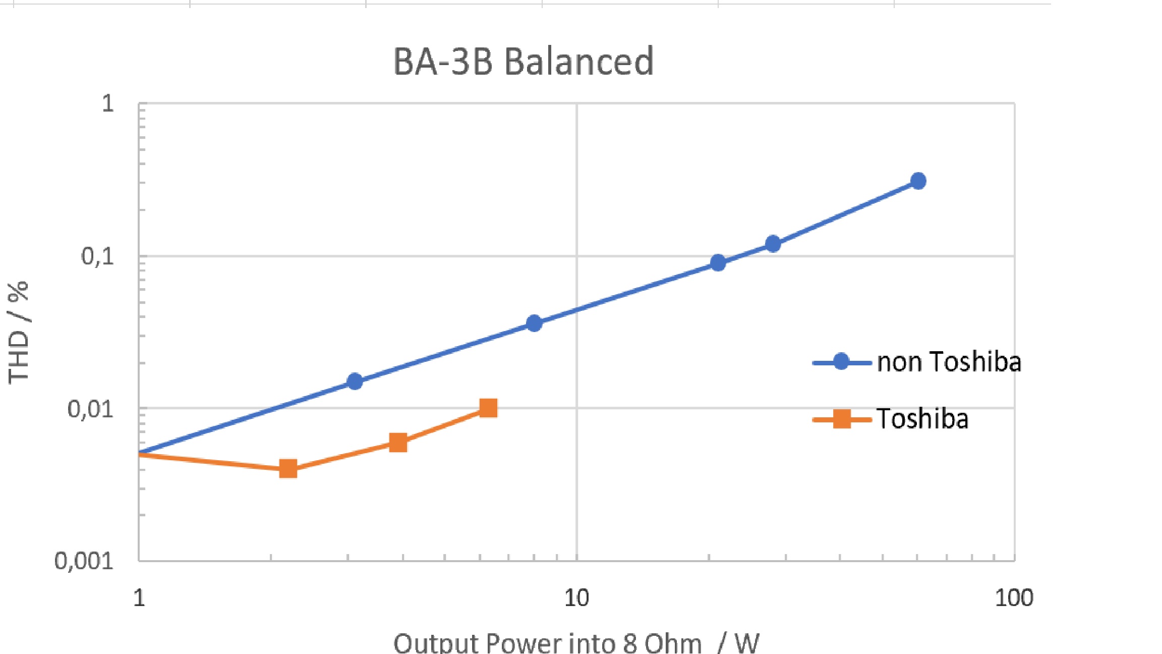

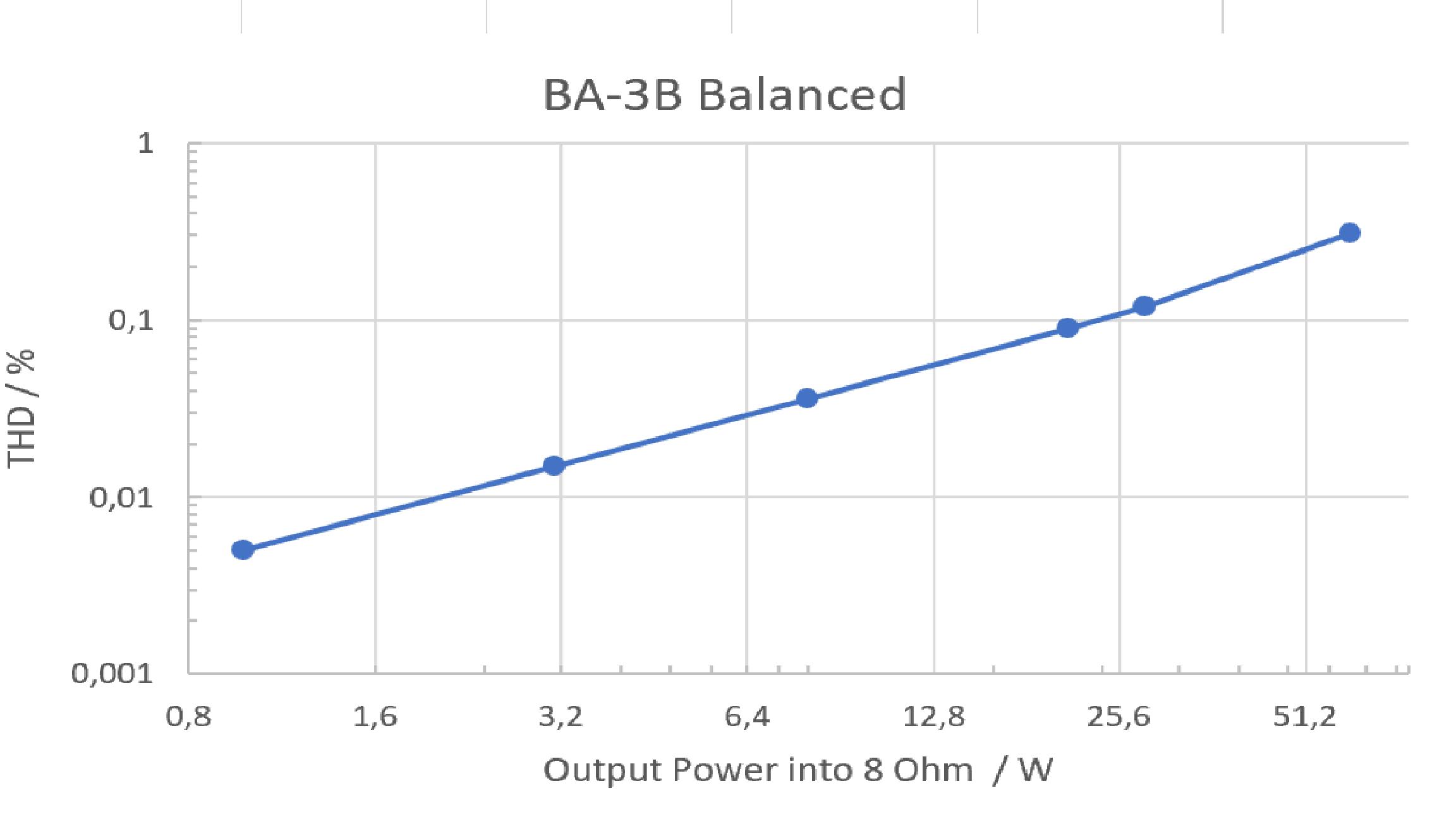

higher Distortion due to JFET/Mosfet or too dumb to measure?

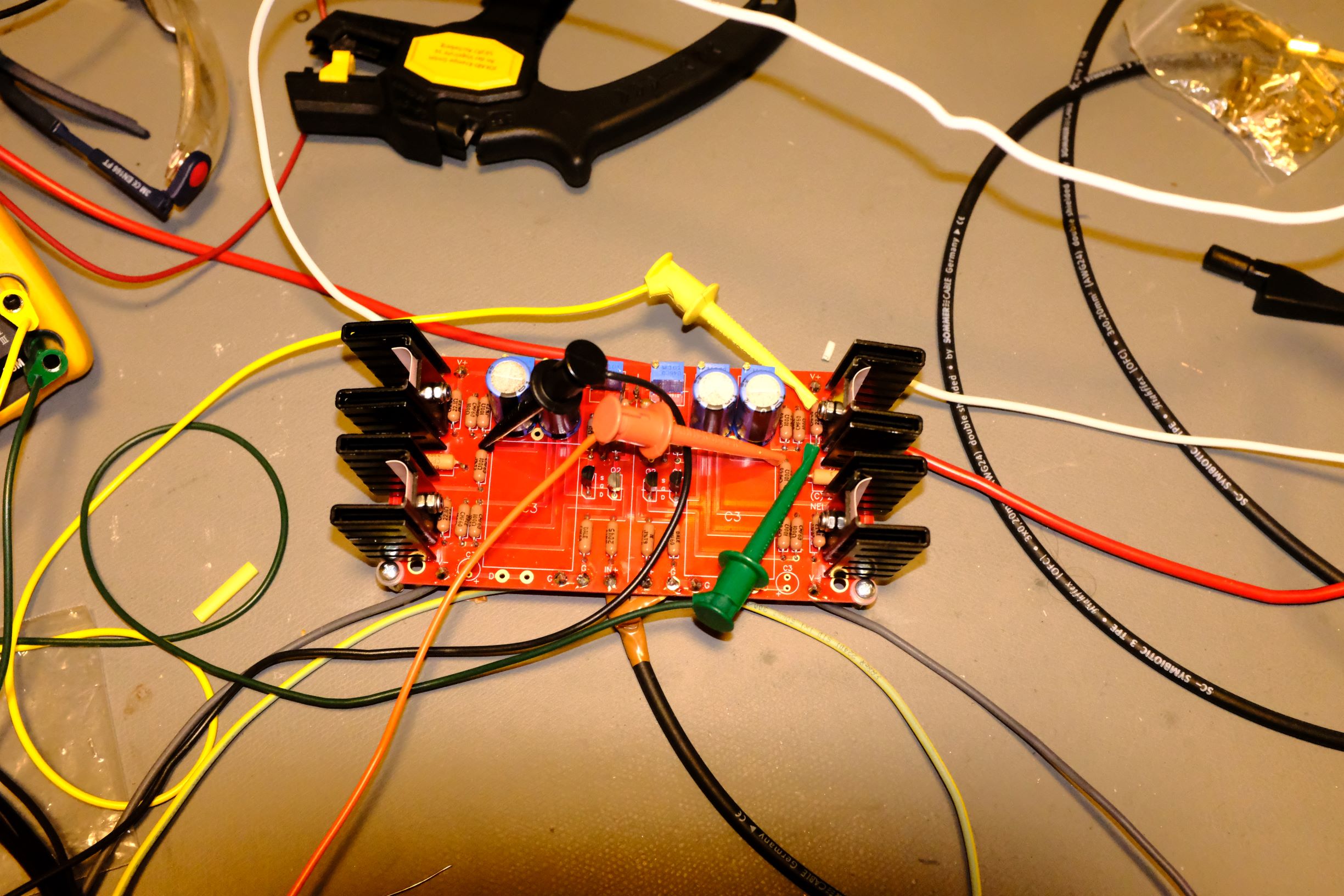

Whilst building my second BA-3B monoblock I did some more distortion measurements on the Gainstage and found roughly the same result as before:
In stereo mode I measure 4 times the distortion as Papa did (0.02 % vs 0.005% at 2.8 Volts). In balanced mode my amps perform almost exactly as Papas did in stereo mode. 2nd order harmonic was nulled via P3 and this is only 3rd order.
In stereo THD measurements were made with RME soundcard and Keithley 2015 DMM and results were the same. As all 4 channels are more or less the same I guess that these results are real.
Now where does the difference come from? Is it because I used neither Toshiba JFets nor Toshiba Mosfets? Or am I not supposed to poke around with unshielded probes for THD measurements? The JFets I used are linear systems from the shop and were really matched within 0,1 mA.
I already love the amps, but if I can make them even better with Toshiba parts, I would do that especially as I have spare PCBs for the Gainstages.
Any advice is highly appreciated.

Many thanks again omniscient Zen Mod. To match those Mosfets N to P I used "odd" ones out of the normal range of Vgs. So I will try to solder in some sockets and test some more mosfets in the normal range before ordering Toshiba parts.

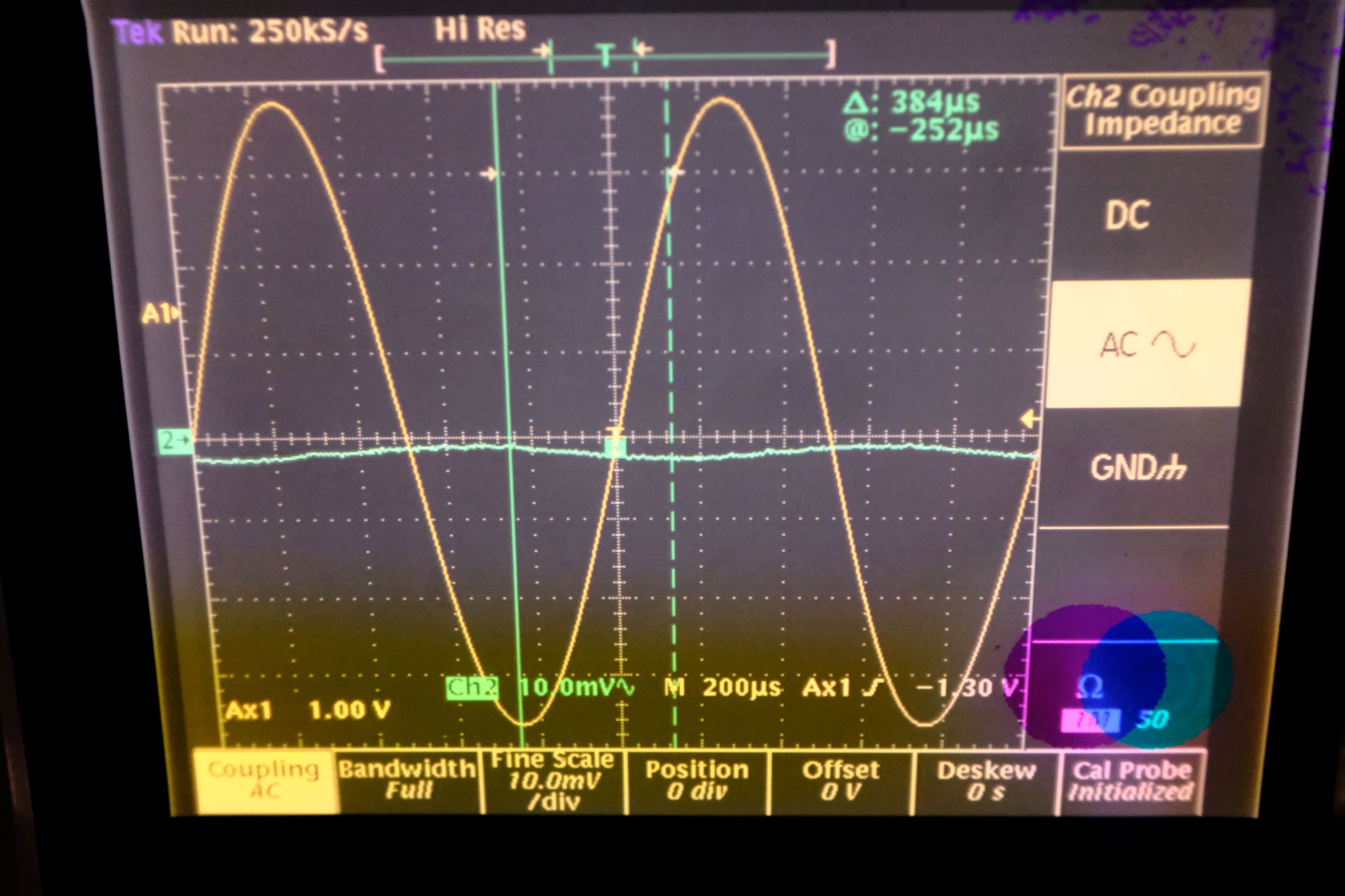

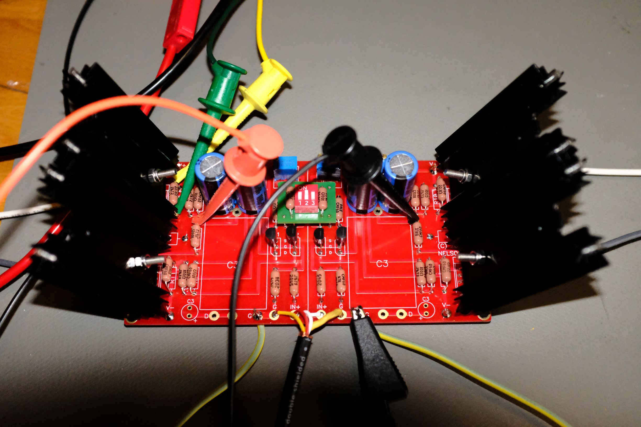

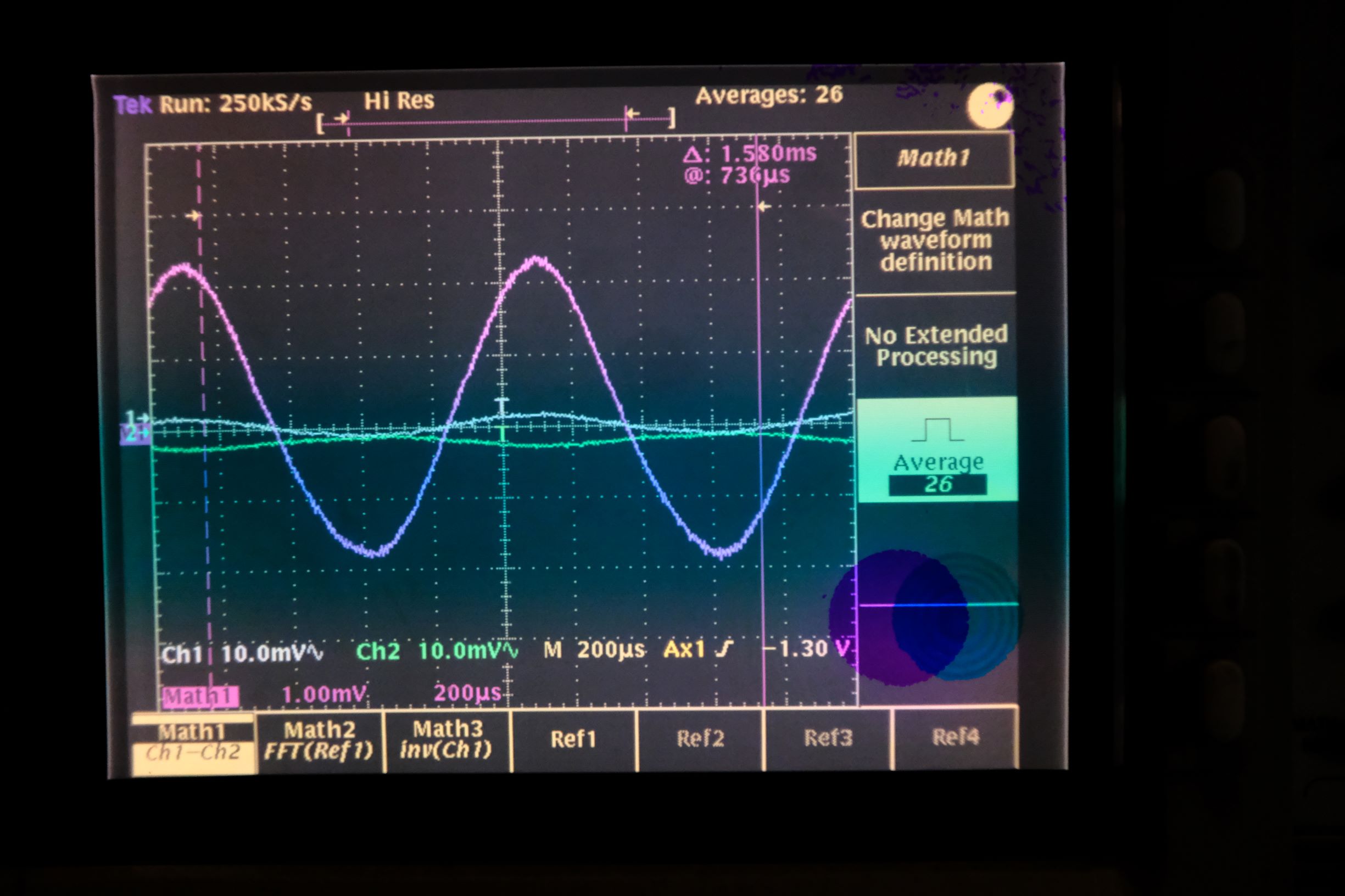

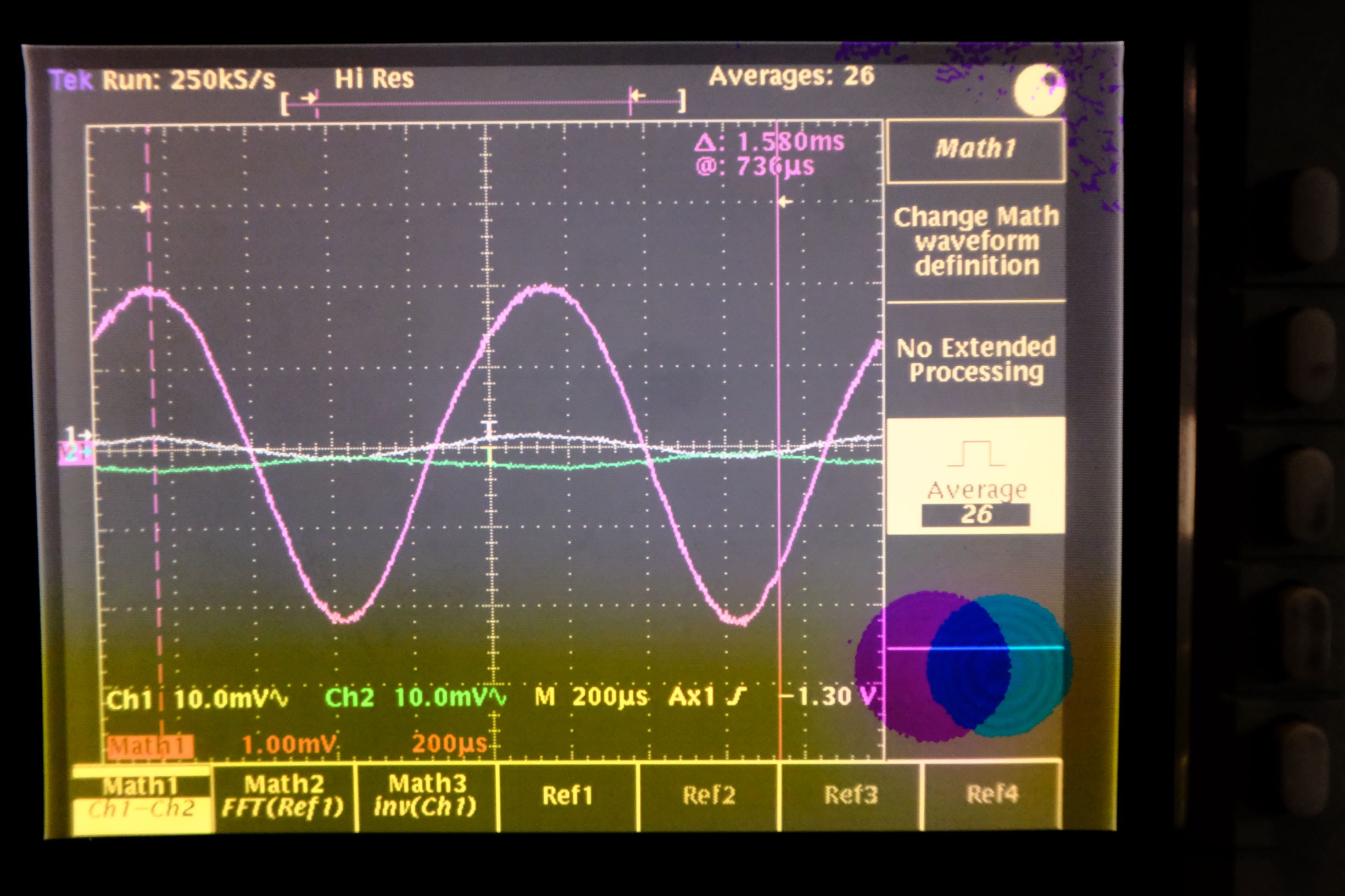

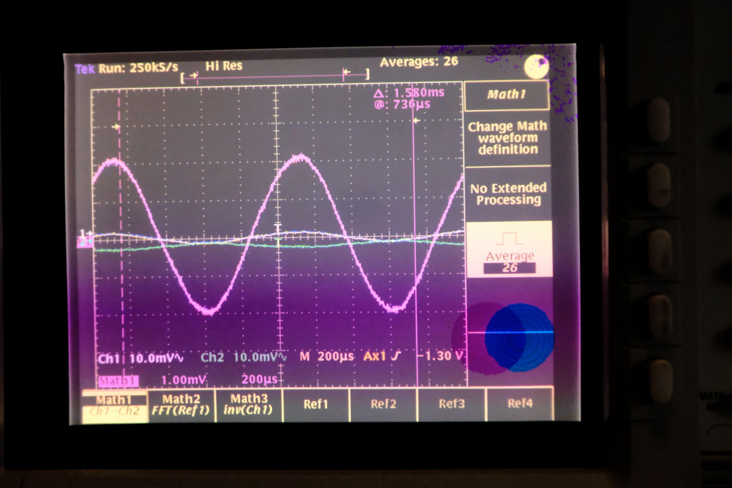

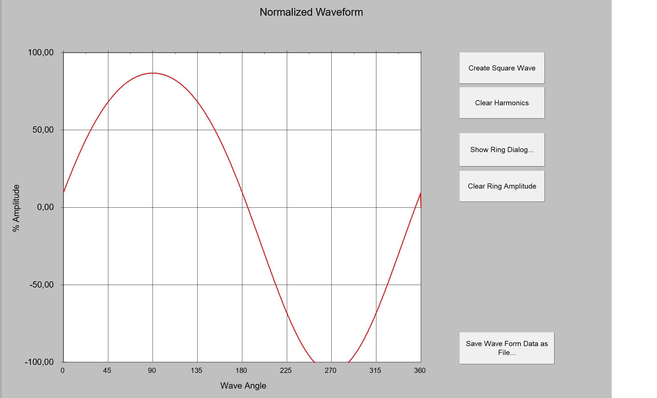

I built the first FE with Toshiba parts and lo and behold it performs as expected. Turns out I am an H2 guy - so I have to dial it in balanced mode. To get control over the phase of H2 I built a balanced Hall - notch filter as published by Mr Kuhn.
My filter is not steep enough so I can only see small portions of H2 in the mixed signal. With the help of a nice sinwave calculator found on this forum, I simulated positive and negative phase H2 and it shows as exaggerated negative (neg. H2) or positive (pos. H2) peaks of the fundamental sinewave. ("positive H2" = -90° phaseshift of H2, "negative H2" = +90° phaseshift of H2)
When I turn P3 counterclockwise I get a slight shift up (possibly meaning positive H2) and when I turn P3 clockwise I get a slight shift down (possibly meaning negative H2). This is the same for both the positive and negative signal.
Where I get mixed up is which phase was favoured by most people - sometimes I read neg. sometimes pos. in the publications. Of course I can try and probably will test both ways. (Also the filter has a phase shift around 135° or so at fundamental and around 90° at H2 which might mess up things further. Also I have only 2 channel oszi and not enough x1 probes)
Does that "phase-measuring" make any sense and which phase should I go for (0,02 neg. H2 at 2.8 Volts maybe)? Is there a better way to measure the phase of H2 in a balanced signal - can Arta do that?
Thank you very much

I read the BA3 article once more and it seems to coincide.
Turning the wiper (lowering the resistance) of P3 towards Q1 (counterclockwise) on the positive signal half gives rise to positive H2. And as the negative half is mirrored on the pcb and then again mirrored on the screen/speaker, turning the same direction (counterclockwise) gives the same result in the differential signal for both halfes.
As this is the newest and more detailed source I will go for neg. H2.

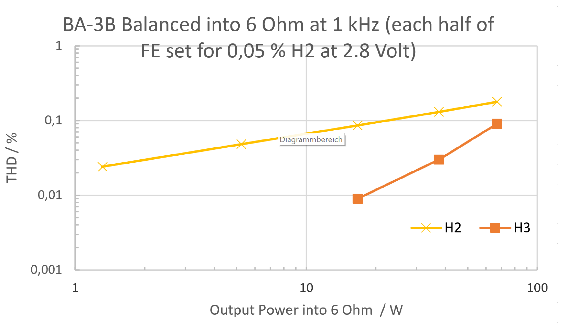

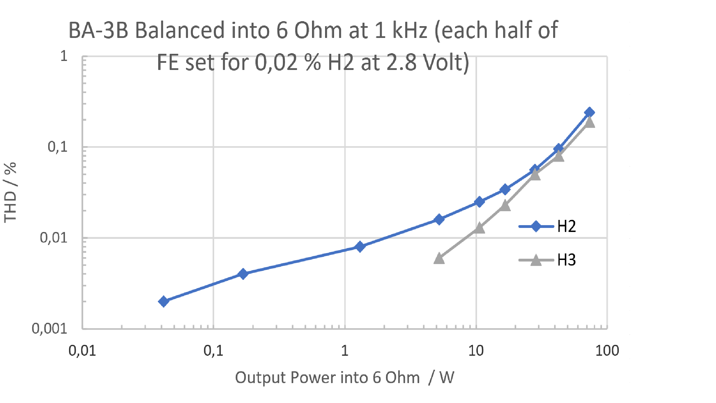

I settled for 0,05% neg. H2 for each half @ 2.8 Volts = 5.6 Volts balanced.
Attached are some THD measurements into 6 Ohms at different setting for P3.
This is with Toshiba Jfets and Mosfets. Output stage has 6 pairs of IR Mosfets per half.
I can only compare to a crappy built F5 turbo V1, Luxman M-383 and AV Denon 5803. It beats any of those with ease. Percussions, Guitars, vocals, overall clarity are insane. Center image and soundstage have also improved. Never was I able to "touch the music" like this.
Only thing negative are a few annoying hi-hats, when listening off center, that get muffled or smeared with my other amps (except F5 of course).

I did bias the FE at 100mA and the output at 0,4A each.

Regarding H2: yes just take care to invoke negative H2 (wiper towards Q2) on the postive signal half and positive H2 (wiper towards Q1) on the negative signal half - that way they add up to negative H2 in balanced operation
