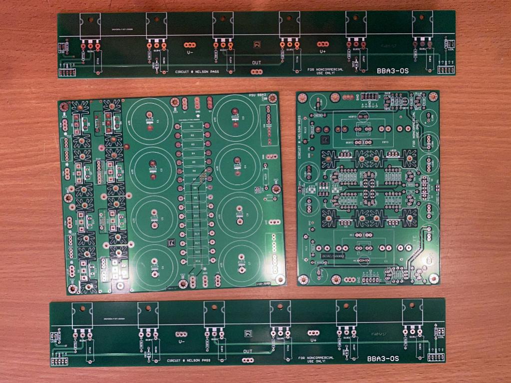

I've made a bit more progress laying out the chassis and planning for the different iterations. I decided (perhaps foolishly) to go with the 0R22 source resistors.
My matches were tight (I know my measurement is not accurate to within 4 significant digits, but... they were very stable.
Ns - 12 Low 4V097 : High 4V157.
Ps - 12 Low 4V290 : High 4V303 - The Ps were incredibly consistent.
If the 0R22 are ill advised.... I should know soon enough. I'll measure across each source resistor to check for consistency and bring the bias up slowly.
For now - I'm confident they should be fine. The 3Ps and 3Ns within each channel are within a few mV.
I am starting with one board per channel and doing the BA-3 "std" to check everything out and listen for a bit. Then comes the fun of experimentation and switching to monoblocks (most likely at least a few weeks or even more).
Here is what I came up with for mounting 12 devices on the sinks. Should be no problem to put the bias board on the "higher" of the two. A bit of a pain to move it once I change layouts, but I think it should be clean. No remote wiring etc. Any thoughts are appreciated. I am still on the fence. Is this nuts... ill advised... genius?
I may have seen it somewhere, but I truly can't recall. If I am "remembering someone else's solution" I'll gladly give them credit.
Onward we go... Becoming more of a "fearless amplifier builder", but man... 😀 😀
Edited to add - just in case... obviously the pic shows a MOSFET that won't be used. It was a sacrifice from learning to match devices a while ago. I keep it for test fits etc. It's a Fairchild, and I marked it so I wouldn't mix it up with good parts. The MOSFETs on the "left" are shown floating, but when I soldered them into place - I had the ceramic pads installed and did it properly. I was only experimenting with ideas for fit before I put on the bias board.

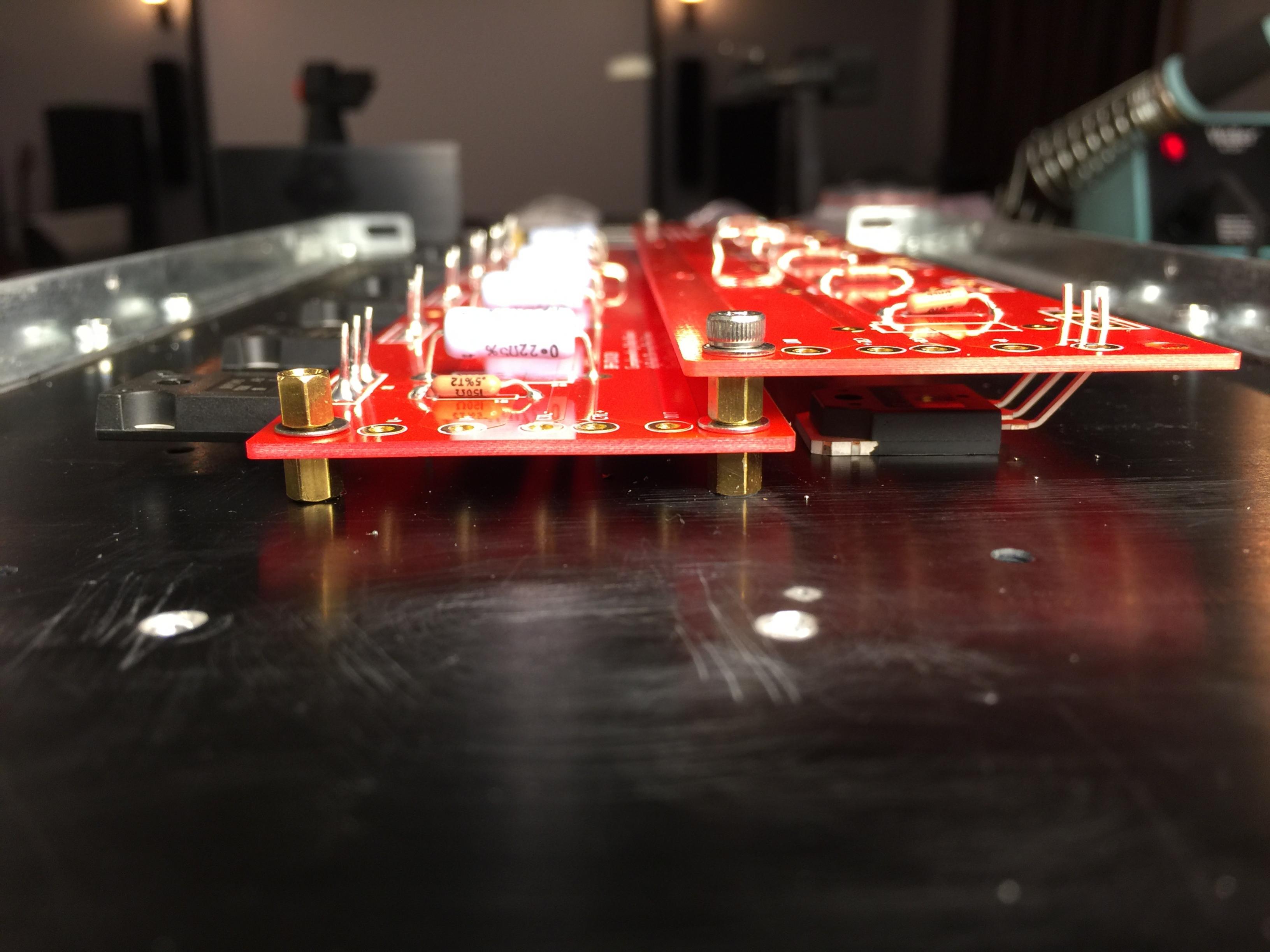

If you have a problem with that layout it’s going to be very, very difficult to remove any devices. Make sure you have a fender washer and split washer since you’ll never be able to snug them up if they thermal themselves loose.
Personally, I’d try to come up with a different configuration.

I'm a little unclear (situation normal) about why you are double stacking those boards? You spoke earlier about a transformer not being sufficient for some iterations of BBA3 you had in mind.
Which leads me to wonder are you going for a version with 12 mosfets per side?
According to Nelson's writing above, its a good idea given enough heatsink.
Or, lower rails plus more outputs plus more bias...

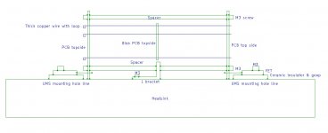

Alternatively -
Thoughts?
(I didn’t draw the standoffs because I’m lazy)
Thoughts?

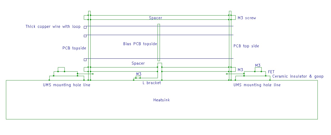

Mount the FET's top side at right angles to the PCB, place the PCB's back to back on the heatsink, use spacers between PCB's & a (hand made) L bracket to fix to the heatsink (use the 4 holes in the middle).
Thread thick copper wire between the O/P 1 bias O/P2 PCB's, I found it a handy way to mounted the board, seemed to work well enough for me.
PS, form loops at the top end of the copper wire, it makes a nice little solder connection for the wiring.
Sorry if I was unclear - Wowbagger had asked re: why I was running the PSUs in parallel for (what will be soon) a balanced build. The reason was that one of the 400VA donuts won't be enough for running 12 per side (potentially). So, I am using two for an effective 800VA supply.
Yep, at some point, I just gotta try - so I'm planning ahead.
According to Nelson's writing above, its a good idea given enough heatsink. Or, lower rails plus more outputs plus more bias...
Exactly. I attached a long-ish .pdf with some thoughts. Wowbagger added some additional thoughts and quotes that help confirm that my various iterations should be fun. Basically, from my early math - I'll run out of heatsink before I run out of bias / devices, but 24 devices at 0A25ish should be okay with 4 heatsinks and 800VA. If not, then I'll find out soon enough.

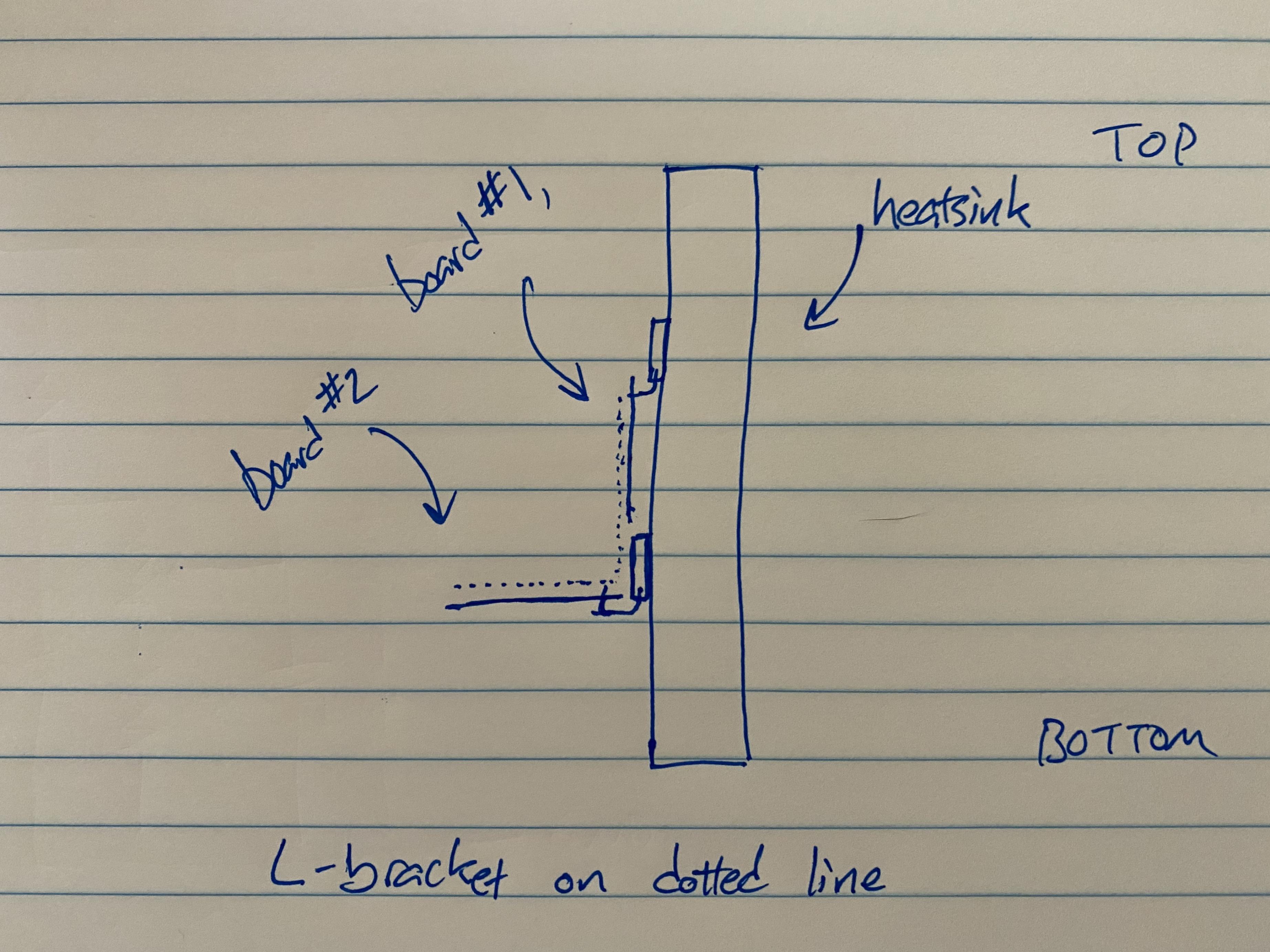

6L6, Wowbagger, and Itsmee - Thank you for the great ideas re: mounting!!!! I'm not ready to do it yet. However, now that I've got a few ideas, I know I can tackle it later without taking drastic measures.
Itsmee - I dug back in the thread and in the "Pictures" thread. Did you share a picture on the forum? If so, could you point me toward it or post one, please. I think I understand what you've described - but my spatial skills have gone sideways. 😀
Edited to add - similar to this, but with an L-bracket in the middle and with the bias board connected per your description??

The link didn't take me to a post with a pic.
Sorry, didn't take any photos, and the chassis is in bits becoming something else.
Hope the bad drawing makes it clear.
Edit, I used M3 studding and some nuts for the spacers.
Apologies for the dud link. It was intended to go to post #279 in the BA-1 thread. I checked the link and it works on my end, but who knows?
More importantly, thank you for taking the time on the superb diagram! Much appreciated! I have a very high confidence I will do this with the BA-1 output stage. Sadly I had already soldered the MOSFETs on one set of boards for the BA-2 output stages (two boards of the four) parallel with the boards. Removing and reorienting them may be a challenge I'm not ready for. I'll be sure to post pics when I get to the BA-1 output stage and give credit where credit is due if I'm able to pull it off.
