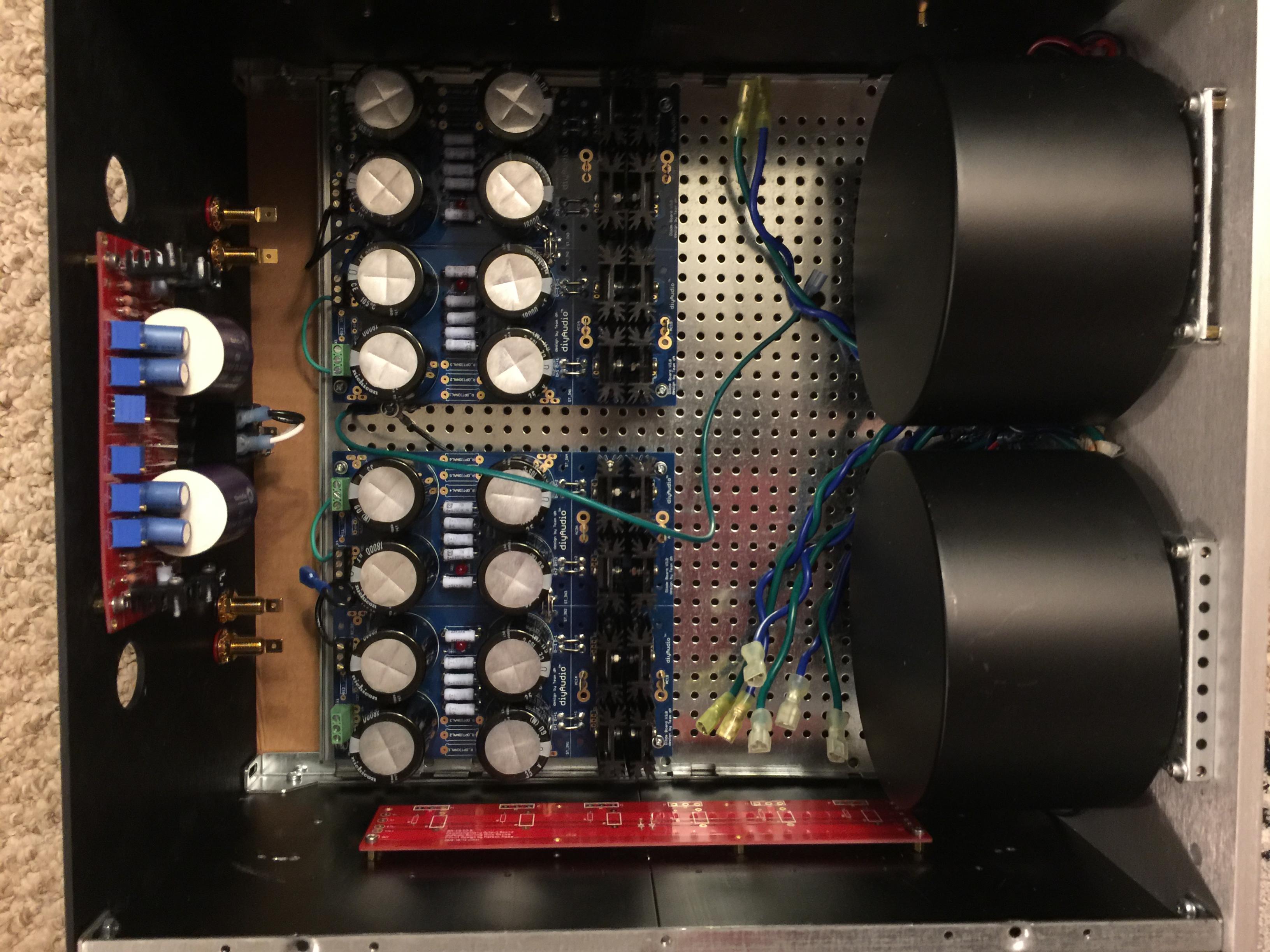

And of course ... a pic of progress. Trying to get the chassis laid out a bit better than some previous builds for shorter / cleaner wiring. First time mounting transformers to the front panel. 😀
I think I'm going to mount the PSUs tighter to each other to allow a bit more access to the amp boards (and keep them just that much further away).
Any suggestions greatly appreciated as always.

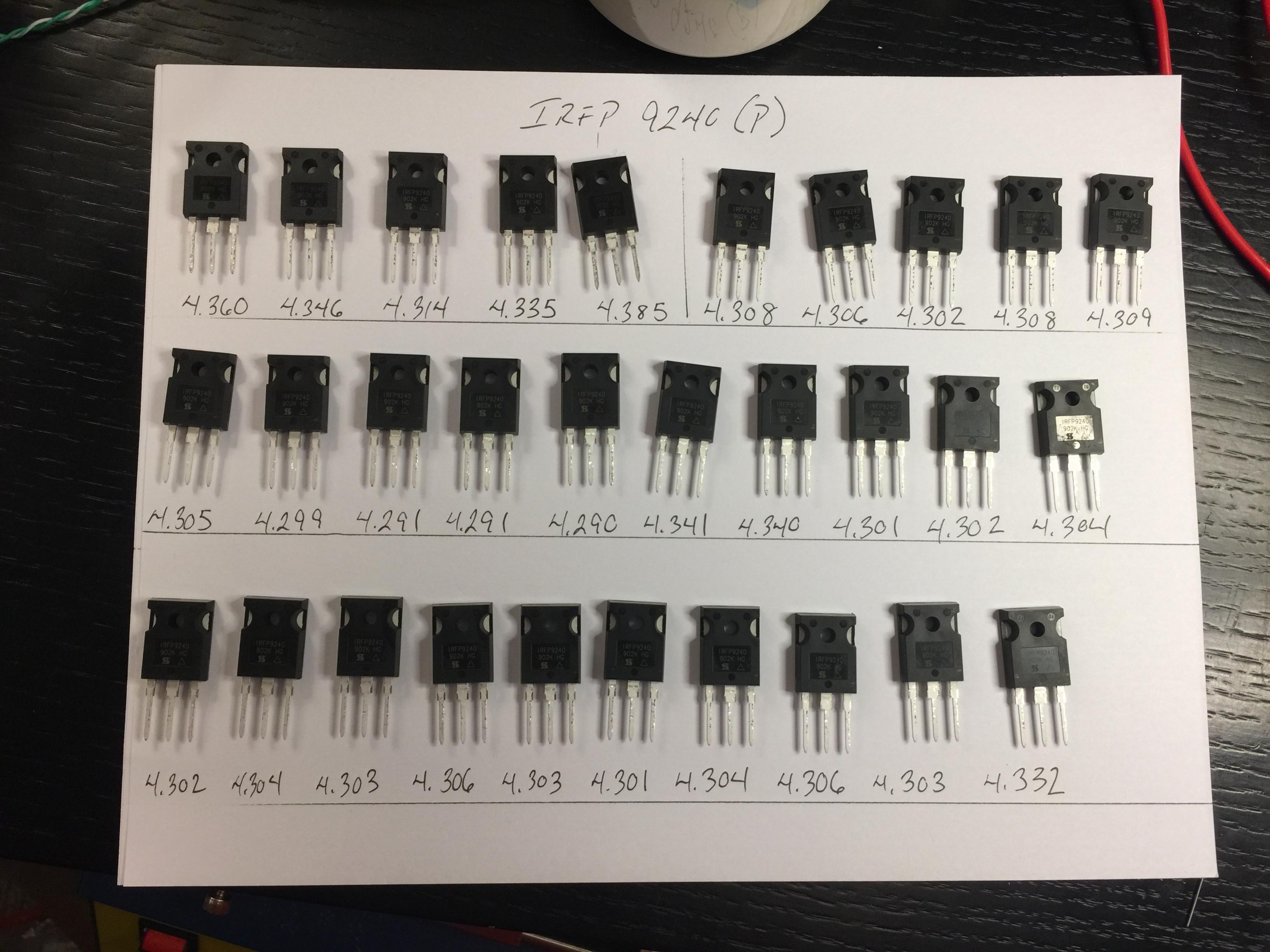

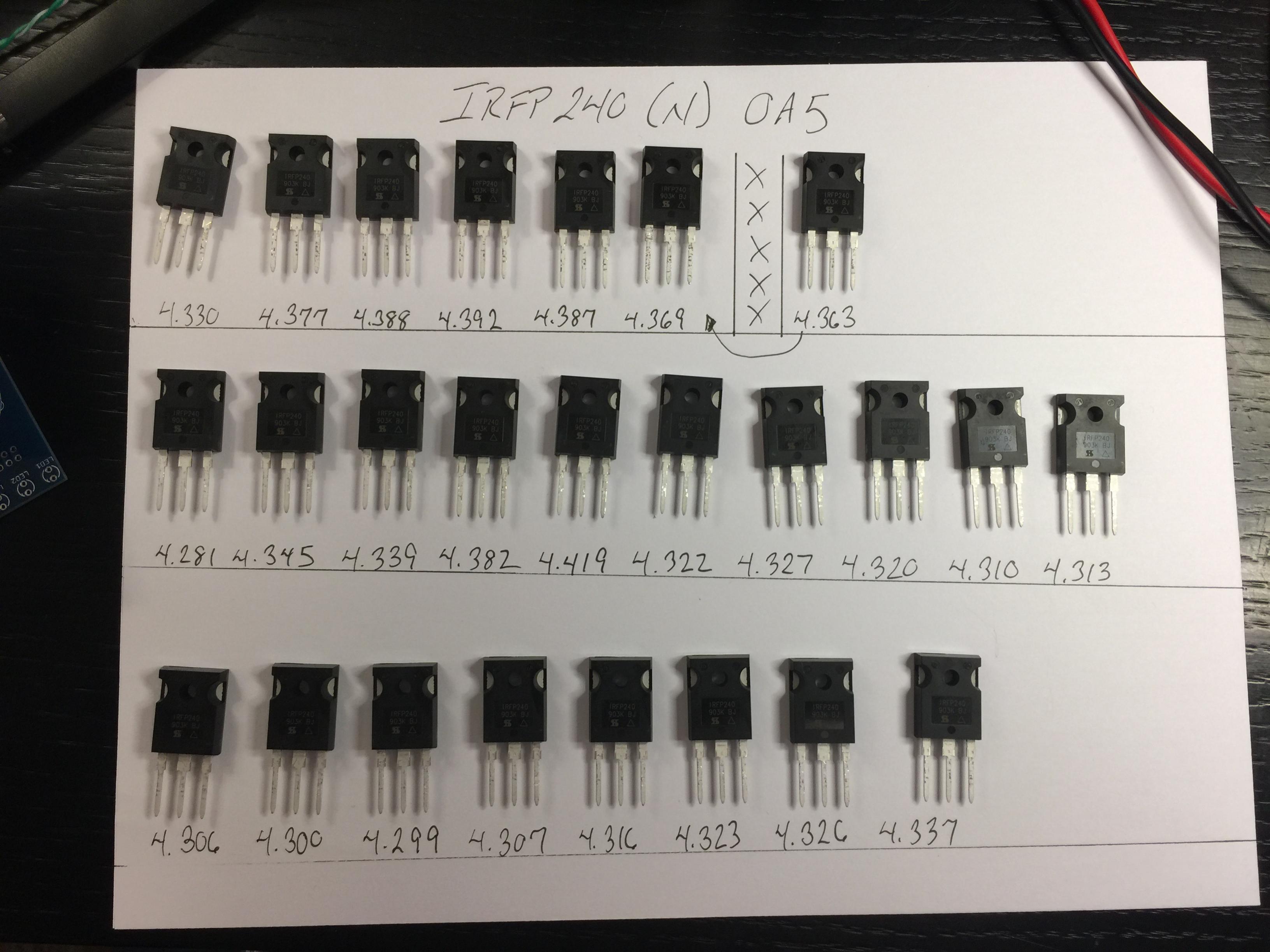

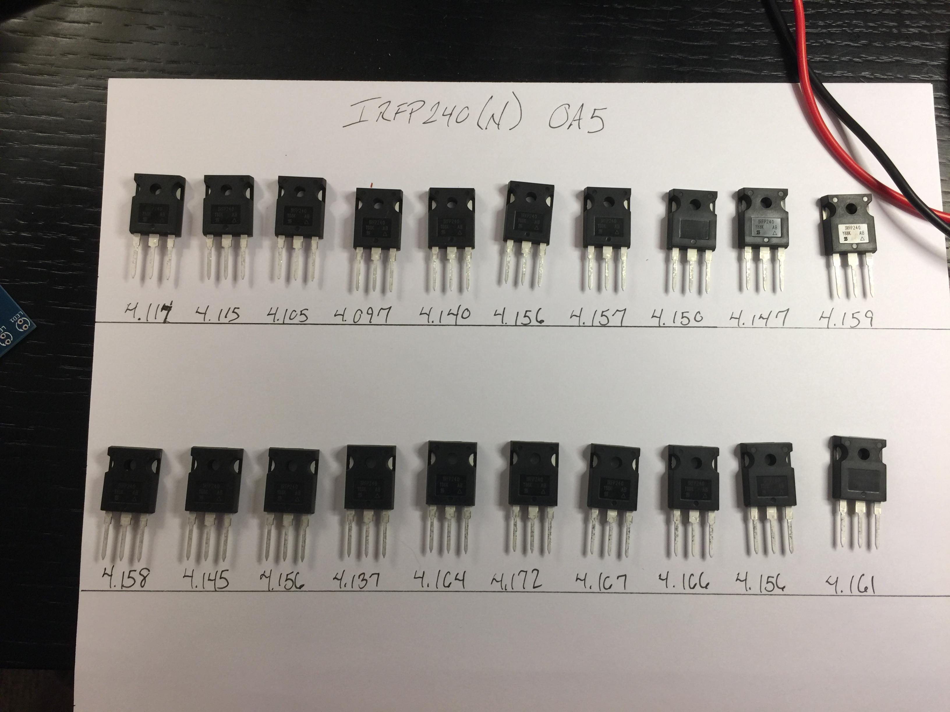

Alrighty then - I finally set aside the time to measure all my MOSFETs using 0A5 with a heatsink.
I have to say, now that I've done it myself vs. doing them in "free air" - it makes more sense. The Vgs stabilizes much faster and evenly with the part on a heatsink.
Now to sort them and set them aside for projects. 😀
ZM -
For the BA-2 complimentary output stage - I have a range from 4V10 to 4V17 for the Ns. I have 4V29 to 4V34 for the Ps. I can break things down into smaller groups as needed
If I pick the "cream of the crop" for closest values in groups of 6 Ns and Ps (I may have up to 6 in parallel in the future) any concern with using OR22 source resistors?
For the BA-1 SE output stage - If I use between 4V28 and 4V33 for one channel and 4V33 to 4V42 for the other is there any concern with using OR22 source resistors? I got a bit of a wider spread in that batch. That's across 25 units.
ZM -
doesn't matter which style of OS, rules are the same
cream of the crop would probably be ok with 0R22, with decent heatsinking
