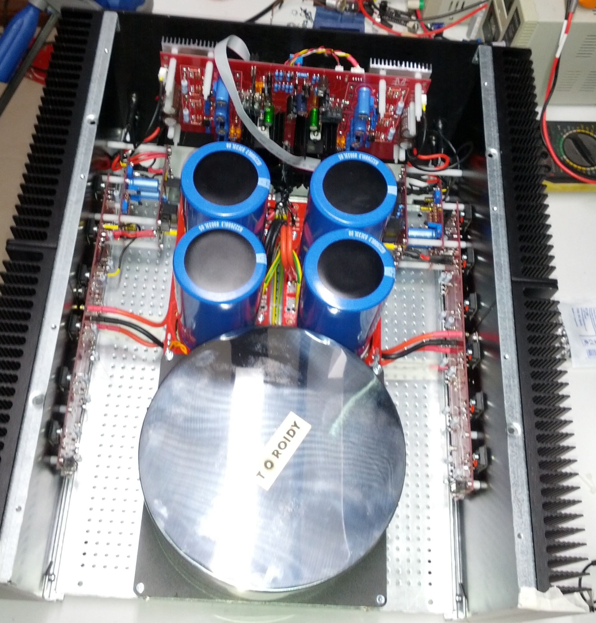

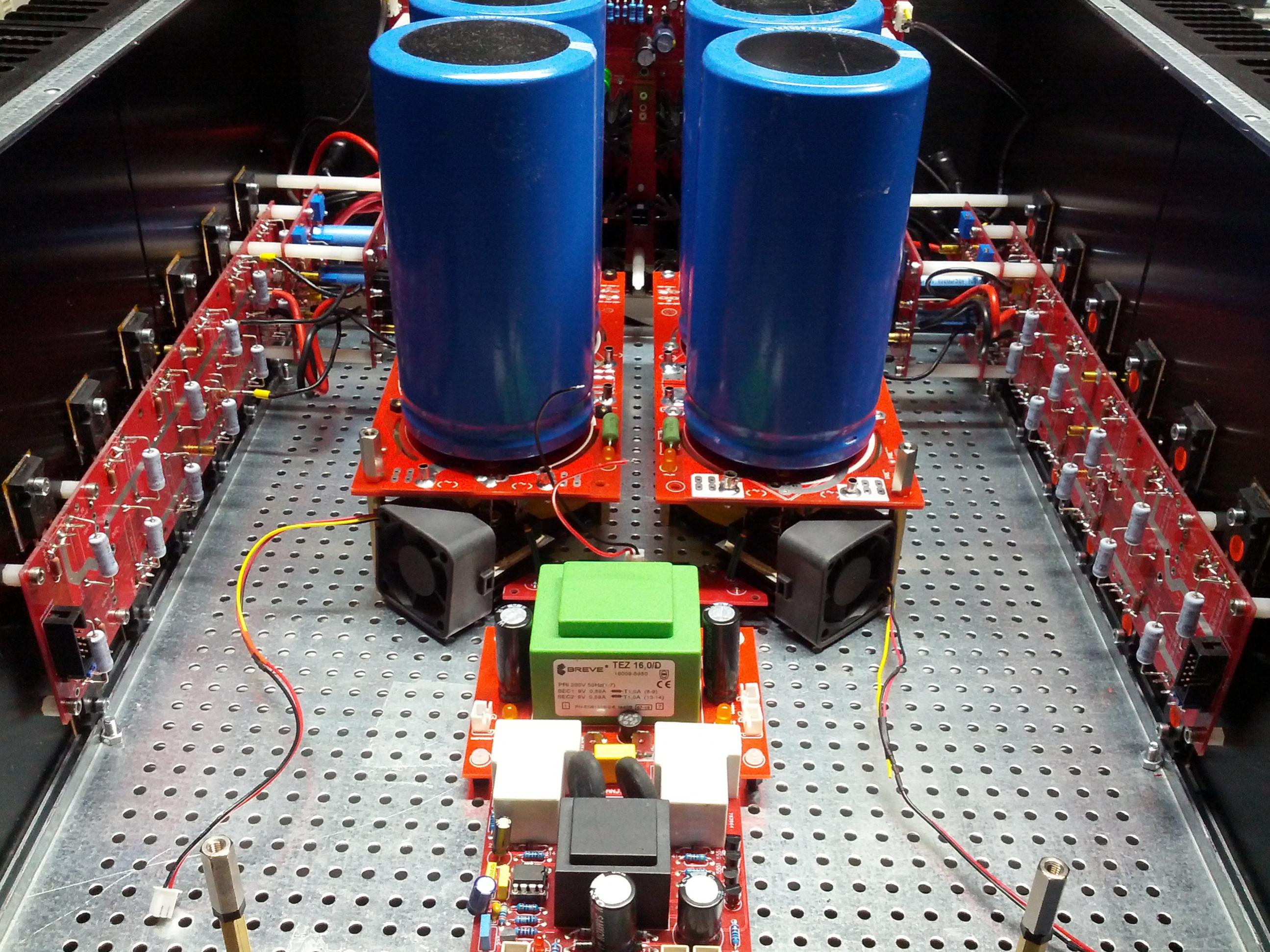

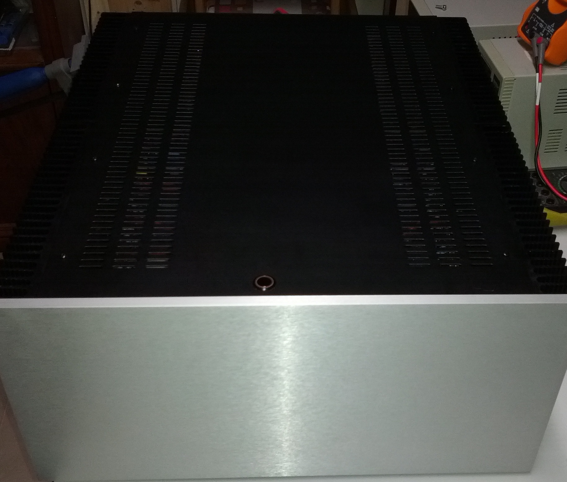

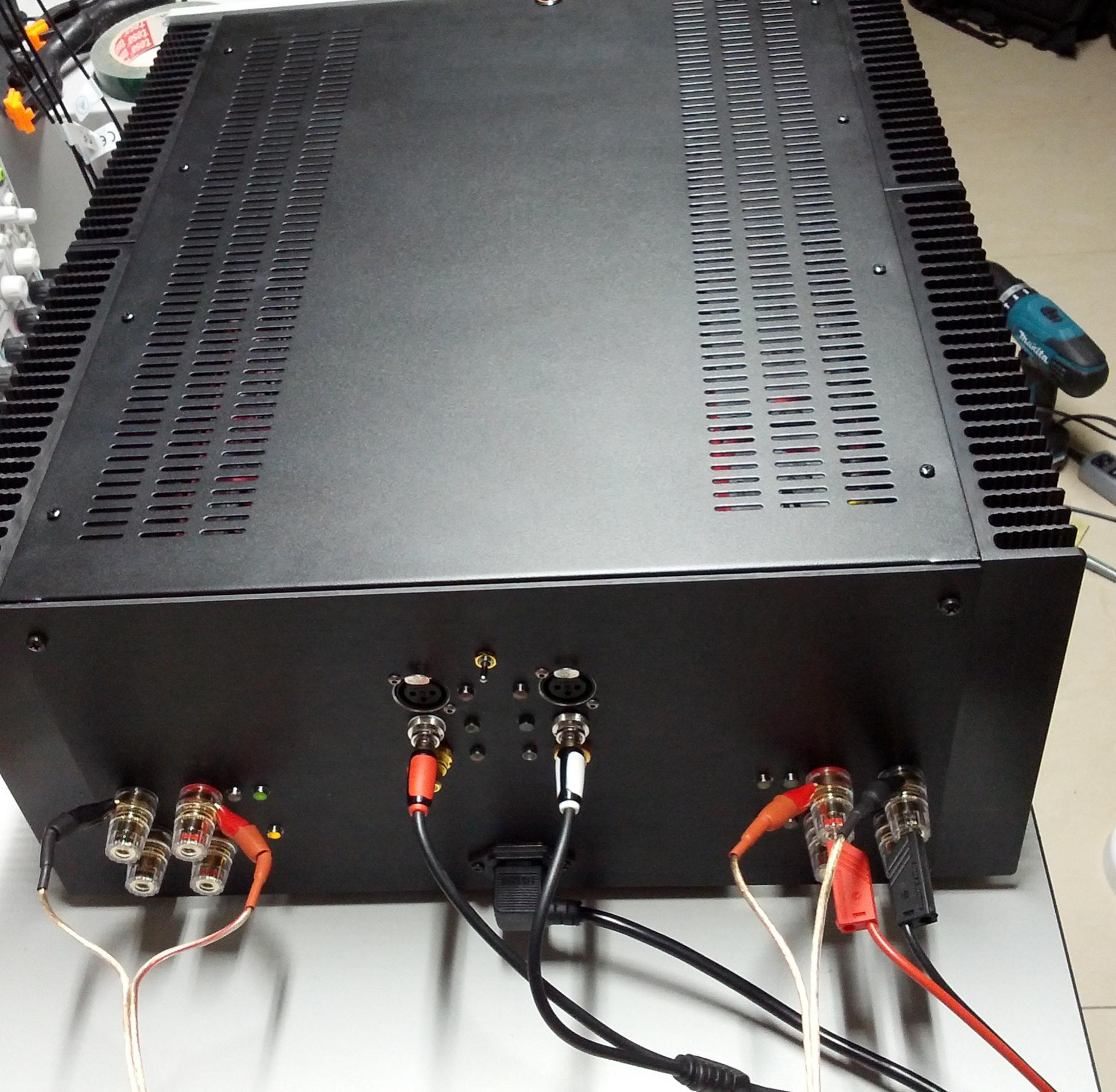

Hello, A new Ba3-Balanced - Ba3 4 channel non complementary is born and signs stable 🙂
The FE is powered by Salas's shunt stabilizer,
Has some protection to DC, temperature and overloading witb boards under transformer,
I still have to connect all lights , add bottom shielding ; add temperature shield for capacitors and cnc the front pannel for status indication and thermometer but ... i was so eager to hear it sing as a gratification of the work it took!
No photo gear in my mancave hence lousy photos attached.

After listening tests the amplifier is undistinguishibile from a 80's golden age stereo high end; which is amazing for a DiY. Was a great building experience.
