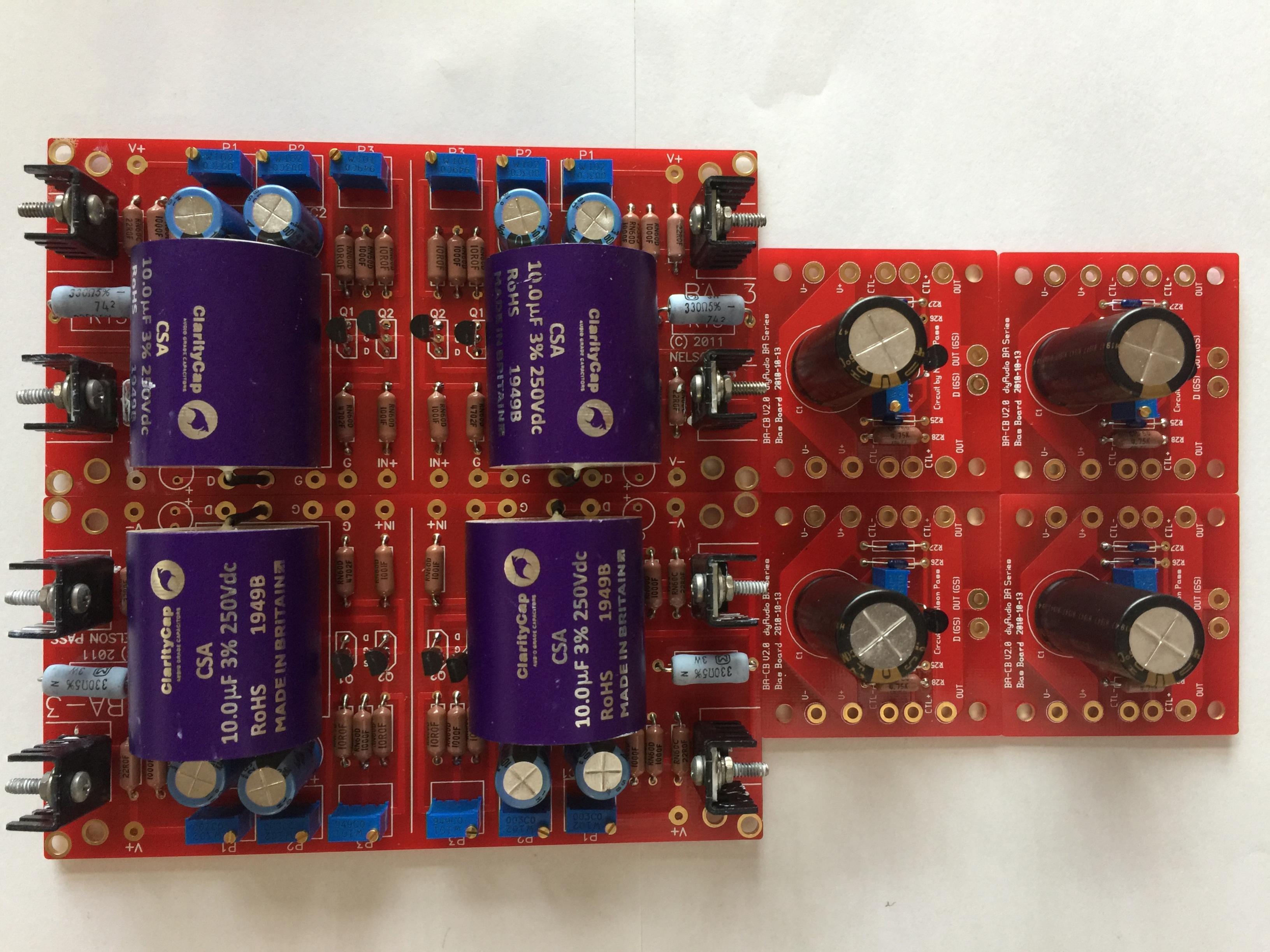

Just installed the JFETs in these and the Iron Pre and put on some heatsinks.
Some early board porn. The output boards are waiting for devices to be matched, so not much to see there.
