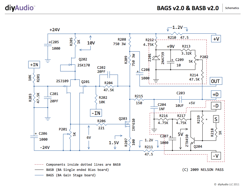

I agree with zen mod - 24V rails. 1 PCB per channel.
Build as in this guide, but use 18+18VAC 300-400VA transformer.

Why 24V vs 32V rails? Isn't more rail voltage just "better" except for the risk to the Jfets? (Slightly) more power and less distortion, right?
On my F5 I am considering going from a single 18+18 transformer to dual mono 32V rails (. I am not concerned about too much voltage on the Jfets, it's a risk I will take. What's the downside?

+/-24V , 3 deep or more

Hi guys, I got a question here. I was reading the F4 doc & saw that 2 F4 can be driven as parallel mono for 2 ohms load.
Can one config. the BA-3 likewise?
Assuming if it can, will 2 BA-3 (with 3 pairs output per channel) driven as parallel mono have any advantage vs one BA-3 with identical dual-mono power supply & 6 output pairs, in terms of distortion level, current output, etc?
I understand that when driven as mono parallel, both left/right channel must be well matched & balanced for optimal performance. Perhaps this is one advantage that a 6 pair channel has over it?
more Bias = less Distortion
more Voltage = more Power
Yes, if you double up the front-end and drive the outputs bridge balanced.
If you want more current into lower ohm speakers, just add more output devices.
