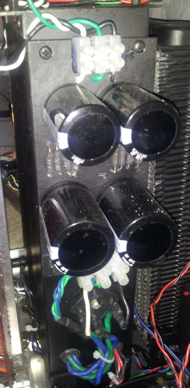

If monoblocks - can the PS be split, or would a second full cap board be best? This will be my first build with the diyAudio store board. I fabricated my own for the SE build.
"If monoblock you need 2 PSU as you will have 2 chassis."
Understand that - just not familiar with the amount of flexibility of the new (to me) blue board and didn't see any info in the PS build guide. I have this on each side. Are you suggesting I would get better performance with the full eight cap set if used in the SE?
