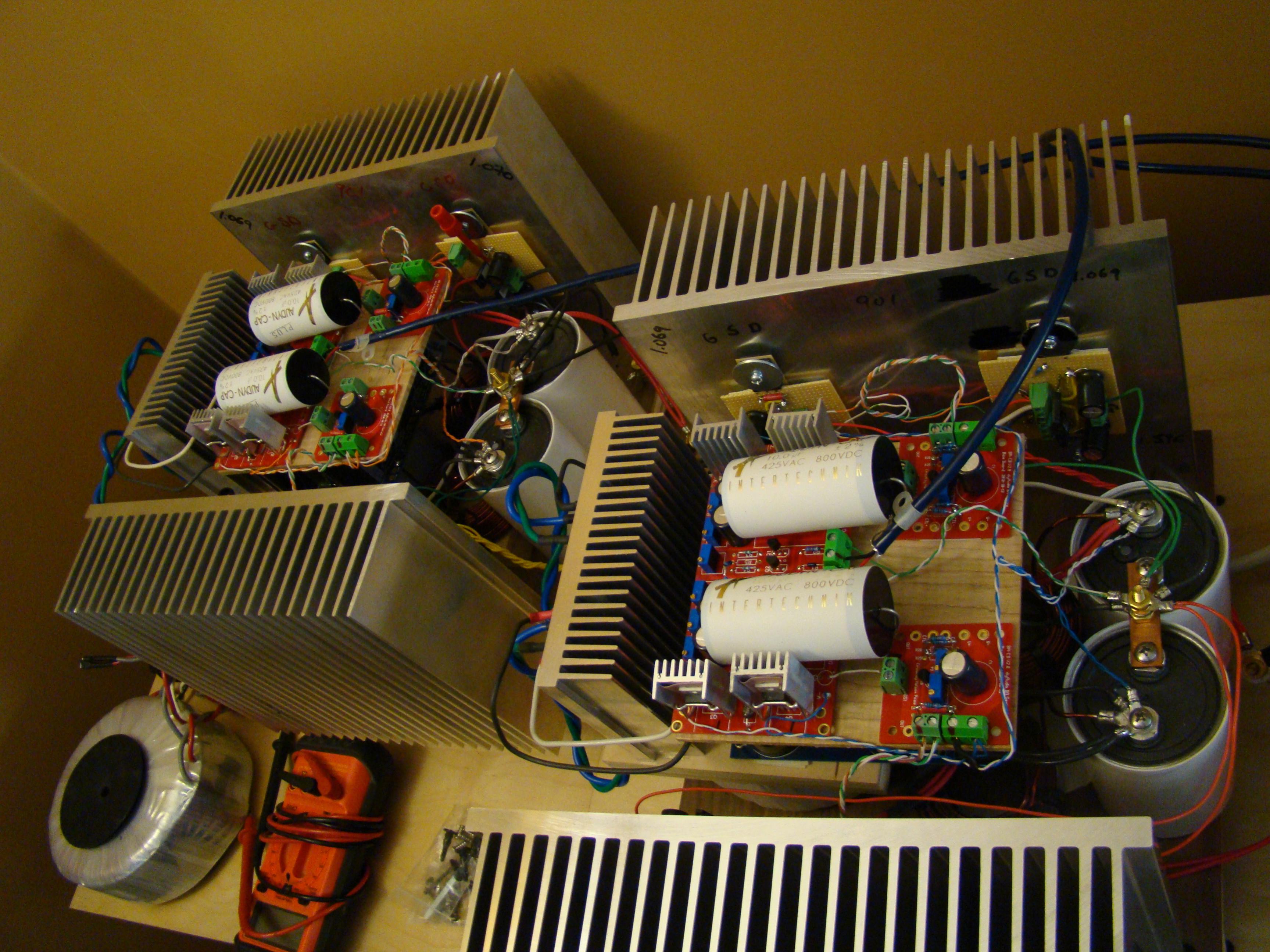

Giulio, I did what you are thinking about..almost. I started with two ba3 mono blocks, 4 pairs of outputs per amp. Listened for a while and then converted to balanced. Just as you are thinking I all ready had the matching ba3 front ends set up so the switch was easy.
I also use a clc filter and 800va transformers. A difference is my output devices are laterals biased at 1 amp each. 8 amps total per monoblock.
I like the sound of the balanced set up. I built up a volume control/input selector that has a pair of jensen transformers http://www.jensen-transformers.com/datashts/11p1.pdf so I can plug in balanced and single ended sources.
Enjoy...Evan

Balanced the sound seems a bit cleaner but in all fairness a direct a/b comparison was not possible. I have adjusted p3 by ear...turn pots one way listen turn pots other way listen...I need to equip myself for a more controlled approach to this.
My dac minidsp2x8 and amp that runs my woofers are all balanced. This as well as a need to tinker is what led me to the balanced ba3.

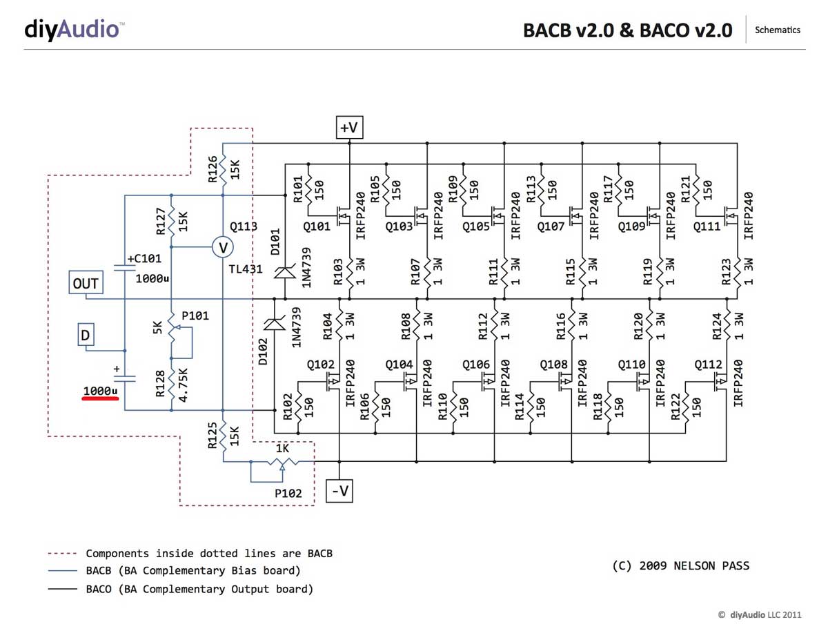

Thank you Zen. My problem here is to determine the input impedance (of the output stage I presume, a complimentary one with 3 pairs)...😕
Thank you again Zen, I will specify more in the future 🙂
I will go with 7.6uF then. But (only to learn), how can I get the input impedance from schematic?
I said - specify exact one
post schm here , or link to
biasing network is where is possible difference , dominating input impedance
Sorry, misunderstanding. Here the schematic http://www.diyaudio.com/forums/gallery/data/500/P-BAC-S4V20-schematic_2_.jpg, but mine is with 3 pairs.
Note: this schematic has errors (IRFP240 instead of IRFP9240 in lower half), other values are OK.
if you insert red marked cap , you'll not need BA3FE output cap - just short it
overall quality of signal path will be , say , even purer than in originating version
this way , it's same as "crippled F4" , even for untrained eye
(input impedance is , say , 5K-ish and lower........ simple for deducing but I'm sorta short in time now - already spent it to editing of schm)
I see total resemblance (even me!)
I will go this way then, cheaper and better!
