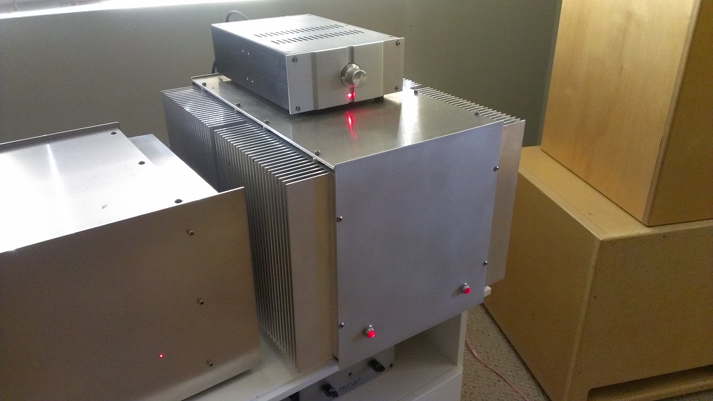

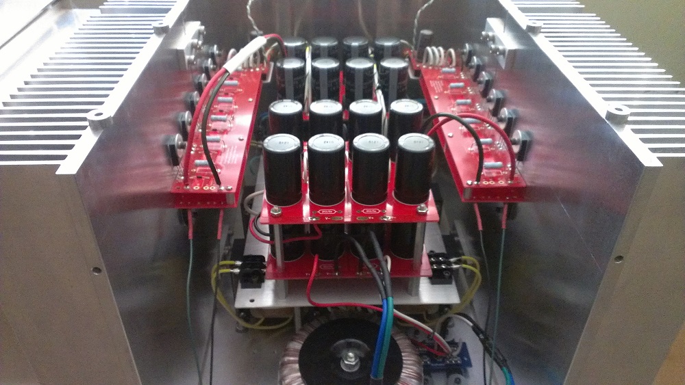

I built this one stereo (single ended version). It has two 600 va transformers, separated power supplies. It is extremely heavy, have not weighed it, but sure its over 100lbs. Sounds better my other Passdiy amps. That Is a BA3 gain stage on top, I no longer use it, turns out I dont need it.
If I remember correctly, it has +/- 25 volt rails, and I think it clipped 8 ohms at 14 watts.

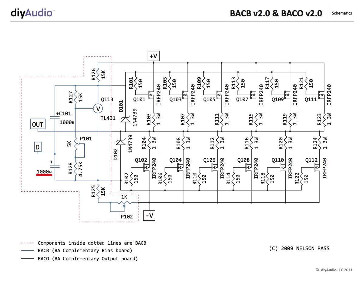

Guys, what type of resistors are you using for source resistors on MOSFETs? Is it ok to use metal film also? Otherwise I cant source 3W metal oxide lower values then 1R. Other problem is Mundorf 5W dont fit on the PCB...Any thoughts?
metal oxide tolerate overload a bit better than metal film.
For source resistors I would use either metal wire or metal oxide, not metal film.
Except that the latest I am working on uses 5off parallel 1r0 600mW 1% metal film to give an equivalent to 0r2 3W 1% metal film as an emitter resistor. So I break my own rules. The emitter resistors of the 2pair output stage, have a no overload current limit of >7.7A
For a fast transient I would expect them to tolerate ~15Apk provided the transient is very short. 15Apk is my target for peak transient current for a 100W into 8ohms capable amplifier.

Any resistor you choose won't have as much impact on the sound as 1 turn of P3...
Use 1% metal films and don't worry. The 3W are hard to find in 1%, 5% is fine there.

has someone give a thought to replace the coupling cap between the front end and F4 whit a transformer?
I have found the mod from ZEN! Great, removing C3 and installing Cx capacitor looks very nice...
Today I finished the ZEN mode, looks great! Two big silmic 2 capacitors on bias board...🙂
