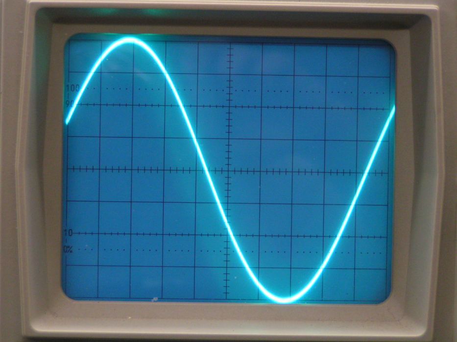

Hi, all
I have some pictures of the octal D-I dac output signal at 2, 6 and 8 KHz + FFT and a photo of the octal D-I DAC prototype.
>Squarewaves with infinite risetimes in your output signal means very high frequency harmonics, the highest frequency from a 44.1KHz sampled signal would be around 20 KHz. So a perfect D/A conversion should never show a sinewave frequency much higher than that. The risetime of a squarewave must be accordingly. If your DAC outputs a perfect (infinit risetime) squarewave at say 5 KHz, you have added some higher harmonics to the audio signal that don't belong there. With a good functioning DAC you would see a trapezium shaped squarewave at this frequency, there should be hardly any "ringing" on the edges.
>The D-I DAC output signal shape is dominated by DAC-1, So this basic shape stays. DAC's 2...7 only add steps between the steps of DAC1, but always within the DAC1 envelope. Even with linear interpolation the error stays within limits.
>The waveshaping I was talking about mainly affects higher frequencies (above around 10KHz as the amount of samples is greatly reduced. Without linear interpolation you would get a squarewave instead of a triangle shape. As I mentioned before I'm not sure if this would be audible.
The added oscillogram shows a 2000Hz sinewave, the output is unfiltered!
ec,
A 5 kHz square wave should not look like a trapezoid... rather it should appear exactly as a 5 khz sine with 15 kHz sine at 1/3 the magnitude superimposed upon it.
It is because of this, that squarewave testing, and the results thereof must be considered very carefully when analysing amplifiers etc... squarewave analysis lends itself to gross misinterpretation by those that don't know (or choose to ignore) the Fourier stuff behind it all.
In the case of a DAC with a brickwall, or a properly oversampled signal, the harmonics which create the "corners" of a trapezoid simply should not be there.
