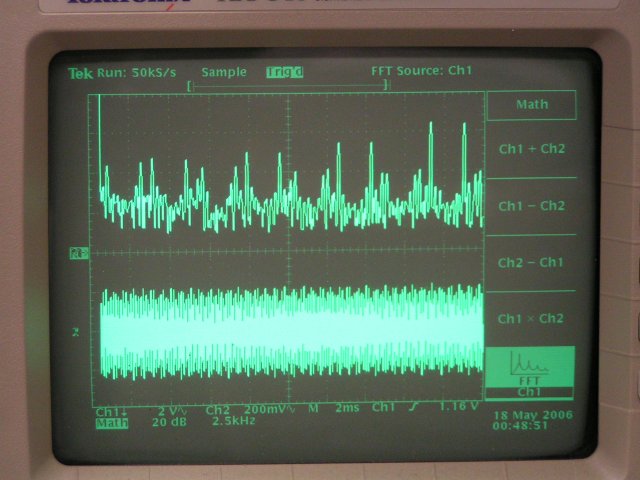

See what I'm talkin' about?
Now ask yourself what frequency has to be "beating" against that 21 kHz to cause that output.
ECE, I imagine you can't even hear the NOS signal because it is too HF. But, can you hear something with your DI signal? I would think if you can hear anything, that kind of demonstrates the point poobah is making.
21KHz ripple

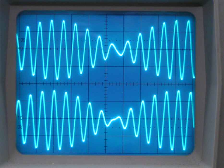

Hi poobah,
By the way the upper trace is a quad DI-DAC
Jes, a ripple (amplitude modulation) occurs on the signal, just like like with the reference NOS-DAC (as shown in the oscillograph).
The sinewaves are triangular shape (the NOS-DAC just outputs a squarewave), as I have mentioned in a previous post. I just ran the same test on a commercial CD player, there is still a ripple on the sinewave signal but it is significantly smaller than both the reference NOS-DAC and the D-I DAC (the sound however isn't nearly as good as both the NOS-DAC or the D-I DAC). So what makes the NOS-DAC sound so good? is it phase linearity?
So, is this ripple seriously affecting the audible sound quality? If it does perhaps we can reduce the ripple to an acceptible level without compromizing the audio quality.
Suggestions?

The ripple is induced because when you linear interpolate you are injected false (wrong) numbers, voltages into the stream. Your CD player will not exhibit this behavior because the oversampling is done with a filter.
If you could put both waveworms, DI & REF, through an analog brick wall you would see that the reference DAC would have the best fidelity.
I suspect that the improvement you are hearing might be two things at play. First, there might be some sonic "bonus" (extra harmonics) you are hearing... not all distortions sound bad... and this is where "listen-only" people are detrimental to the craft. That's all about perception and nobody wants to be told they're nuts.
But most importantly... a 16 bit DAC is workin' its butt off to achieve 15 bit accuracy... and it sometimes runs with 14 bit accuracy. The linearity erros in a DAC are complex...some are random... some have patterns relating to which bit is being toggled. the biggest error is usually at the transistion from:

8th order filter
Hi, poobah
Thanks for your reply,
We must have had the same thoughts.. I just quickly connected the 8th order filter after the D-I DAC to see what would happen, guess what, hardly any change. Only the triangle waves look much more like sinewaves. I scanned the 8th order filter with a sweep generator during design. It starts rolling off at 20KHz, the pass band has constant amplitude (butterworth characteristic)
Hi, poobah
Now connect it to the REF DAC note the differences.
Show a photo of the DI @ 21 kHz with the 8th order
and the REF @ 21 kHz with the 8th order.
You might be surprised!
See what's happening?
The REF has better fidelity...
see the nasty in the middle of the DI waveform?
A spectral analysis would tell more...
