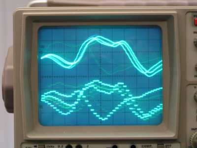

Here are the first oscilloscope pictures of the Direct Interpolation NOS-DAC, compared to a reference NOS-dac
Note it is very difficult to photograph real-time audio signals on an oscilloscope, so this is only to give an impression.
Upper trace: Direct Interpolation NOS-dac (Quad version) unfiltered!
Lower trace: Reference NOS-dac unfiltered!
Notice the difference in resolution!
Note: the addittional line in the lower trace is caused by the "alternate" mode of the oscilloscope

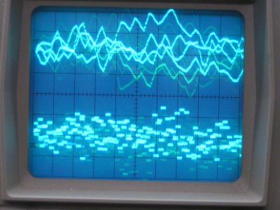

Second picture
Re: re pictures
I'd be surprised if it didn't.
Be interesting to see an 18 or 19k sinewave though.
poynton said:Well, it seems to work !
Ec designs: Why is a delay per dac of 4 clockcycles (with 4 dacs) not the same as in your setup with four dacs. I know the I2S wordlenght is 32 bit, 16 bit audio and 16 bit subcode data. The dac doesnt use the subcode data, so why is exactly would my logic work inferior to yours. (not offending ment 😉 )
The oscilloscope graphs show a lot! , i can imagine the sound is more detailed now, and i think some very quiet sounds are lifted out of the digital noise.
And i agree: the sound of it is the most important, thats where you listen to.
in phase
Hi, ezkcdude,
thanks for your reply,
I Hooked both my reference DAC and the new quad D-I DAC to the CD player (SPDIF). Connected L output of reference DAC to lower channel and the L output of the D-I DAC to the upper channel, that's it. The oscillogram shows that both are in phase, so no significant phase shift as I mentioned in earlier posts.
(Both DAC's run on 44.1 KHz of course)
Hi, ezkcdude,

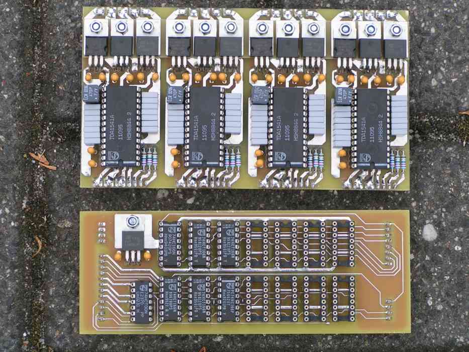

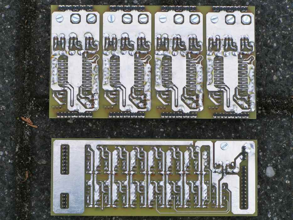

DI-DAC PCB's
Hi poynton,
Thanks for your reply,
In fact somebody has already made the PCB's.... I did 🙂.
Upper PCB is the Quad-DAC module (4 separate DAC circuits), you can use two of these for an octal DAC
Lower PCB is the timing chain, the heart of the D-I DAC. It supports dual, quad and octal DI-DAC's. Well as you can see I ran out of chips...
As I already mentioned in earlier posts I plan to design a number of modules, and then when enoug people are interested, circuit boards can be manufactured. But first I plan to design the other modules, mentioned in my posts.
Hi poynton,
