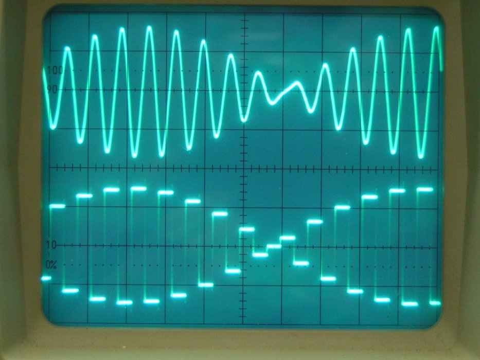

Let's consider how all this developed:
Focus on the 20 kHz sine reproduction.
In the beginning it was realized that rough edges contained harmonics up into several hundreds of kHx and beyoind. It was also realized that these harmonics were not the best thing to be feeding into an amplifier because they excite parasitic resonances and other nasty things... modulations and oscillations.
The cure for this was simple enough... a multiple order, 4 to 8 poles, filter. In order to achieve the greatest stopband attenuation and passband ripple, a chebychev was the natural choice because you could do it with less capacitors ($$).
Now some manufactureres would use Butterworth or Bessel filters, for bragging rights, but these filters required more stages to accomplish the same thing.
And so it went... in the beginning analog filters were cheaper than digital filters. So the war centered on how many stages of Bessel a manufacturer would put in.
Then digital came along and FIR (I believe) filters were employed. This wasn't done to improve the sound... it was done to maintain the same degree of suppresion of the high harmonics at a lower cost.
Then the wars started... how many times could you oversample. Oversampling never did anything for the sound, it just allowed the manufacturers to use less and less analog filtering and save $$. Because it saved them money they decided to charge you more for it... the higher oversampling that is.
Now, to my knowledge, linear interpolation, was never used... at least it shouldn't have been. Especially between fs/4 and fs/2 linear interpolation introduces error... it produces harmonics and modulants that were never in the original signal. This is at its worst approaching fs/2. It may sound thrilling... some sonic "zing" if you will, but it detrimental to recreating the original signal.
You need only run a suimulation, or an actual measurement, on a 20 kHz signal to see what happens. You could even model this in EXCEL, in a spreadsheet.

poobah, thanks for the insightful description.
I have seen the signal shapes (1kHz, 10kHz, 20kHz), both the original waves on computer before burning to CD and at the ouput of the NOS no filter DAC. Apart of the steps instead of lines (the way my generator software Audacity linked the neighbourghing samples), they were almost identical. For sure the 20kHz shape had nothing to do with sine.
So what would you suggest, please? Is there a way to preserve nice-edged squares for originaly square signal and sines for originally sine signal, even for higher frequencies? I am afraid there is no such thing.

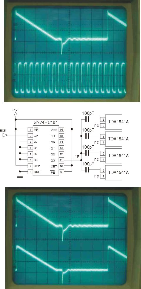

DEM sync schematic & oscillograms
Hi, all
As promised, the DEM sync circuit.
Upper oscillogram:
Upper trace, DEM clock
Lower trace, BCLK
Center: the circuit diagram
Lower oscillogram:
Upper trace, DEM clock DAC1
Lower trace, DEM clock DAC2
From first listening impressions sound seems to have improved 🙂

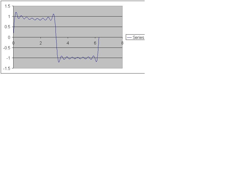

phofman,
A squarewave should NOT reproduce with square corners. Assuming that any frequencies above 20 kHz have been eliminated, it should show ringing on all corners and the frequency of this ringing should be 18 khz...
If you are interested, i can give you the formula for a 1 kHz sqaure wave that you could plot in EXCEL.

phofman,
I screwed-up in an earlier post... your squarewave reproduced should have 19 kHz ringing on the corners! Oops!
I got your drift now...
phofman,
I thought the whole point of Nyquist theorem is that you can reproduce the signal with exactly two samples. Are we ignoring several decades of theory here?

Nice looking oscillographs from Dem reclock Ecdesigns! If all dacs demodulate on exact the same time, the sound problably enhance also.
The logic pcb is kept rather small, good work (the Philips logic is good choice too). It can easy fiddled in a CDP or dac.
